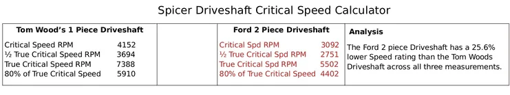

I was hoping Shaun would comment on the calculations TJC did, the critical speed thing is all that's holding me up from adding his driveshaft to the top of the truck wish list.

I suspect that Shaun already knew these numbers, and is playing things very conservative to protect his business. A single law suit could severely damage his business. Ford has deep pockets and a large well trained staff of legal experts.
Even if Shaun doesn't reply, it is clear that the Spicer calculator rates the TW driveshaft superior to the Ford unit. The critical speed calculations show the Ford driveshaft exceeding
  • Critical Speed at 75mph (Driveshaft RPM 3174 vs Critical Speed RPM 3092)
  • 80% True Critical Speed at 105mph (Driveshaft RPM 4373 vs 80% True Critical Speed RPM 4402)
  • Interestingly, if we use True Critical Speed 5502 Driveshaft RPM, the Ford Driveshaft easily exceeds the 120mph top speed +10% criteria at 90.1% of the True Critical Speed. Maybe this is the number Ford used in their calculatiosn?!?. (Pure conjecture)
TW Driveshaft cames in at:
  • Exceeding Critical Speed at 105mph (Driveshaft RPM 4165 vs Critical Speed RPM 4152)
  • At only 84% of True Critical Speed at 120mph (Driveshaft RPM 4990 vs 80% True Critical Speed RPM 5910)
  • if we use True Critical Speed 7388 Driveshaft RPM, the TW Driveshaft easily exceeds the 120mph top speed +10% criteria at only 67.5% of the True Critical Speed.
The bottom two numbers in the chart below are easily calculated using simple math. Double 1/2 True Critical Speed to get True Critical Speed. Multiply True Critical Speed by 0.8 to arrive at 80% of True Critical Speed.
If you doubt my calculations then simply look at the Spicer Calculator Results on the driveshaft speeds. You can validate them yourself by entering in a few data points. I urge you not to take my word for it. Run the numbers yourself.
Spicer Driveshaft Critical Speed Calculator Link
The parameters entered into the calculator are as follows
  • TW - 60" Single Piece Draftshaft 1350 U-Joints 4" tube diameter Type A
  • Ford - 60" 2 Piece Driveshaft 1330 U-Joints 3" tube Diameter Type B
    (front shaft is 2.5", rear shaft is 3.5")
Once you get the results you are left several decisions. Do you:
  1. Trust Ford Engineering to have delivered a safe factory driveshaft
  2. If you trust Ford, then you must trust Spicer as the manufacturer of the Ford Driveshafts
  3. Trust the Spicer Calculator to be able to discern (on a relative level) differences in performance of different driveshaft configurations.
I choose to trust all 3 statements.
But to each his own.
- T
I rushed this as I was preparing dinner... errors and typos may be present. Will recheck after dinner.

After running all the math myself, I'm confident that the single piece is safe easily to 120mph as @TJC has shown. No way in hell I'm going that fast and anyone not tuned CANT go that fast.
The video I posted that MAY be up to 105mph had 0 vibration and 0 signs of instability in the driveline even with the uneven roads. At those speeds you're doing silly things. With my tire size I would be at 1/2 critical speed right around 80mph. I've cruised at every speed around that and have yet to get any hint of instability or vibration.
