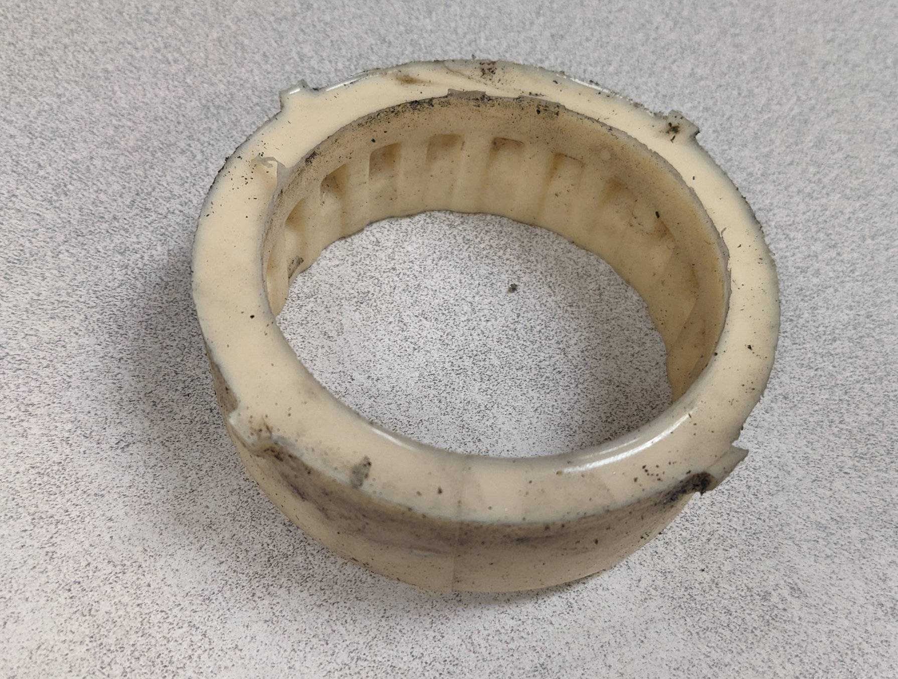

Update on the bushing. I made a bushing yesterday. Cast in out of urethane directly in the stock drive shaft. Turned out well. I then tried to use that bushing to make a negative mold out of more urethane. Unsurprisingly that didn't turn out well. Despite my use of a release agent it turned into basically one solid block of urethane. I was able to excavate the bushing but not without destroying the mold. I might try making a new mold out of plaster or something. I sure as heck don't want to make a bunch of these by balancing a wobbly 65" long drive shaft on end and pouring urethane into it. But I'll probably stop at 1 or 2 of these and get back to doing what I know and what I know works well in this application, drive shafts. For me, the reasons I'm experimenting with making urethane bushings are: I'm a generally inquisitive person who likes learning/trying new things and I enjoy making things, all things. I want be able to say/show, with a deep level of truth, that I've explored other options and left no stone unturned, and that I'm not jumping straight to the solution that seems to make us the most money, it's not all about selling drive shafts. Lastly, some of you speculated about a stiffer bushing. I am a man of action, I wanted to bring the speculation and the thought experiments into reality, test the hypothesis. We'll see what the results are.
I'm going to box and send a bushing to @NotBudule today. He'll test it out and report back to the group. A pic of the bushing is below. It is durable urethane, I surprisingly did not tear it while trying to pull it out of the urethane mold mess. It is about the softness of a gummy candy, like gummy bears or gummy worms, on the stiffer side though.

It's almost as though I've known what I'm doing all along. :sunglasses:
I was going to comment about stiff gummy worms but I won’t
