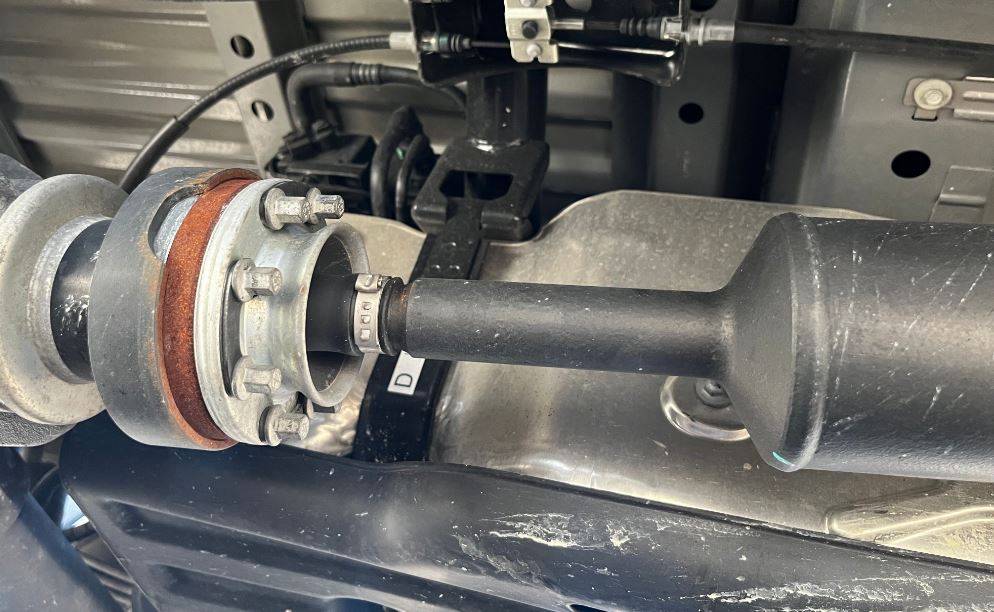

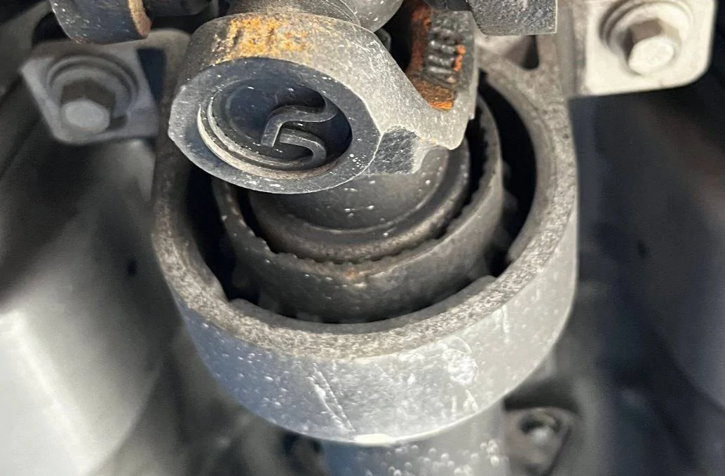

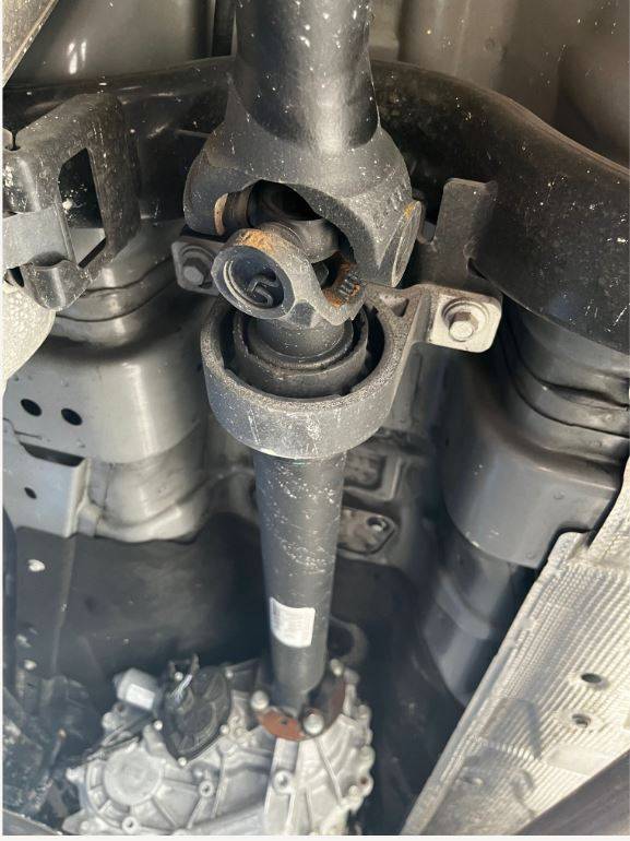

Just for kicks, I crawled under my ranger and took at look at the Tremor setup. The CV end looks really strange with how small the tube tapers down. I wonder how the online calculator @Shawn at Tom Wood's shared would work this?
I also grabbed hold of the shaft and it had a unbelievable amount of play in that floating bracket thing. I was actually shocked how much it moved in any given direction.

Yours is centered much better than mine ,
mine rides low and to the left , maybe I should drop the bracket until it's centered up...

You know something, you might have just found the best solution for Tremor owners. Best by default as it may be the only solution because as mentioned before we haven't yet been able to figure out a 1-piece shaft for the Tremor. I'll pour another bushing tonight. DM me your name and address and I'll send one to you.
@NotBudule Too soft, interesting. That urethane I used was the softest available. I wonder if harder might be better? If it does need to be softer, I agree that holes would be the way to do it. It would be cool if we had a gopro video so we could see how much deflection you have with each of the things you are trying.
Holy crap that is way better centered than my Tremor. Why so much difference between two exact same trucks? Something isn’t right
Yours is WILD looking for a 2022 with what I assume like no mileage. I am only at 12k miles.
