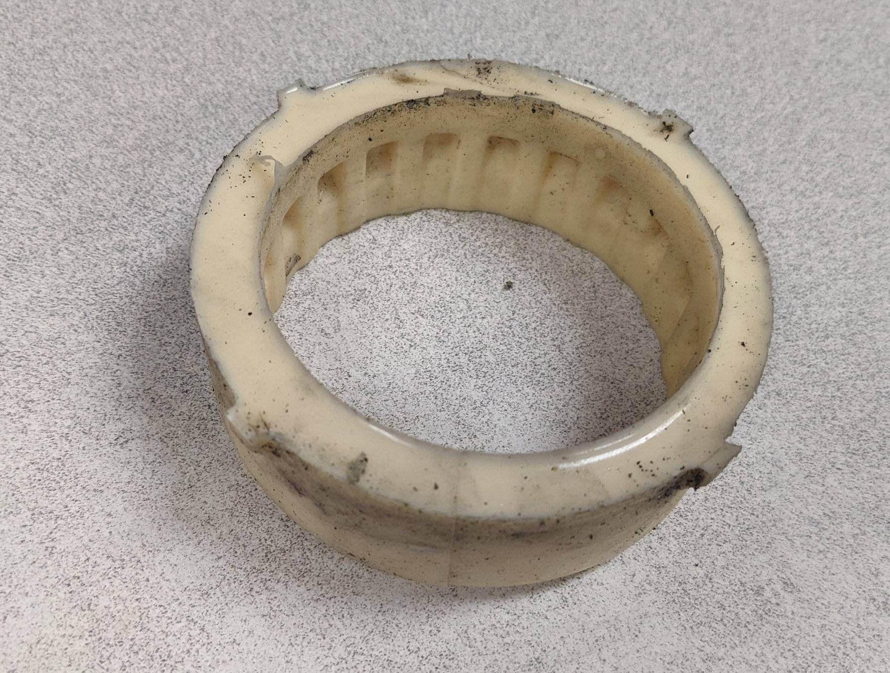

Update on the bushing. I made a bushing yesterday. Cast in out of urethane directly in the stock drive shaft. Turned out well. I then tried to use that bushing to make a negative mold out of more urethane. Unsurprisingly that didn't turn out well. Despite my use of a release agent it turned into basically one solid block of urethane. I was able to excavate the bushing but not without destroying the mold. I might try making a new mold out of plaster or something. I sure as heck don't want to make a bunch of these by balancing a wobbly 65" long drive shaft on end and pouring urethane into it. But I'll probably stop at 1 or 2 of these and get back to doing what I know and what I know works well in this application, drive shafts. For me, the reasons I'm experimenting with making urethane bushings are: I'm a generally inquisitive person who likes learning/trying new things and I enjoy making things, all things. I want be able to say/show, with a deep level of truth, that I've explored other options and left no stone unturned, and that I'm not jumping straight to the solution that seems to make us the most money, it's not all about selling drive shafts. Lastly, some of you speculated about a stiffer bushing. I am a man of action, I wanted to bring the speculation and the thought experiments into reality, test the hypothesis. We'll see what the results are.
I'm going to box and send a bushing to @NotBudule today. He'll test it out and report back to the group. A pic of the bushing is below. It is durable urethane, I surprisingly did not tear it while trying to pull it out of the urethane mold mess. It is about the softness of a gummy candy, like gummy bears or gummy worms, on the stiffer side though.

You could try making a mold with silicone casting like this:
Amazon.com: Mold Star 30 - 1A:1B Mix by Volume Platinum Silicone Rubber - Pint Unit : Arts, Crafts & Sewing
If you make more, I'll buy one to try out. if it works cool, it's a risk I'll take if it doesn't.

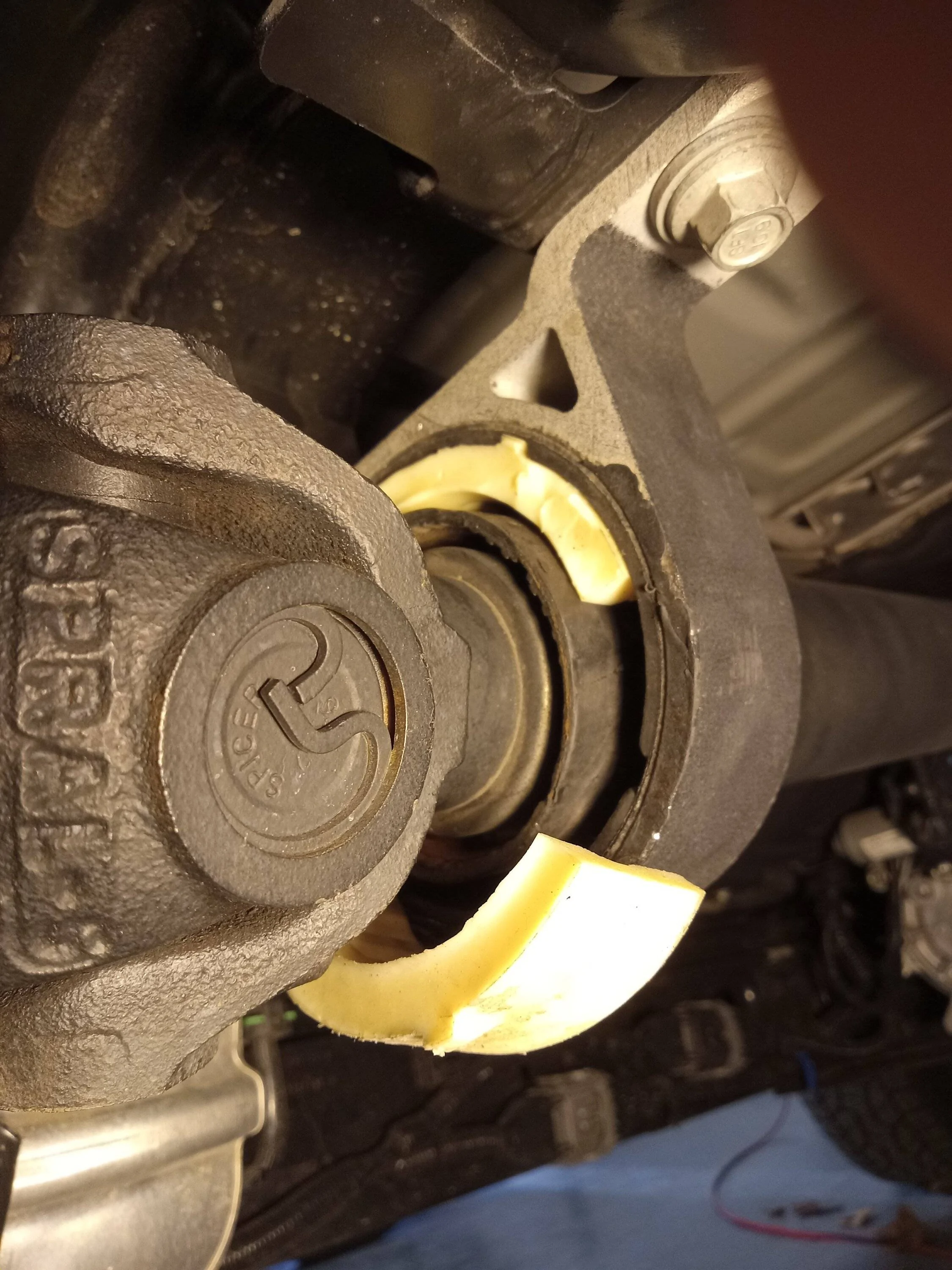

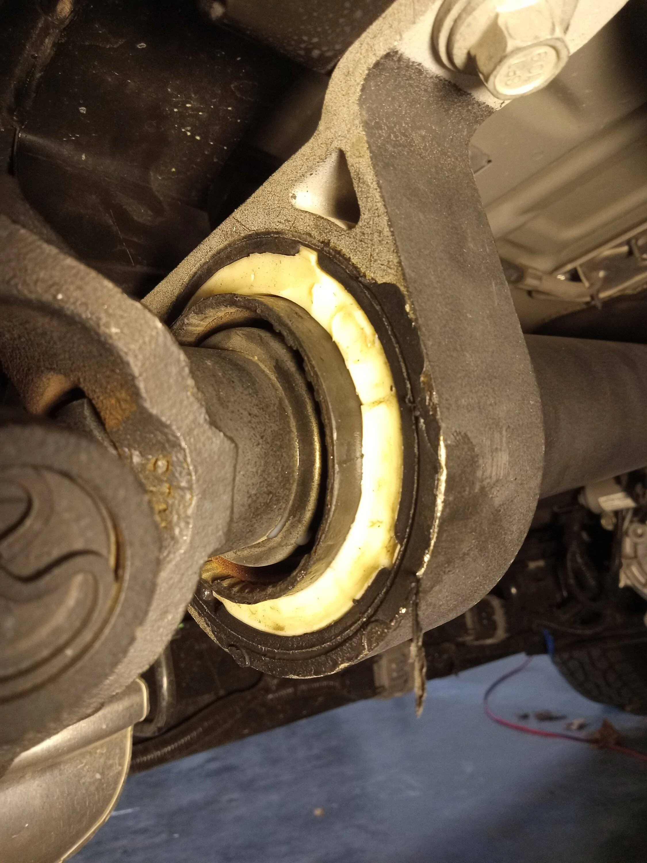

@Shawn at Tom Wood's
had to lube it but went in pretty good , took all the loose play out but I can move it a little with effort, pretty much what I was thinking and wanting , was going to maybe put a zip tie around it for a temporary retainer to hold it in while I go on a spirited test run , somebody hold my beer ...

The damn dog had to go and messed up my butt dyno a little , its good when i get on it for sure , and felt good at 70 + , but i think i feel something on deceleration , it may be a little too stiff , i have to go back and forth to work to really get a good feel for it though ...

Is your slip joint at the other end of this greased?
