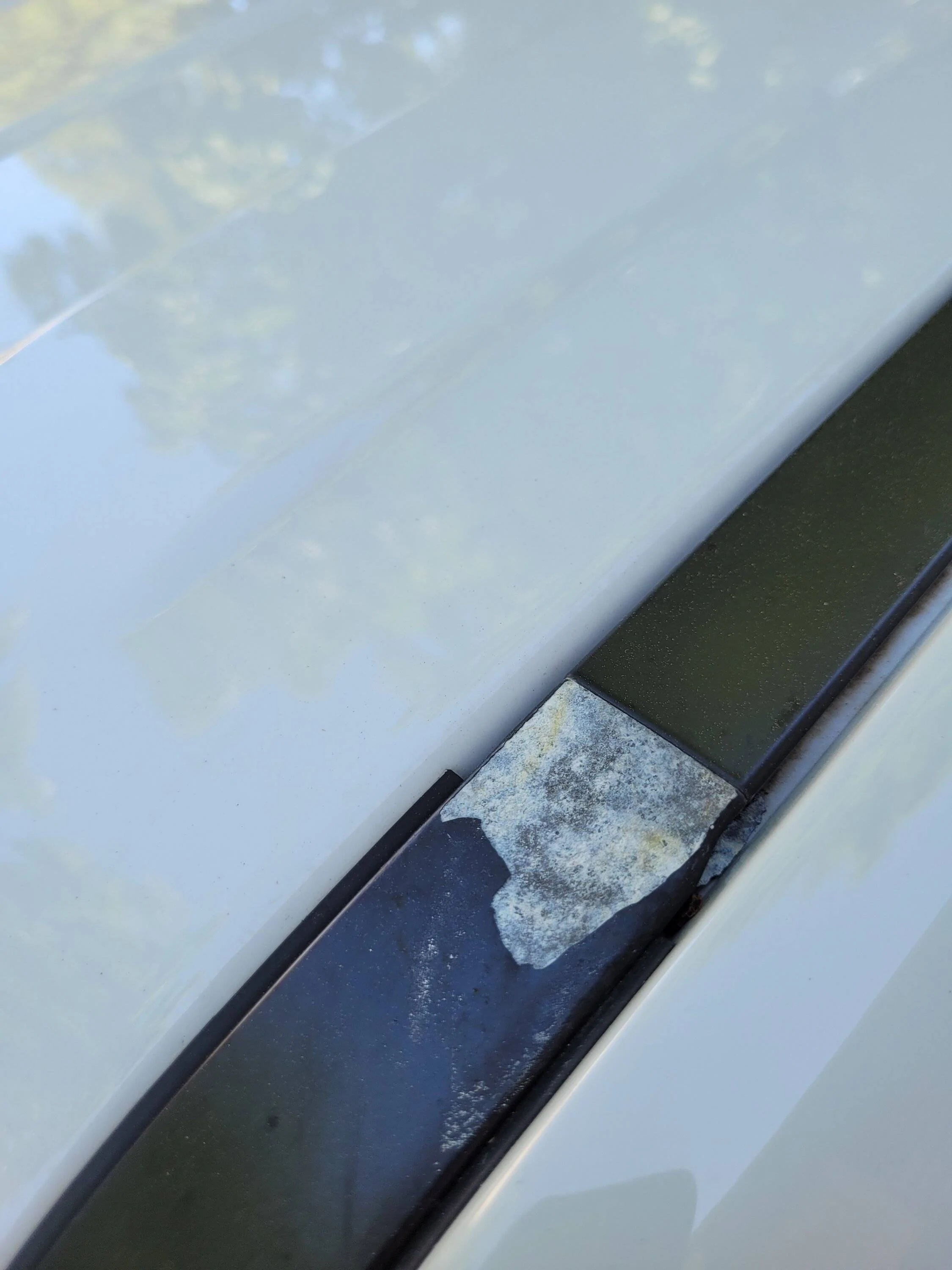

Not even 3 years yet (2 weeks till) already found rust

Really? I was wondering how they replaced them. I am going to a Ford dealership Thursday that has a service and collision department. When I called the office lady didn't seem to know where to book me for "rust" on the roof rail/trim). She seemed to just book me with the service folks, will update how it goes.
Yes, I believe you access the screws that hold those trim pieces in place from the inside.

These trim pieces on the Ranger are pretty easy to remove. Top door trim pieces are held by clips, then get under the edge of the headliner and the four bolts are easily reached. Less than 20 minutes for all 4. The exterior trim piece has 2 sided tape between the screws, so very light pressure to lift them off to avoid bending them.

Given where that’s located I would be tempted to sand it, tape it off and hit it with a shot of rustoleum. No one would ever know.

I think these are heat wrapped. If base metal is dirty it will blister over time. I’m sure Ford doesn’t make these so if a problem arose they would push back on the vendor. Find root cause and move on. So many of us don’t see issues. But, on the off chance we break that wraps seal we could then be open for issues down the road.
If it ever did turn into a problem for me I would remove them, strip off wrap and powder coat after a good prep. That’a more than the factory would do and it would last.

I'm honestly shocked. I haven't even had the truck for 3 years and I'm already developing rust in one of the black bands (anyone know what they are called?) at the top of the truck.
3 year bumper to bumper literally expires in 2 weeks.
Image attached.
They have replaced 3 of these on mine . Mine were the front caps. They seem to last about a year before the aluminum corrodes they just replaced the second left front one last week. My ranger is a ‘19 and live in SoCal

I thought those bands were plastic?

Metal/alloy coated with some type of plastickey substance sourced from "Area 51" from an alien craft...aliens way of getting back at us...THEY knew it was a crap coating !!!

Mine got replaced a little more than a year ago. I think corrosion/rust (there's more than steel on these) warranty is five years.
