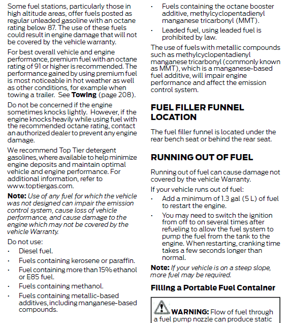

You are almost certainly correct, and I am aware of the reduced octane requirement at altitude, but that isn’t in the owner’s manual. Does 85 satisfy the warranty conditions, or are you giving Ford an opportunity to weasel out of their obligations? Gas is cheap; engines are expensive.
Can't say I disagree there. Which is why I wouldn't do it on the regular. Still, I wouldn't be concerned at all about a half tank of 85 mixed with a half tank of 87.
If I were, I'd drive gingerly for a half a tank, then top it off with 91 and call it good.
