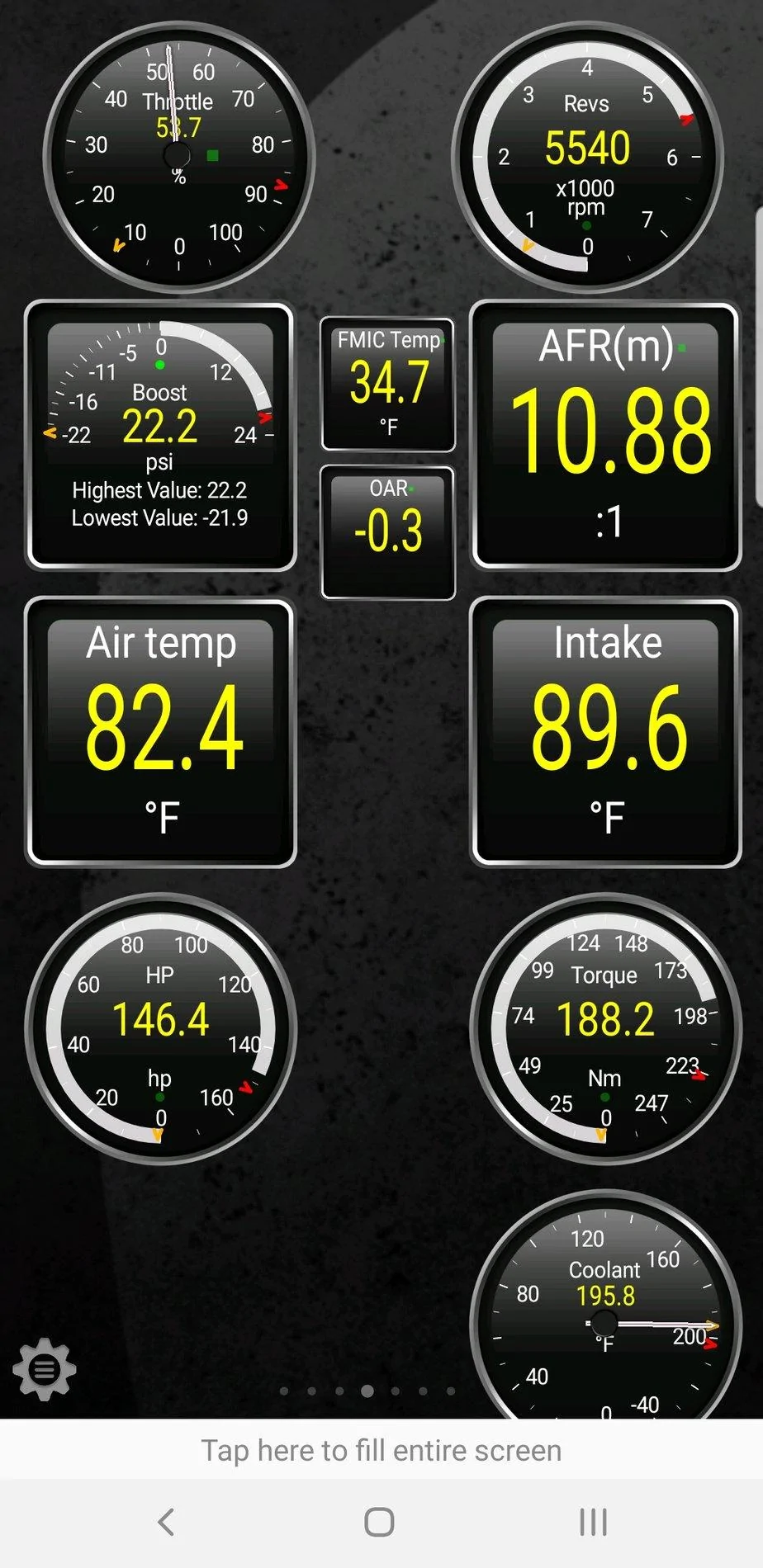

To be honest, anyone who has had a Cobb AccessPort knows the Octane Adjustment Ratio (OAR) should read -1.00. on a scale of -1.00 to 1.00 the closer to -1.00 the better. The Ranger is currently -.3 so there is room for improvement for sure with the engine management software to adjust power to higher octane fuel. I may try a tank of 93 to watch the OAR move but I won't be dyno-ing the truck to prove results.
