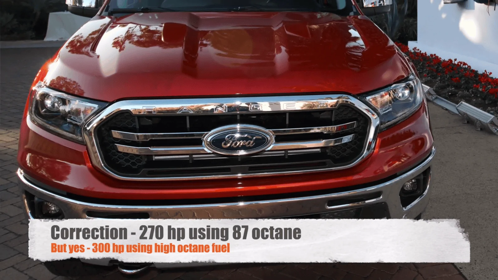

Everybody should watch Doc’s video in post #91. Best explanation of premium vs. regular fuel. It all comes down to this — an engine under load (high temps or towing like the manual says) may experience pre-ignition where the fuel mixture explodes prior to the spark plug firing. This causes a knocking sound (hence the name) and can, over time, result in engine damage.
To protect the engine most modern vehicles have a knock sensor which reduces the knock by retarding ignition timing. Doing so protects the engine but, my firing the plugs later, reduces engine power and, sometimes, mileage.
So, bottom line, just like the manual says, under load, use premium. Otherwise, no need to make the oil companies richer, use regualr.
