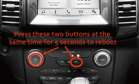

I've had this happen recently. Try the reset method.
https://www.ranger5g.com/forum/threads/sync-not-working.26354/
Anthony said:
Happened to me this morning. My entire SYNC interface froze up and would not respond. Even shutting off the truck and restarting did not help.
The only way to get it working again is to "reboot" it or soft reset it. (don't do a master reset or it will erase all your presets / phones / contacts, etc.)
Press the Volume / Power knob and the "next track" button at the same time for 5 seconds. The SYNC unit will power down and restart. That's it!
i tried that as well and tried to discount the battery and fuses and still nothing unfortunately. Thank you
Ignition on? Or engine running?
Don't need this but it looks like one of those bits of knowledge that I need to file away just in case.
Engine running.
I did this driving to work yesterday. Seems that I do this quarterly.

My SYNC is so confused, I just did the soft reset, then the radio screen just stayed on afterward, keys in hand, out of the truck, door closed, it still had the screen on, did the reset again and it returned to normal, shutting down with the Ford logo.
Tried to do an update and it wouldn't, the icon just kept swirling.
But now the unit is working correctly, it used to on start up and be on NAVI, then go to AM radio when you hit audio, but now it's back to normal for the time being.
Thanks for posting up the soft reset procedure.?
