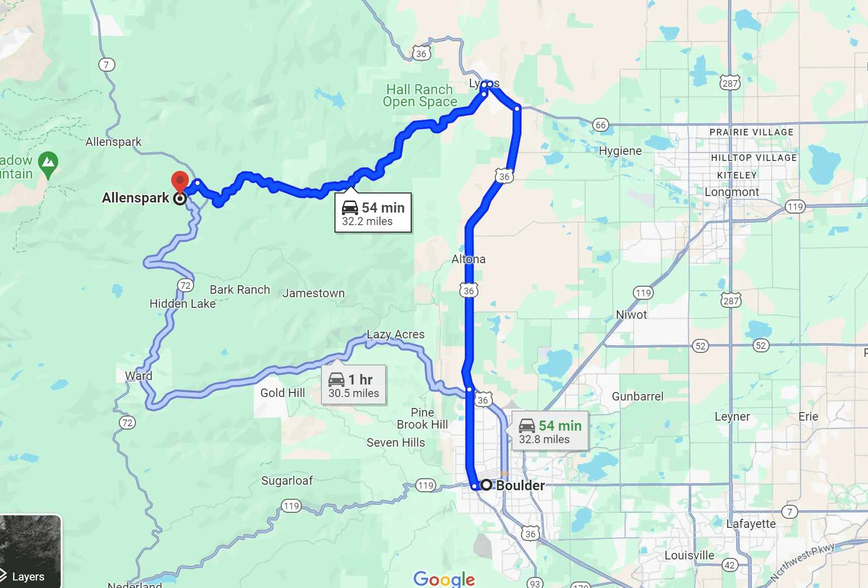

When it was confused, why didn't they turn it off and back on or disconnect the battery and turn it back on . . . A reset of sorts for the computer and sensors. that wouldn't have fixed whatever went pop/crack/bang, but it could have "fixed" the computer. Driving from where they were back to boulder in 4L would have been painful, they would have had to bring the trailer out. . .
If that is how the transfer case works (which I have no reason to doubt) and if I remember correctly that is how my taco was with the lever on the floor - I had to shift into 4H, pause, shift into 4L, shift into gear and move. Did you catch the part where they were saying, if you are in 4L, you have to go into 4H and than 2H. (and the opposite to engage 4L) that seems a silly set of steps - isn't the computer smart enough to go ohh wait, they want 4L, I have to go into 4H first, and than 4L? if it is not, that seems like a point for improvement in software updates. . . for crying out loud, they are buttons that are pushed not levers anymore.

~30 miles of on road driving in 4L would be so miserable. lol
