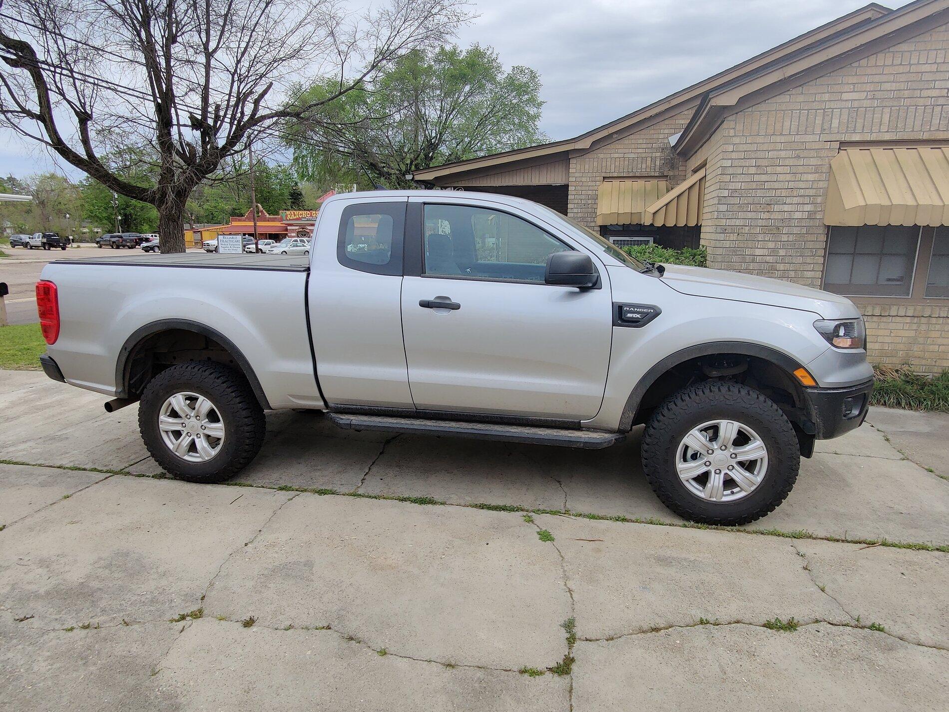

Just installed these yesterday without the add a leaf on my 2020 FX4. I already have Bilstein 5100's front and rear so can't compare it to stock. The coil overs are @ the 1.8" setting with the addition of a 1/4" spacer which gave me almost 3" of lift in the front and the truck was completely level. These springs gave more lift than advertised in the rear about 1.5" hopefully they will settle in a little bit.
The Bilstein's pretty much took care of all of my issues with the absolutely horrid way these trucks ride stock but I still felt the truck was over sprung in the rear. Potholes and rough roads were still a bit jarring but the under damped floaty/boaty ride characteristics were gone. I was ready to skip rear springs altogether but hey gotta waste my stimulus money on something.
I rarely have any payload and only haul a small teardrop camper a few times a year so I wanted the suspension tuned to ride well empty. These springs do accomplish that. Ride is equivalent to the stock springs on smooth pavement but potholes, expansion joints, washboard, and rough dirt roads are more controlled/pleasant and less jarring. Its a subtle difference and probably not worth the $ to most. I'm happy with the ride improvement but not thrilled with the unexpected extra ride height.

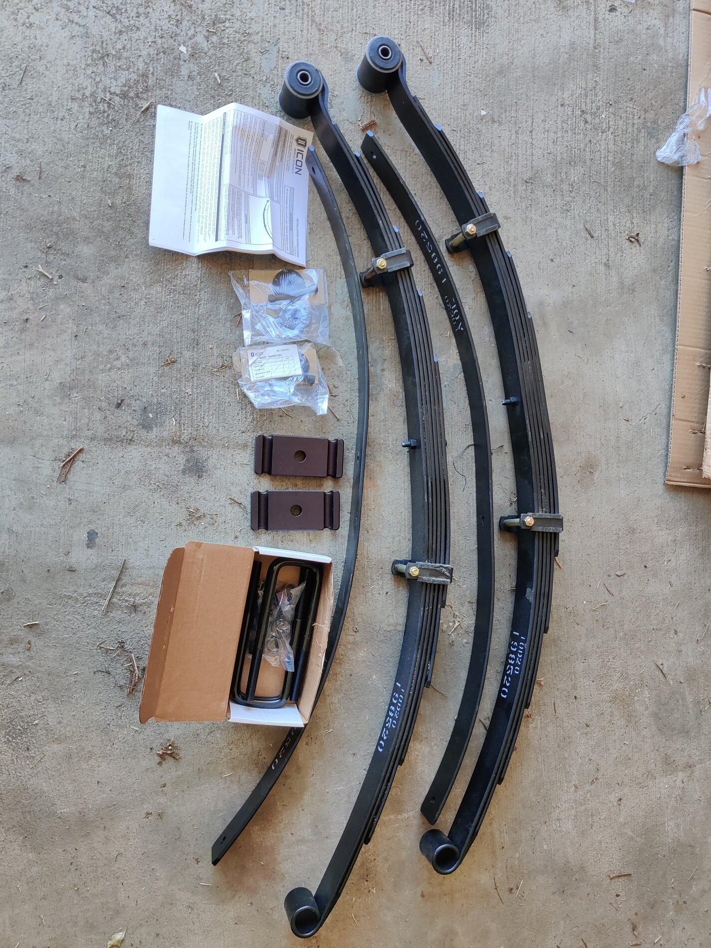

Here is what you get with the springs and hardware kit:
the leaves come with the add a leaves, a longer center pin and an extra set of plastic leaf isolators. The hardware kit is 4 U-bolts, Nuts, washers, and bump plates/U-bolt retainers. You reuse your bushings on the shackle end.
The U-bolt kit is universal so they are too long for the springs without the add a leaves and will need to be trimmed. The hardware kit is also a bit overpriced. I'd also like to see Icon offer these without the add a leaf.
Here's how she sits:
