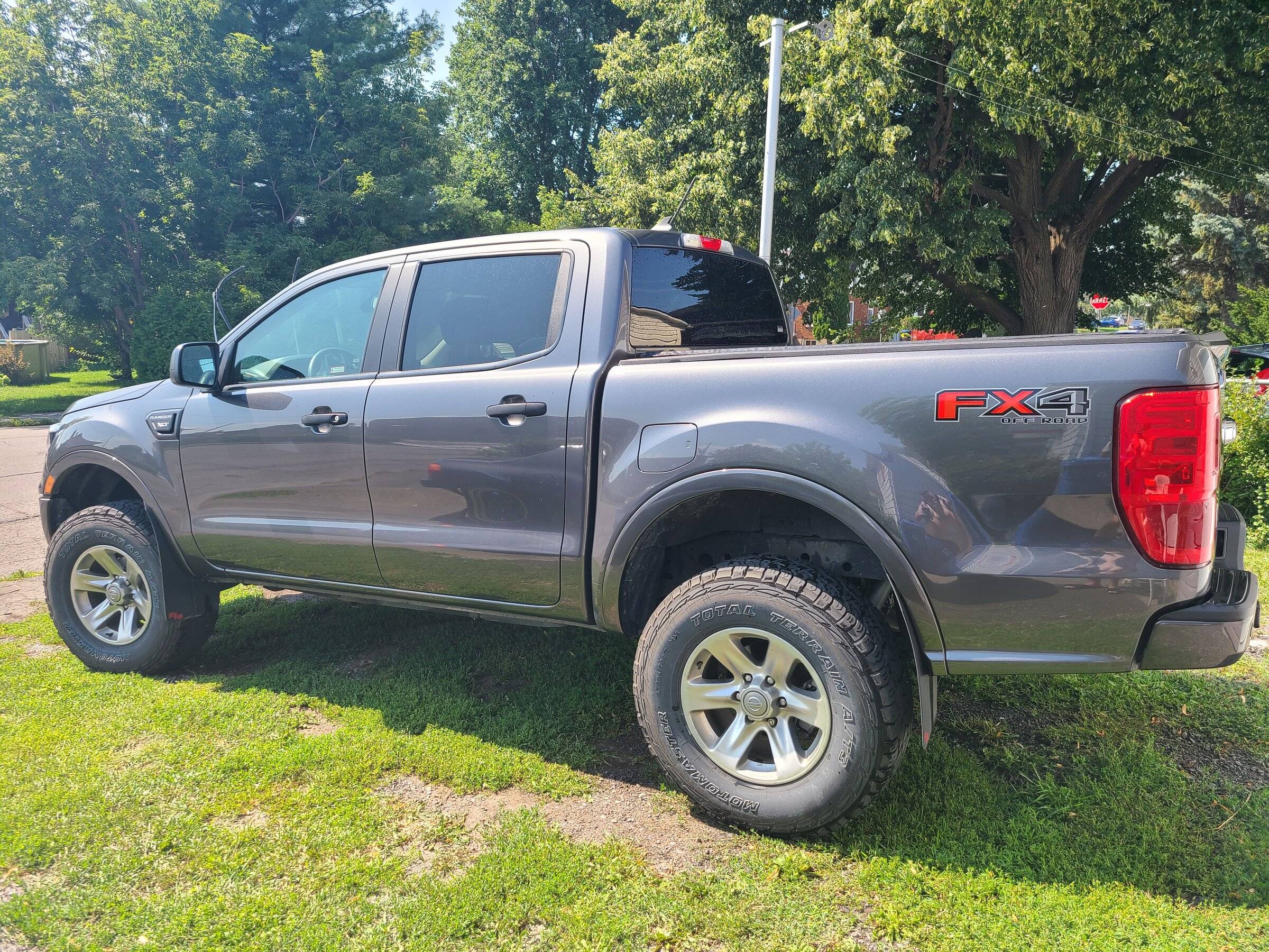

Ford Ranger FX4 2020 / Ford Galaxie 1968
Peace officer
For the eibach i went with the 3 inch. And on the back I add the bds shackles leafspring for 1 inch... so the back is a little bit higher (285/70R17)
