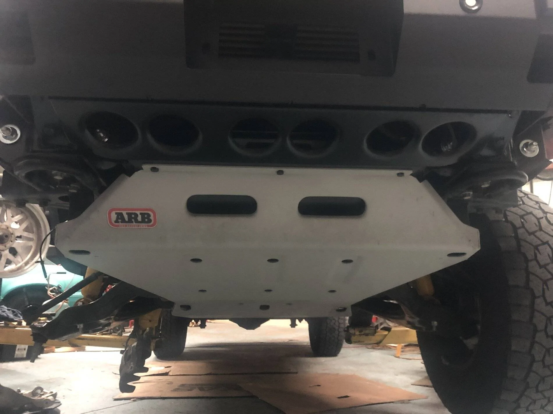

Can you post a picture of how the interface to the ARB bumper looks?

I apologize. I mean where the ARB front skid plate mates to the ARB bumper.

It is the ARB plate mated to the ARB bumper.
