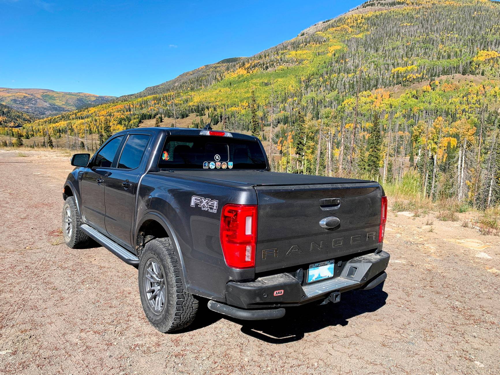

I went from stock wheels (55mm offset) to a set of KMC's with a 18mm offset, a set of Mickey Thompson A/T's 265/70/17 and they have just the right amount of poke. Personally, I wouldn't go my then about 20mm offset. My wheels are 26 lbs so I spent a lot of time trying to find light wheels and tires.

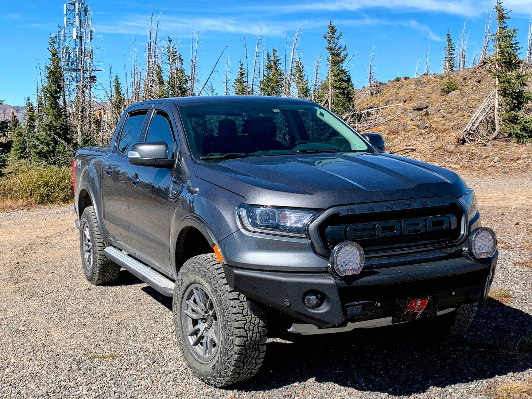

These are +25 Icon Vector 6s on 265/70/17, so a little narrower than what you're running, if this helps.

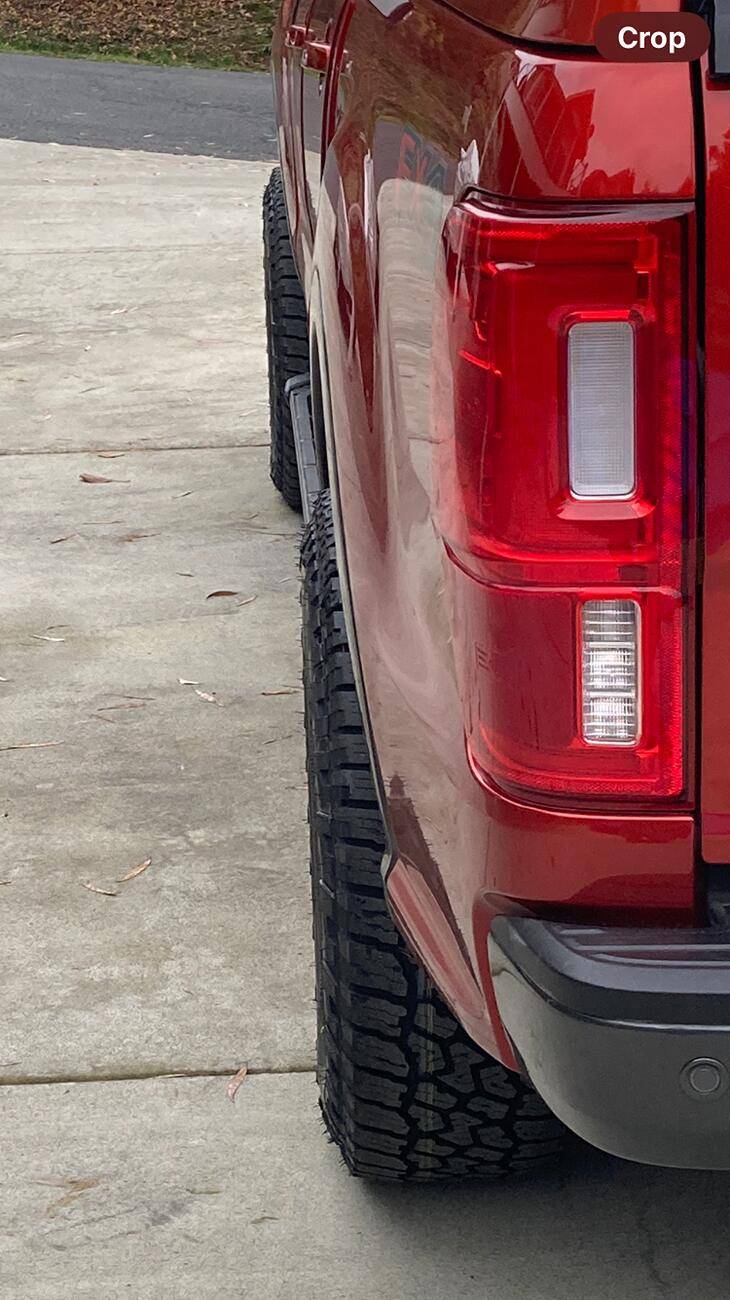

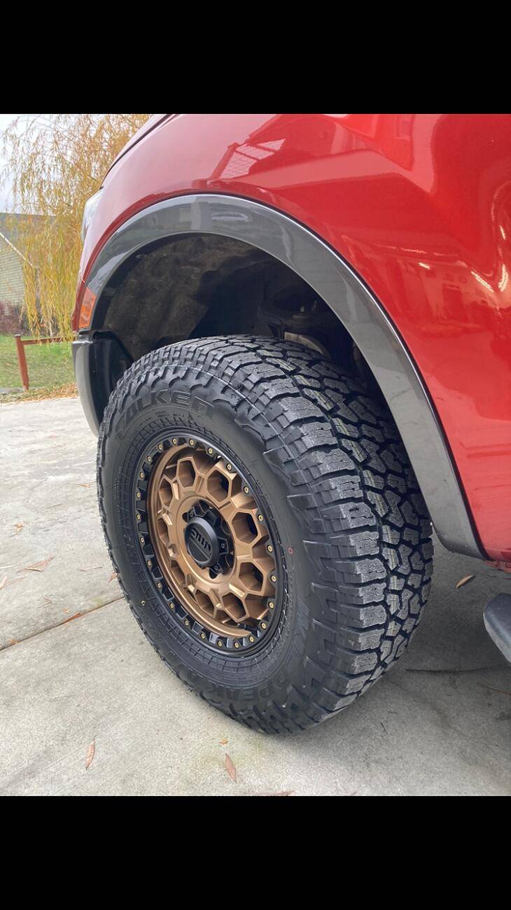

These KMC Trek wheels are 17 x 8 with +20mm offset with 265/70-17 tires, FP level kit and ReadyLift Anti-Intrusion bars installed. Tires rubbed on rear bars at 3/4 of full turn with some suspension compression. Tires moved outward by 1-3/8”. I installed RokBlokz XL mud flaps and they do a good job keeping the junk off the sides of the truck.
