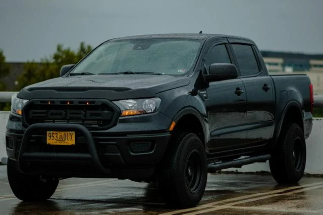

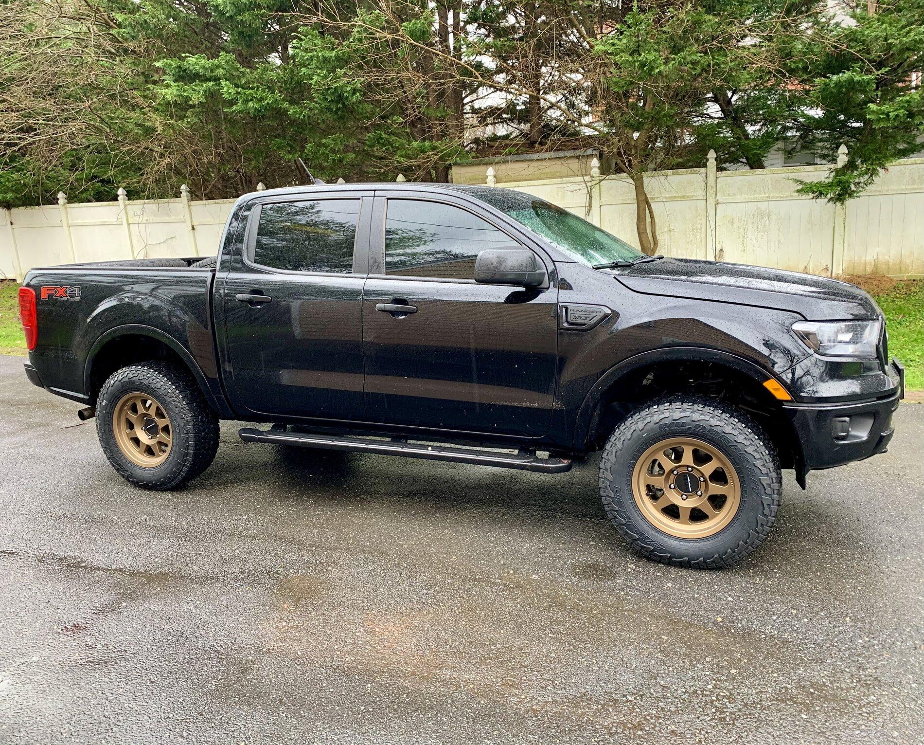

Best 18” setup I’ve seen - looks like bars are intact too. Nice!
@Fawnbuster - this appears to be in that sweetspot (32” tire, slight poke with modest positive offset of +18mm, 18” wheels)
Crash bars intact and no trimming? Your truck looks like a beast!

Thanks.
Bars are in place but very close to rubbing but only at full lock.
Fine for city streets but maybe not off-road. I’m in that sweet spot but with a 17” wheel - 32” tire, +15mm offset.

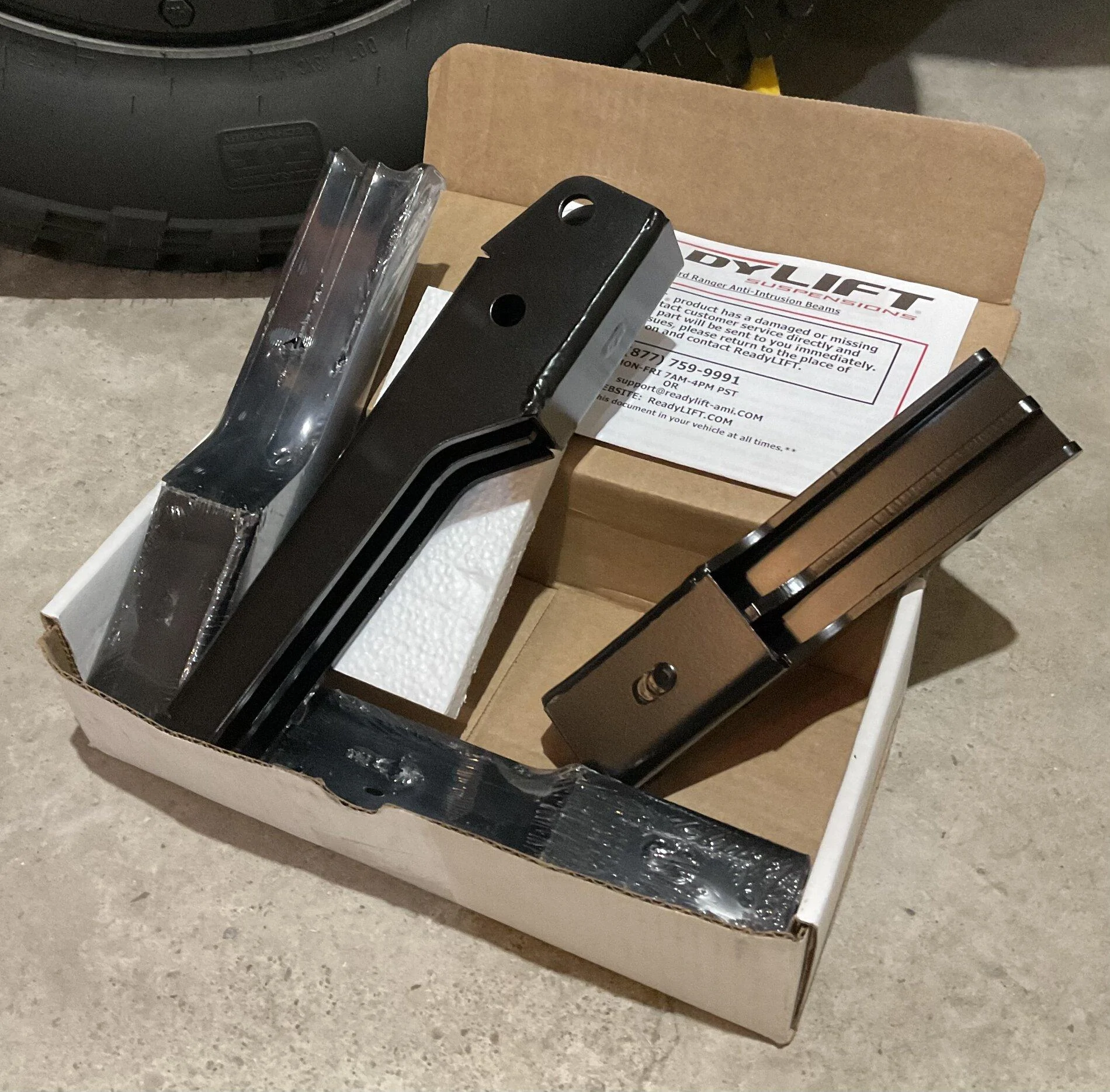

I have 1/2” clearance on fronts, less on rears - received ReadyLIFT Anti-Intrusion Beams over the weekend- will install them soon. I could get away without changing the fronts but I like doing the work.

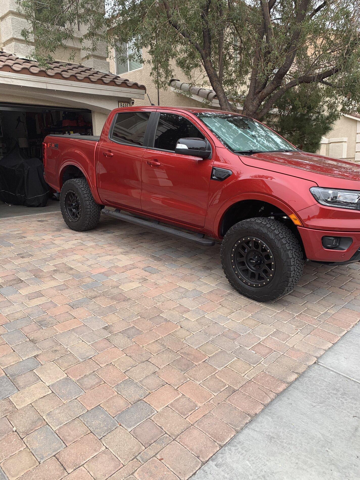

I went with 0 offset and 33x11.5, came out exactly how I wanted but trimming the crash bars was necessary.
Ps front is turned that’s why it looks like it’s poking a lot lol.

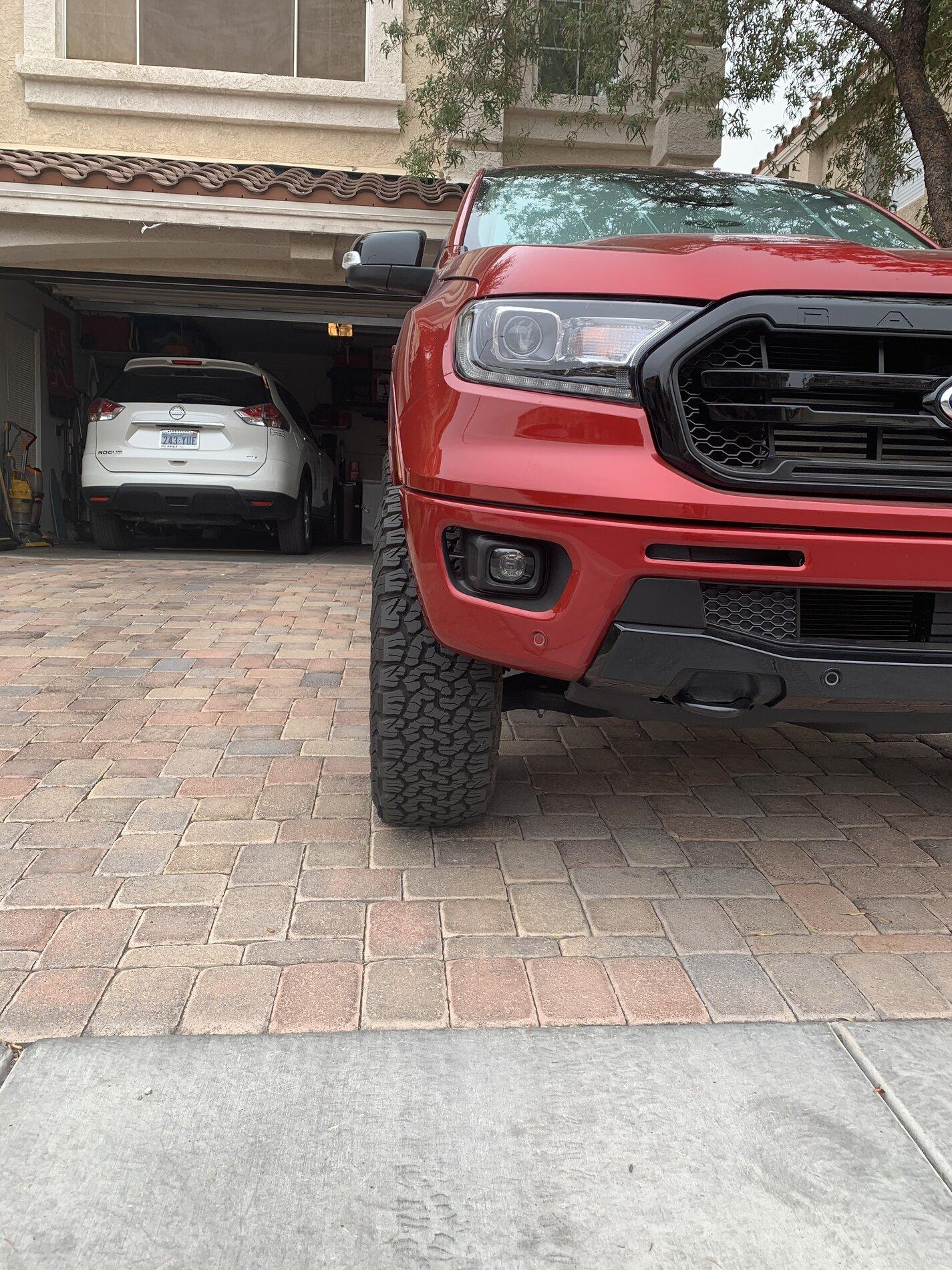

I just had the very front ones removed when I had the lift done. I then installed the BDS after market ones. I think I am going to switch them to the Readylift ones though. They look a lot sturdier than the ones I have now.
Link to reafylift bars?

-12 offset might be a bit too much (in my opinion). I have 0 offset wheels with 265/70/17 Falken Wildpeak A/T3W times.
Note that even with 265/70/17 tires, they will still rub the crash bars at full lock slightly with that aggressive of a negative offset. My current wheel/tire setup rubs my crash bars ever so slightly. Not sure if you wanted to remove your crash bars or not so thought I would mention it.
very nice wheel tire combo what wheels are they and size and offset?
