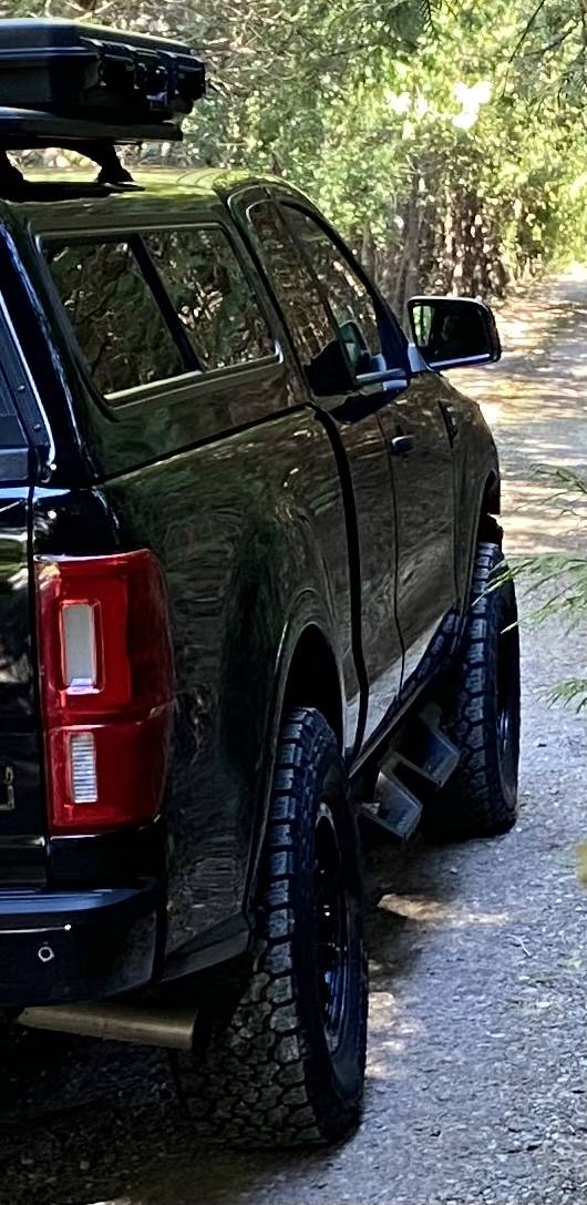

Depends if they’re talking about tread or sidewall.

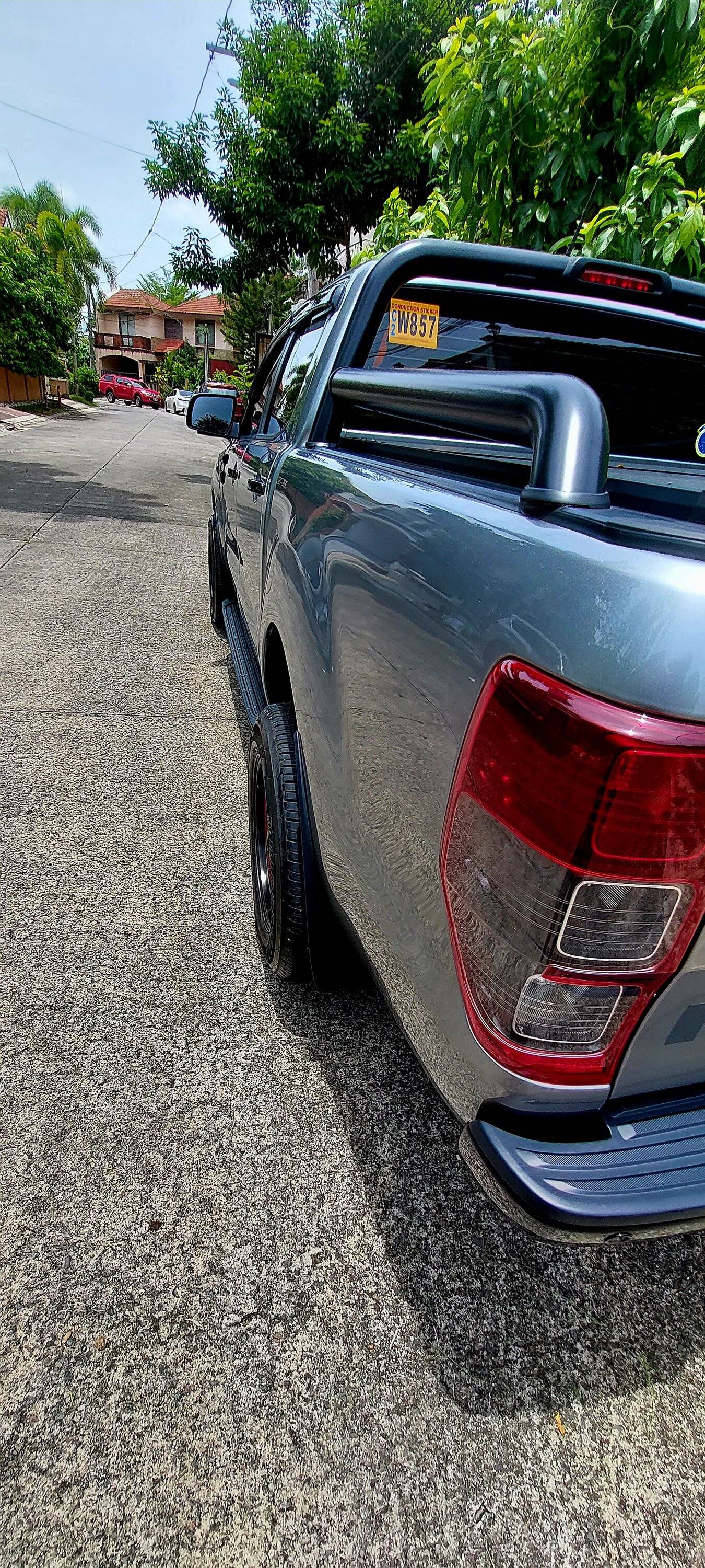

Here’s what +15mm looks like. +20mm will likely put the tread flush to the wheel well. Then, that depends on the tire manufacturer, tire rating, tread width, blah, blah, blah.

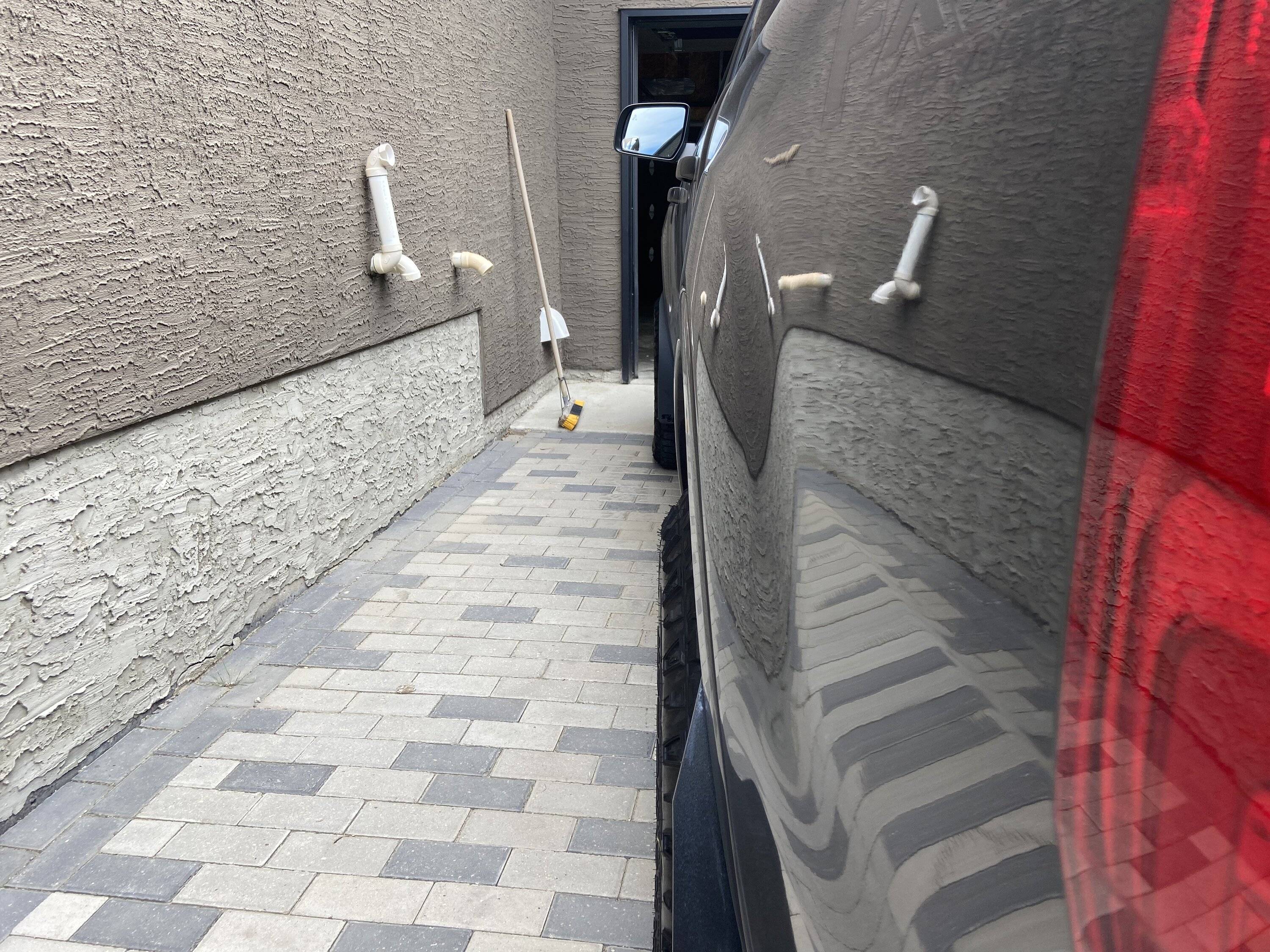

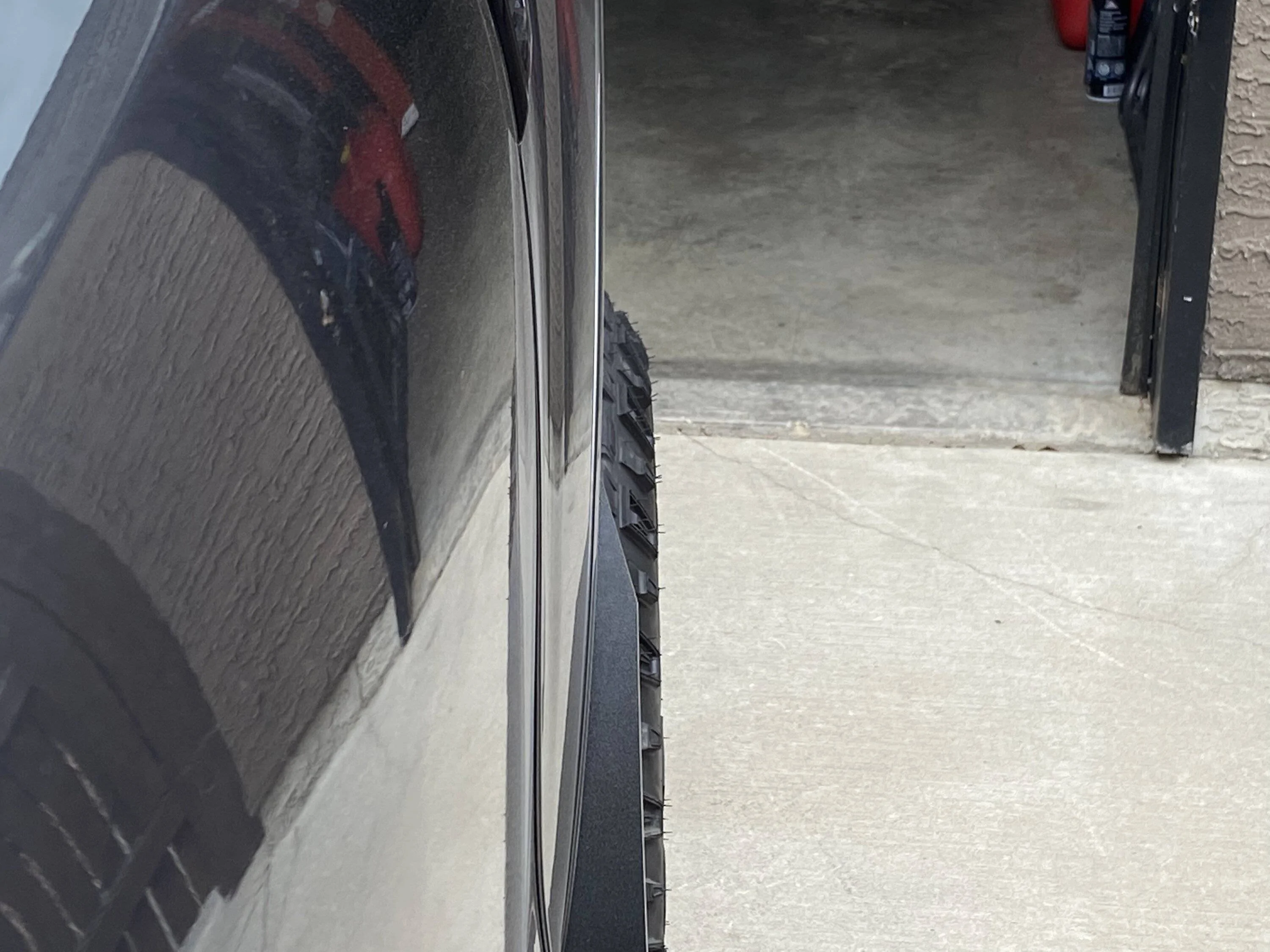

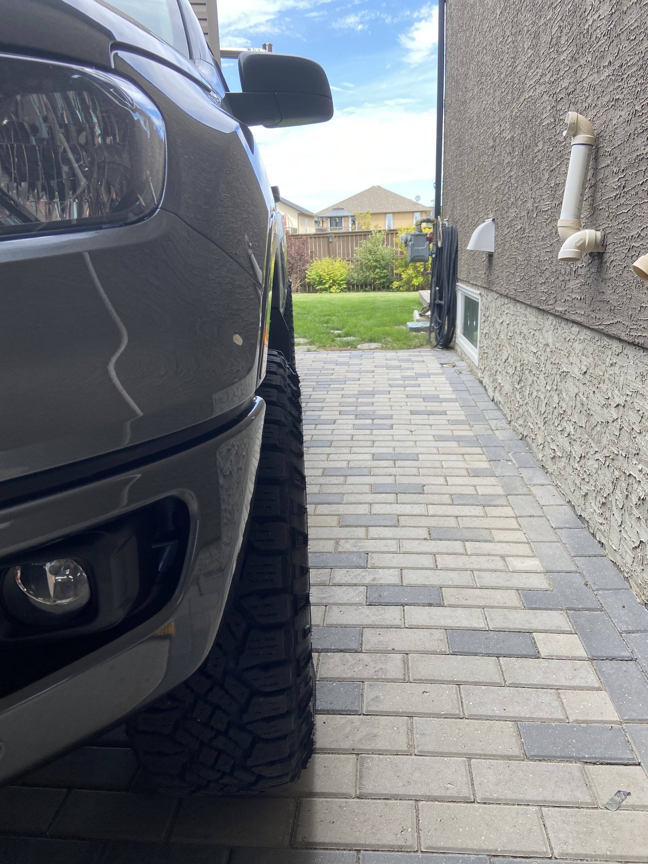

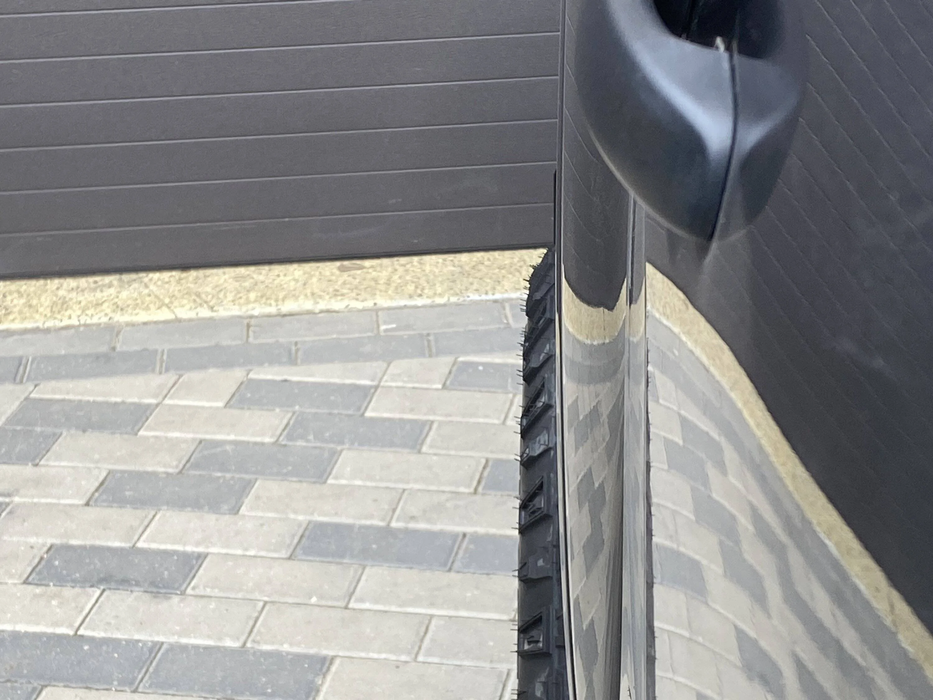

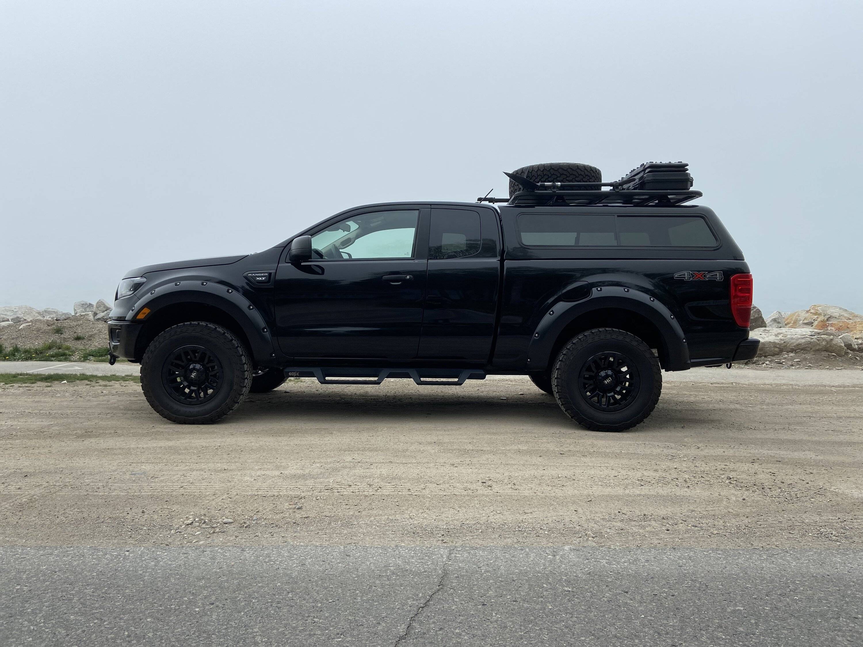

This is probably the most accurate representation I can give. These are fuel Rush 18x9” with a +20 offset. Tires are a 275/65r18
I’m planning to add the tremor fender flares at some point but my splash guards are the rockblokz XL and do a good job or protecting the paint. I ended up removing the front crash bars and the front air shields to stop the rubbing at full lock.

I’ve measured from the sidewall to the side of the factory fender molding and they stick out approx 1/2” so the tremor fender flares would put them perfectly flush. You with stock tires wouldn’t poke quite as bad as with my tires though.

This is exactly what look I'm shooting for. Like you said it would be flush with my "flares" thanks for posting these pics. I'm a little surprised you had rubbing with 275/65r18. I was thinking of going with 265/70/18 and I hoped there wouldn't be any rubbing. do you have a leveling kit on yours?

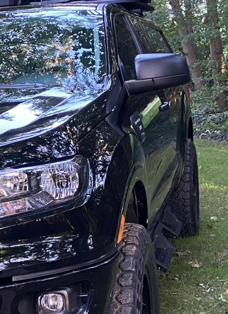

Yeah, at 32.2” (275/70R17) and my 2-1/2” level, I was very, very close to rubbing the crash bars - with +20mm, you would likely be safe but the wheel well gap you’re not fond of is still there - you could consider 275/65R18 (32.1”).

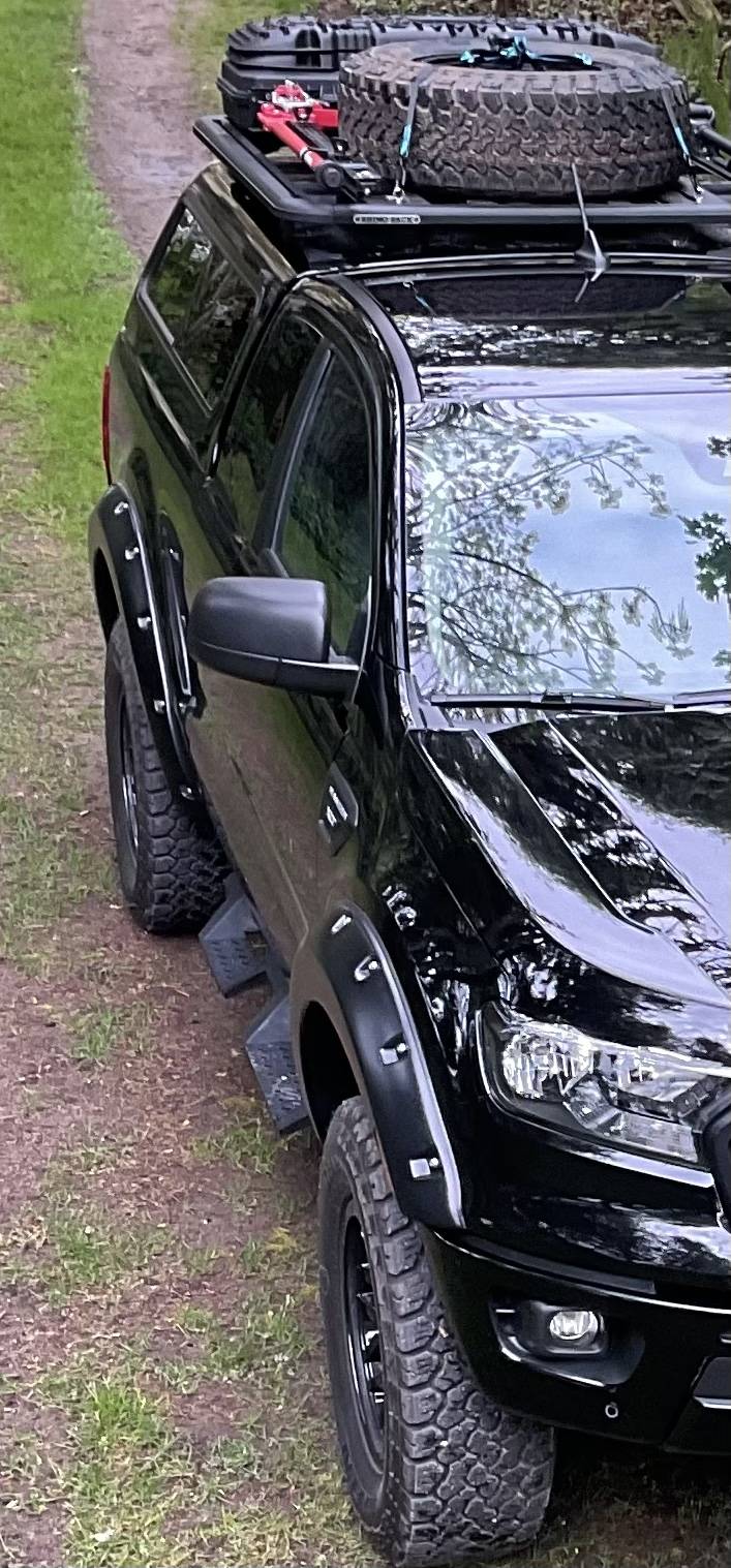

To fill them up with 33’s or bigger, is going to require a lot more mods - likely need to go to 3” lift and crash bar replacement to stuff them in there. Here’s the gap on 32s…
OFC Ranger squeezed 33s into his - looks pretty sharp but he does have a 3” lift.
Unfortunately, there’s not magic chart or spreadsheet for this exercise. ?
