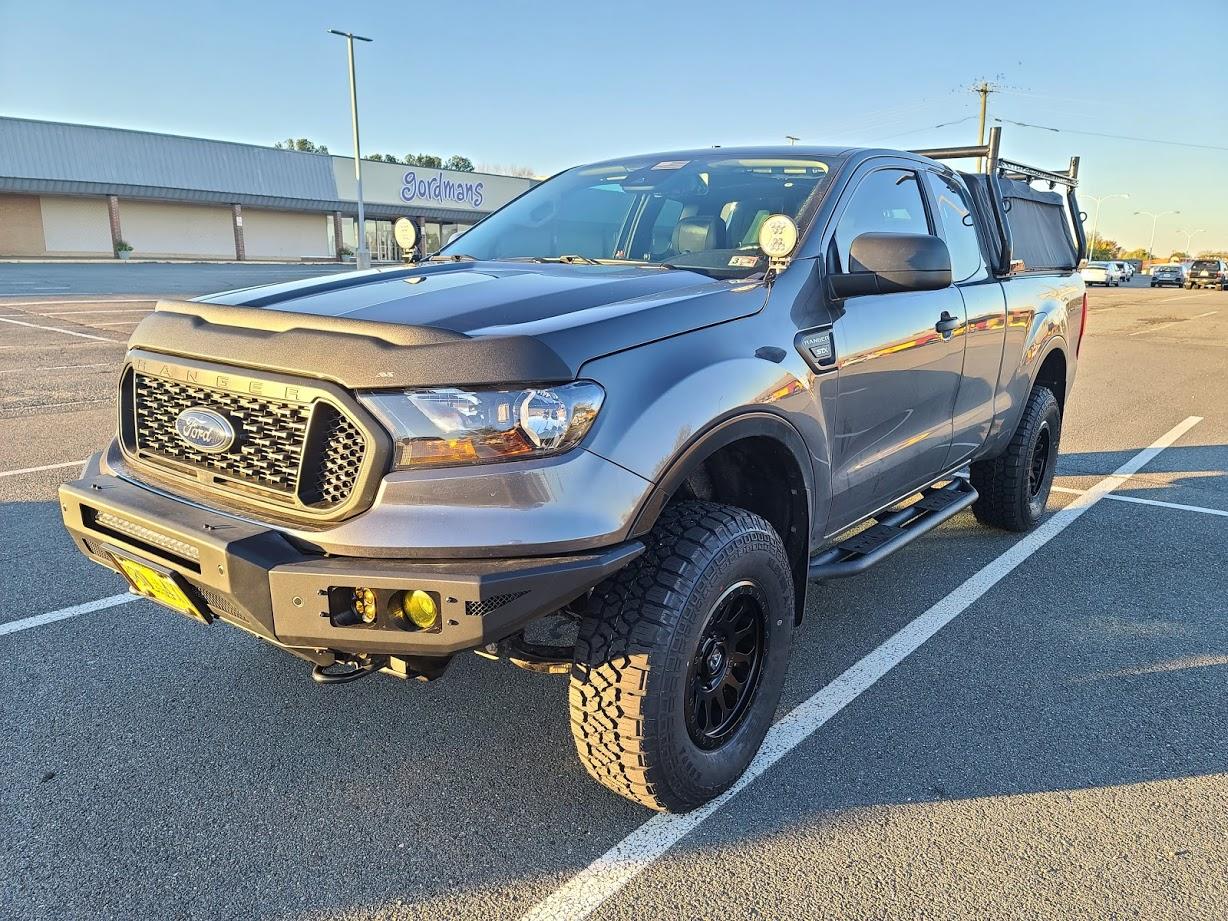

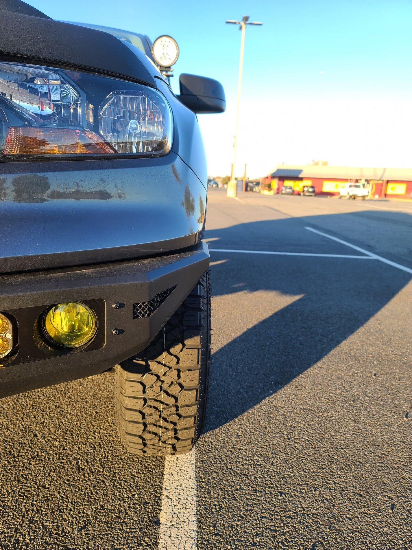

I also have +18's on a 2 1/2" front level. They sit out just a touch. Anything more than that and you are looking into aftermarket fender flares. Not a bad look in my opinion, just more money.
