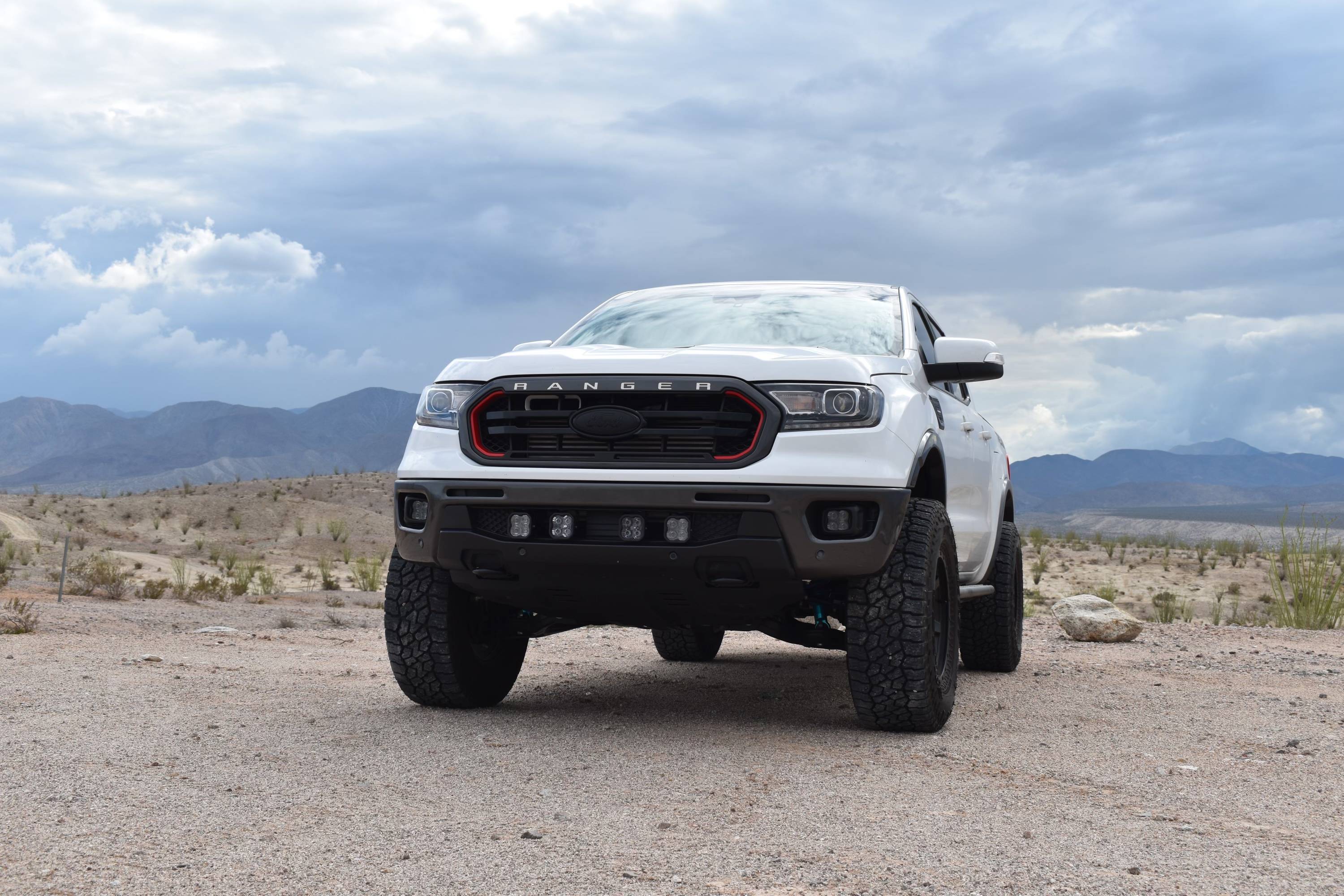

That’s a lot of poke.
Here’s what +15mm looks like with my fender flares removed. The fronts are always a bit deceiving but on the rears, the tread is just about flush with the wheel well. +1mm offset would be about 1/2” more tread but that truck looks like it has more than that.
Like the Milkman suggests, I’m guessing a 1” spacer.
Now your picture makes sense…..

So I'm not exactly sure what your goals are but I would not recommend having the tires stick out that far what so ever. I myself ran both 32(bottom) and 33(top) inch tire on my 2019 Ranger on the factory Sport wheels with no spacers and the Old Man EMU suspension. Did great and was able to do quite a bit.
If looking for practicality then keep it simple.

Well said…… but I am a Tweaker…. Not the drug kind either.

I did get my answer that I was searching for and I want to give a serious thank you to everyone!!!!! Thank you guys. Party on!

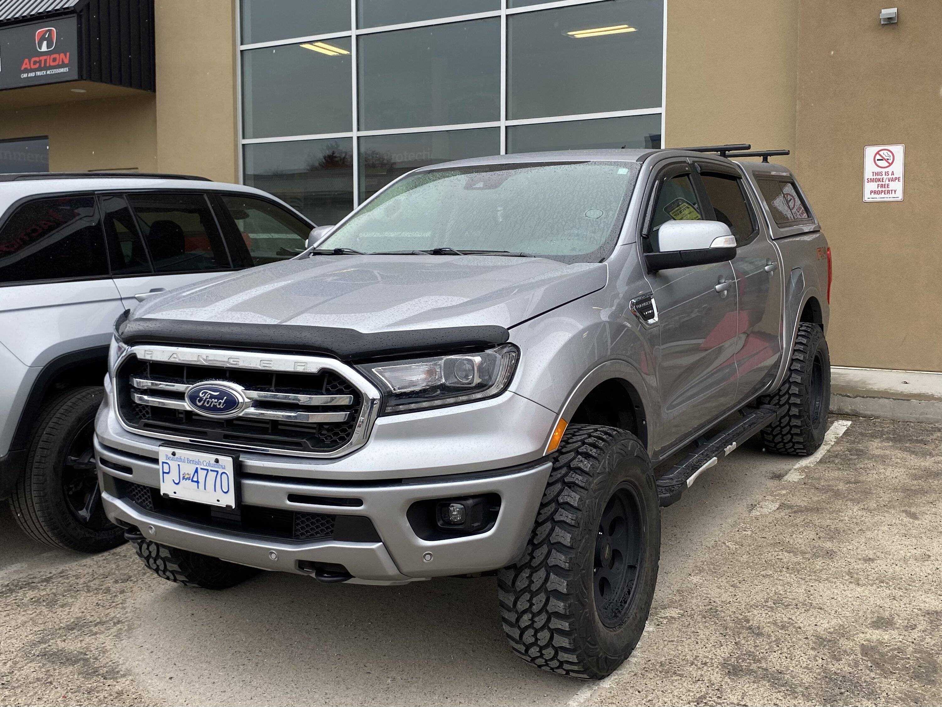

I have a -12 offset and my truck drives like a f*cking dream. So I don’t know what you’re talking about. Also yea it’s gonna kick up some dirt and rocks, but it’s a truck my guy not a sports car.
QuickSilver
Daven
Dec 14, 2020
210
636
Vancouver Canada
2020 Ford Ranger Lariat
Tires, pro comp xtreme mt2 285/70/17,
wheels: pro comp 69 series vintage, flat black, 17x9 -6 offset.

I have a -12 offset with 285/70/17. Truck drives great. The offset pictured is definitely either a -12 or a +1 with a spacer.
