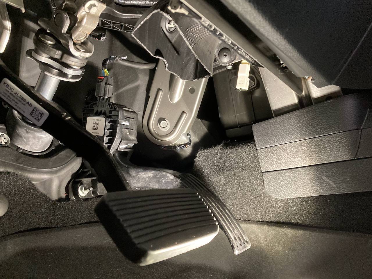

i've noticed on more than one occasion, when transitioning from gas to brake pedal, my big foot hangs up on something. i finally looked under there and the only thing that can remotely cause this is a heater vent that's right there. it moves some when wiggled. so it probably jsut snaps off. what's the harm in removing this vent? it looks like heat would then not be directed down but rather towards the firewall- though i may be wrong. thoughts? i rarely use foot heat or cooling but sometimes i do the dual vent thing- dash and floor..... maybe take it off and cut an inch off???? it seems to be removable and is plastic.

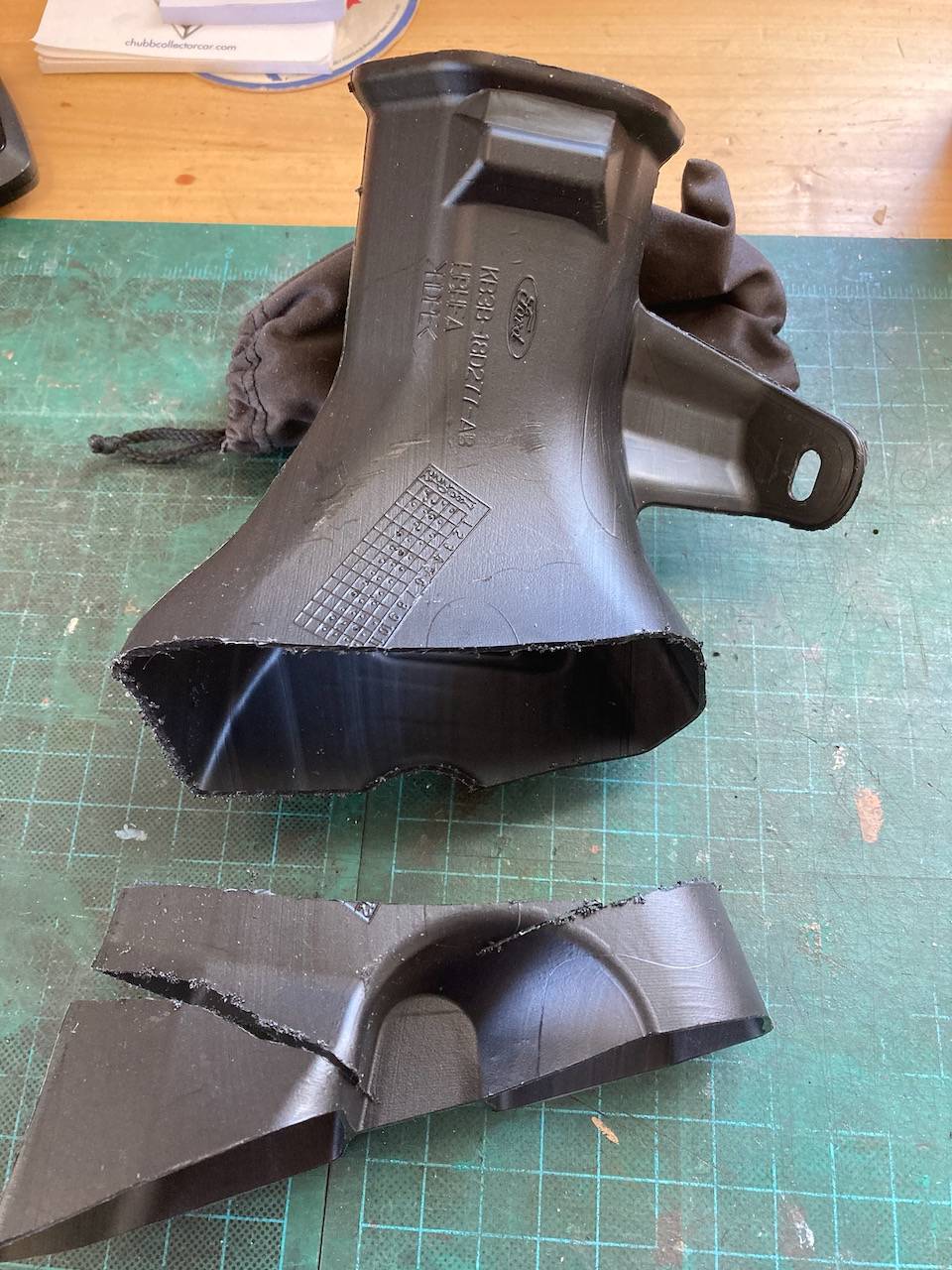

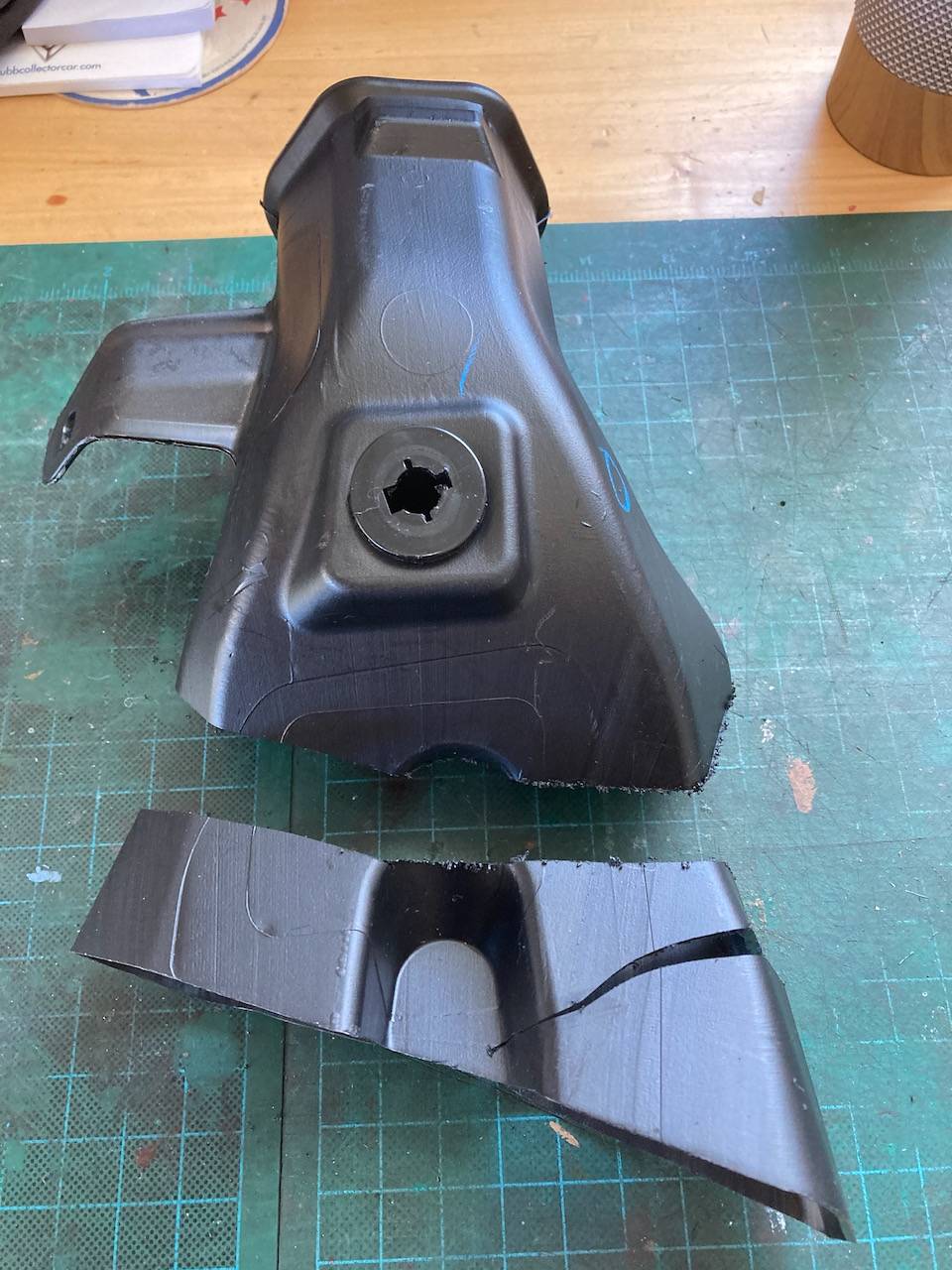

couple more snappers.
Thanks for the pictures. I have a size 12 foot, hit it constantly. Very annoying & potentially quite dangerous. Never stuck my head down there to see what it was though. Now that I know its this, and not the panel below the steering wheel like I thought it was - its cutting time!
9,879
47,275
pops right off , the sensor is a 1/4 turn and out, or something like that, the plastic tee pops out and it pulls off the upper part. pull down the big fuse door under the steering wheel for better access.
then hack off several inches. best "mod" I made
Bob, you need to sharpen the blade on that chainsaw. ?
