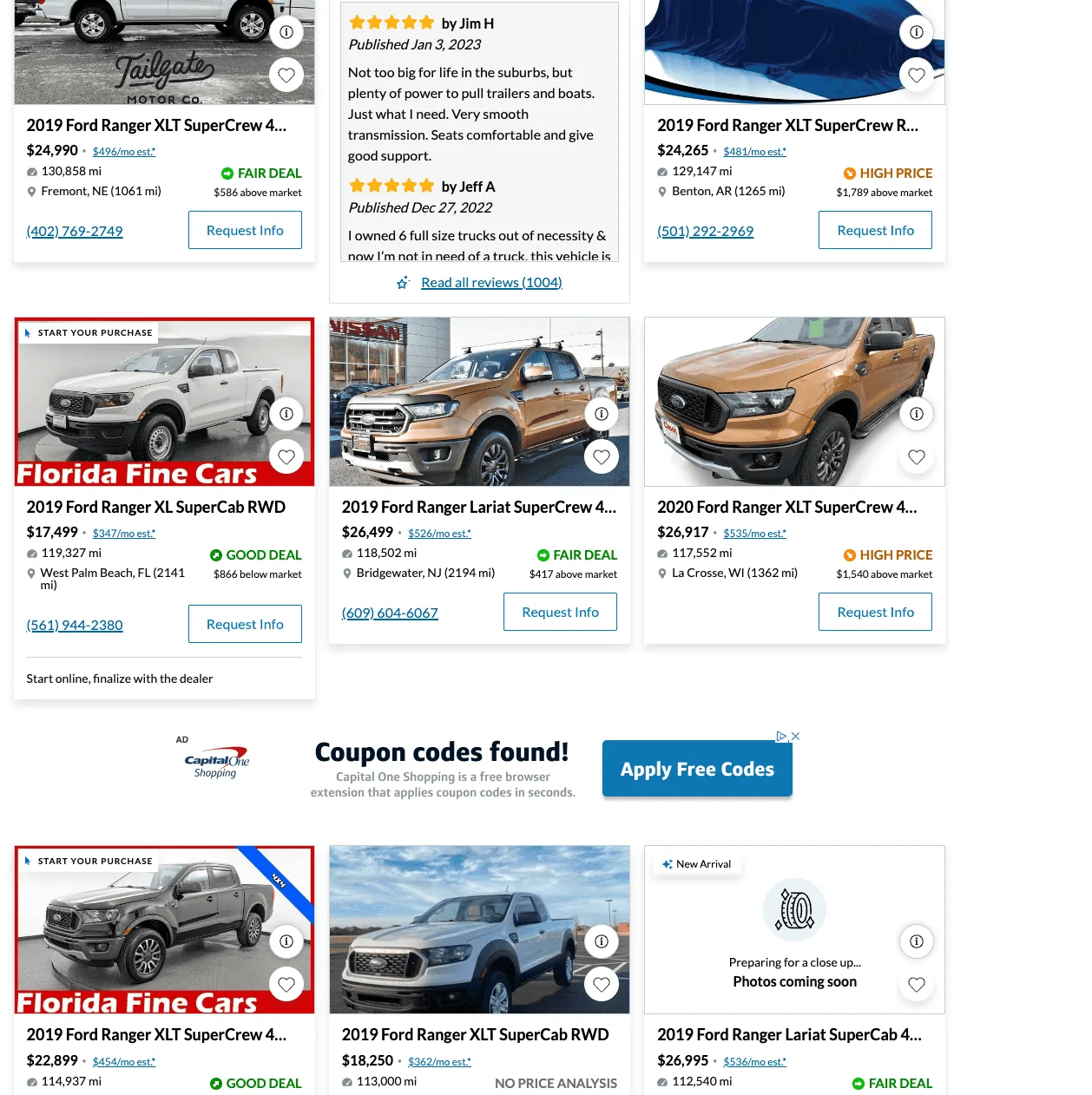

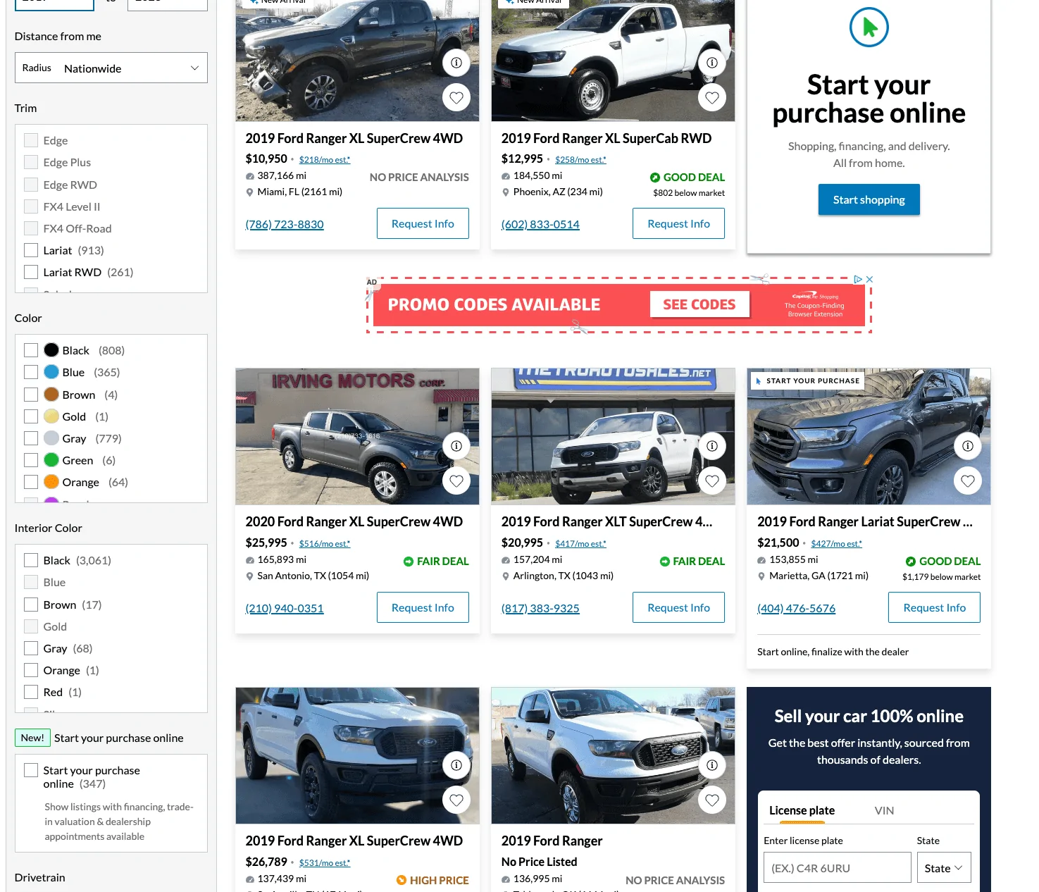

These aren't Members, but these are Rangers over 100k miles. The 380k mile one looks like it has stories to tell at dinnertime LOL. This is just a CarGurus Nationwide search sorted by highest milage.
Wow $26K for that many miles?! Had no idea our Rangers hold so much value...
