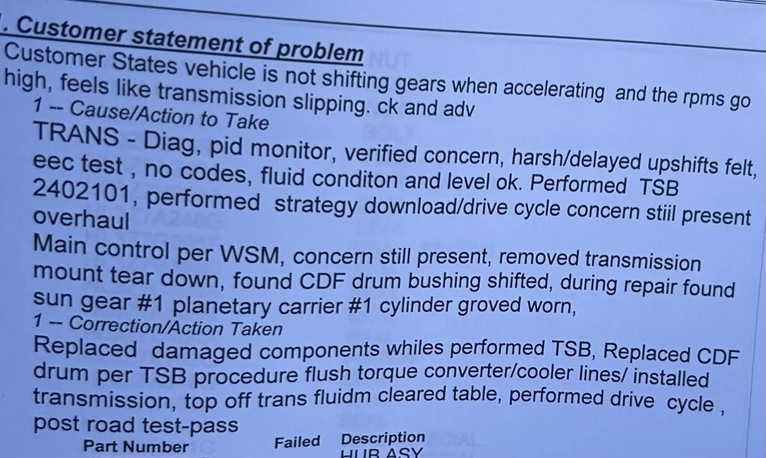

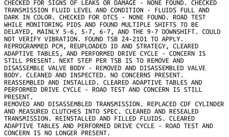

The service write-ups early in this thread look like mine. My dealer was very thorough, and I was fortunate that the valve body replacement fixed mine. I have driven about 2k since the repair and all is good. I have 79k on my truck now. Woohoo! I am actually very pleased with my Ranger. Comfortable, decent mpg's, and so far my 4x4 has not left me in any situation I could not get out of.

Well, short lived. Less than 20k tranny is doing the same
Shit again, bucking, surging, loud bangs at different shift intervals. Trucks back in the shop, once fixed I’m selling her. I’m done!

When was your trans last repairs? I am curious if it got the updated parts. I just hope if I have a trans issue it is before the warranty is up. Already got an engine at 50k miles (stock and 5k oil changes, bad #4 rod bearing). I really want to keep this truck and enjoy no payments, especially since it seems many brands are having issues now a days.
