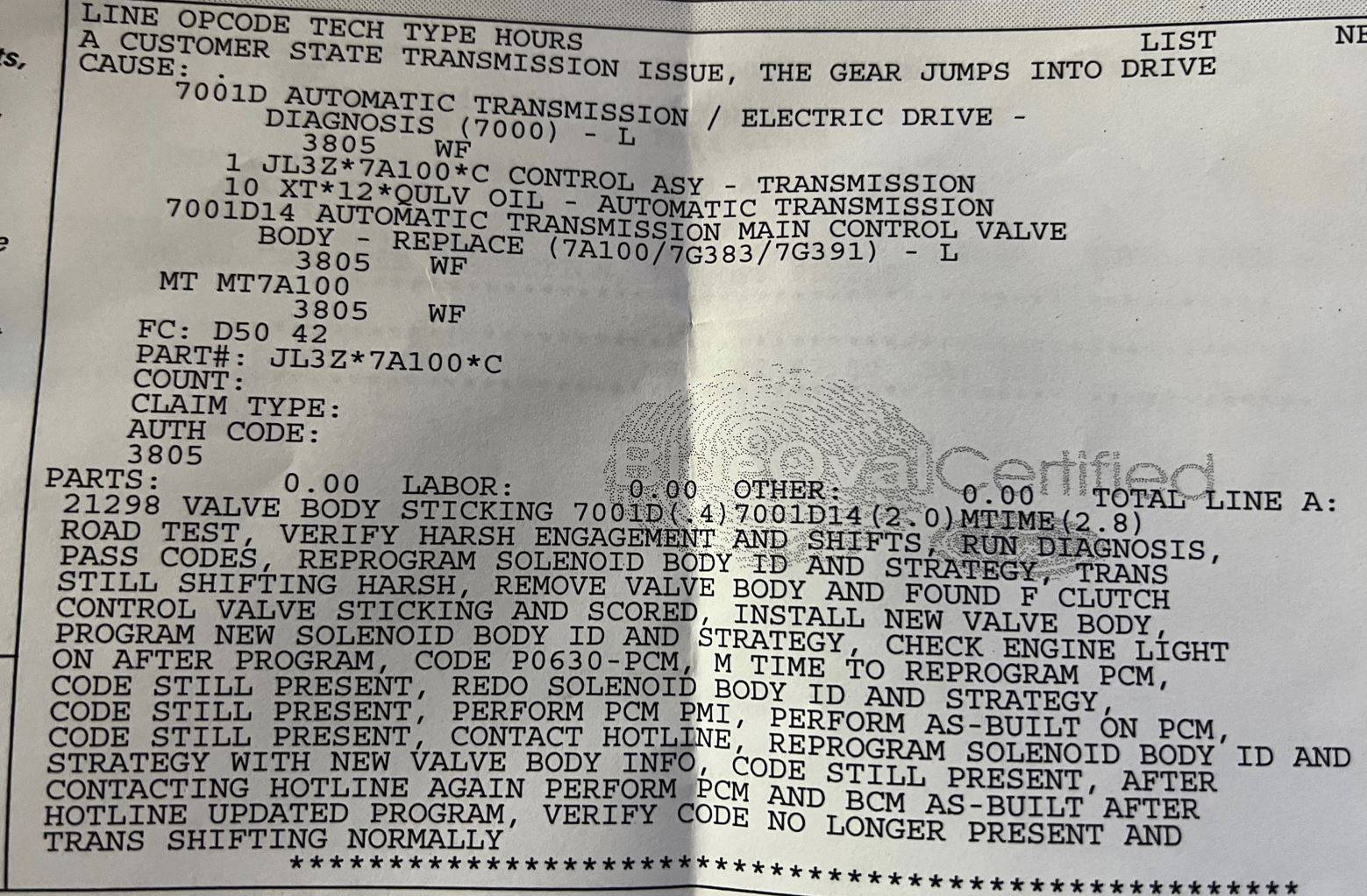

Update for y'all. I had Ford look at my truck to see why it was shifting hard into Drive. They had my truck for 3 weeks! They said that TSB 19-2052 did not apply to my truck. It turned out that they needed to replace the trans control valve, and then they had to reprogram my PCM to As-Built.
It now shifts smooth again, and all under the Power Train warranty. Ford will get the $1200. bill lol
The only bummer is that my FORScan changes reverted back. I got all of them enabled again, except the DRL. That one just won't work for some reason, so I posted a question in that thread.
Attached are the actual notes from the Ford tech, for those who want the detail.
