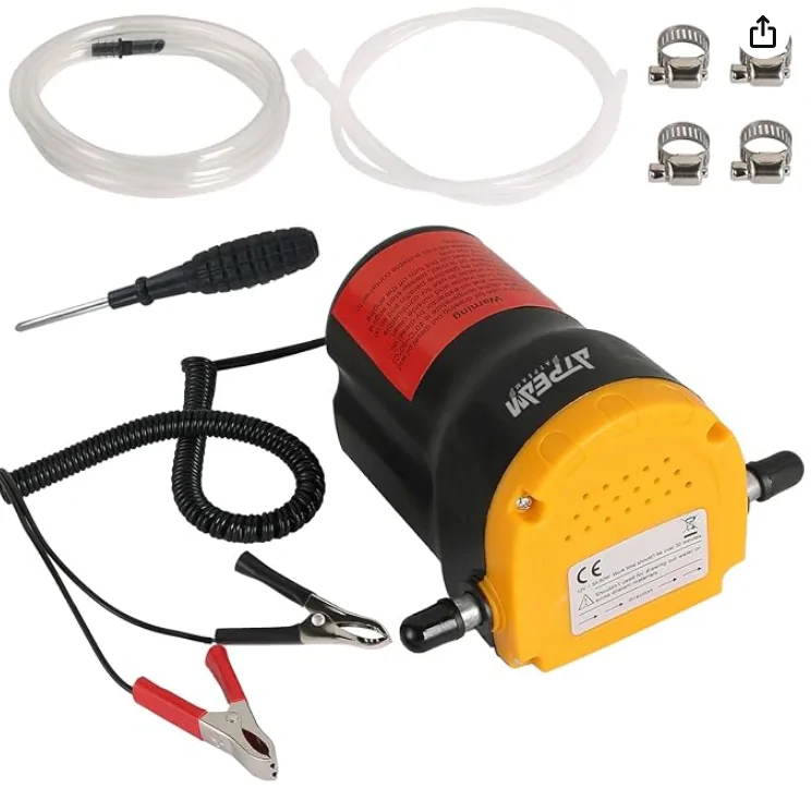

The pump a lot of us use is only ~$15 on Amazon and comes with the hoses. Works great! 45 minutes to pull out old and put in the new, with nary a drop spilled, and all done under the hood standing up. But you'll need Mike's FitzStick!
