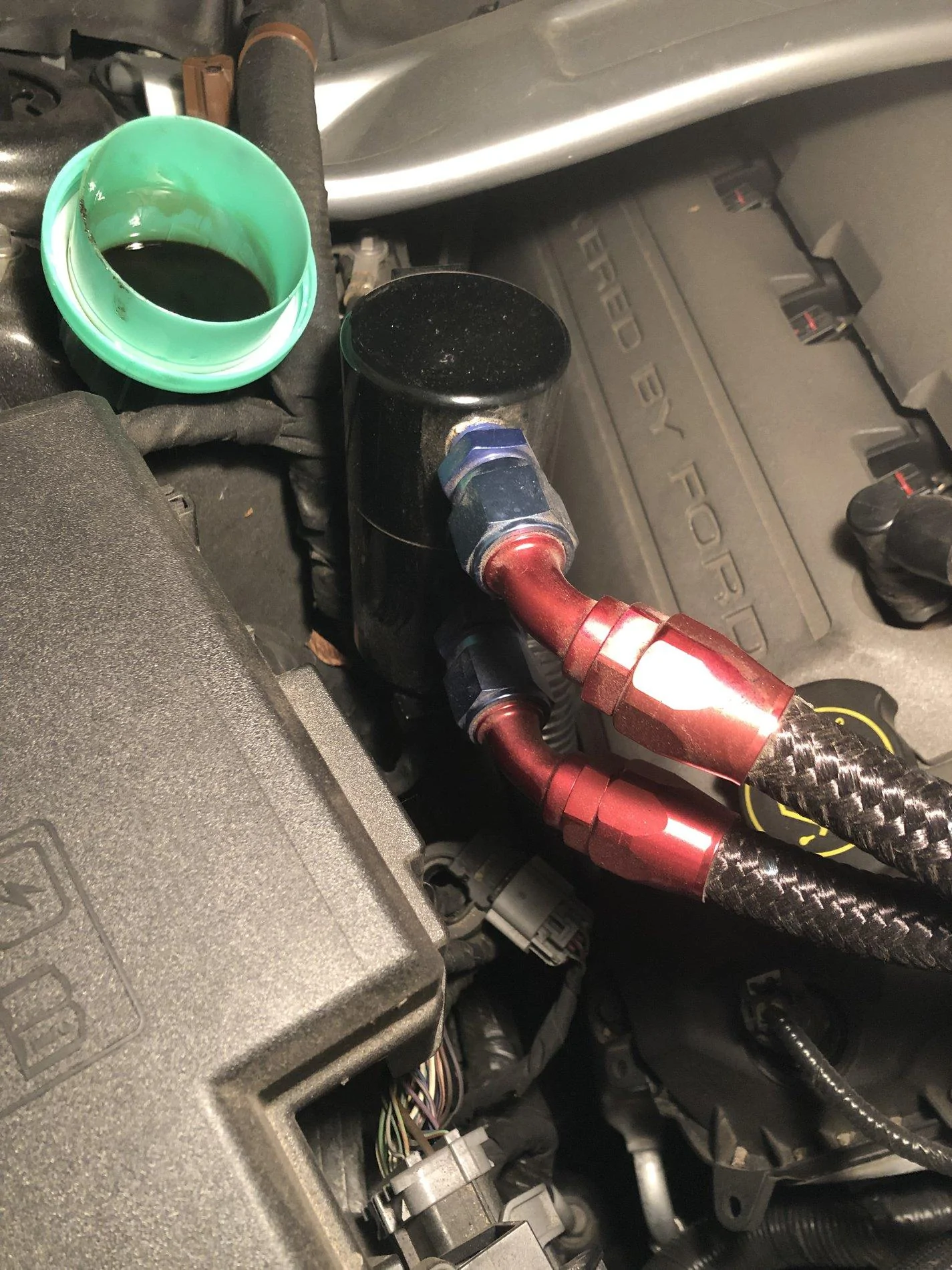

Please include me in that. I followed your, “by that, I mean mishimoto’s” posts in the mustang6g.com forum when you were designing and working on the Mustang catch can. I had already purchased and installed Bob’s Catch Can. What I liked about Bob’s were the options they provided on the new connection hoses. Has Mishimoto considered these as options?
Btw, the liquid in the green cup is what came out of the catch can after 4,000 miles.
