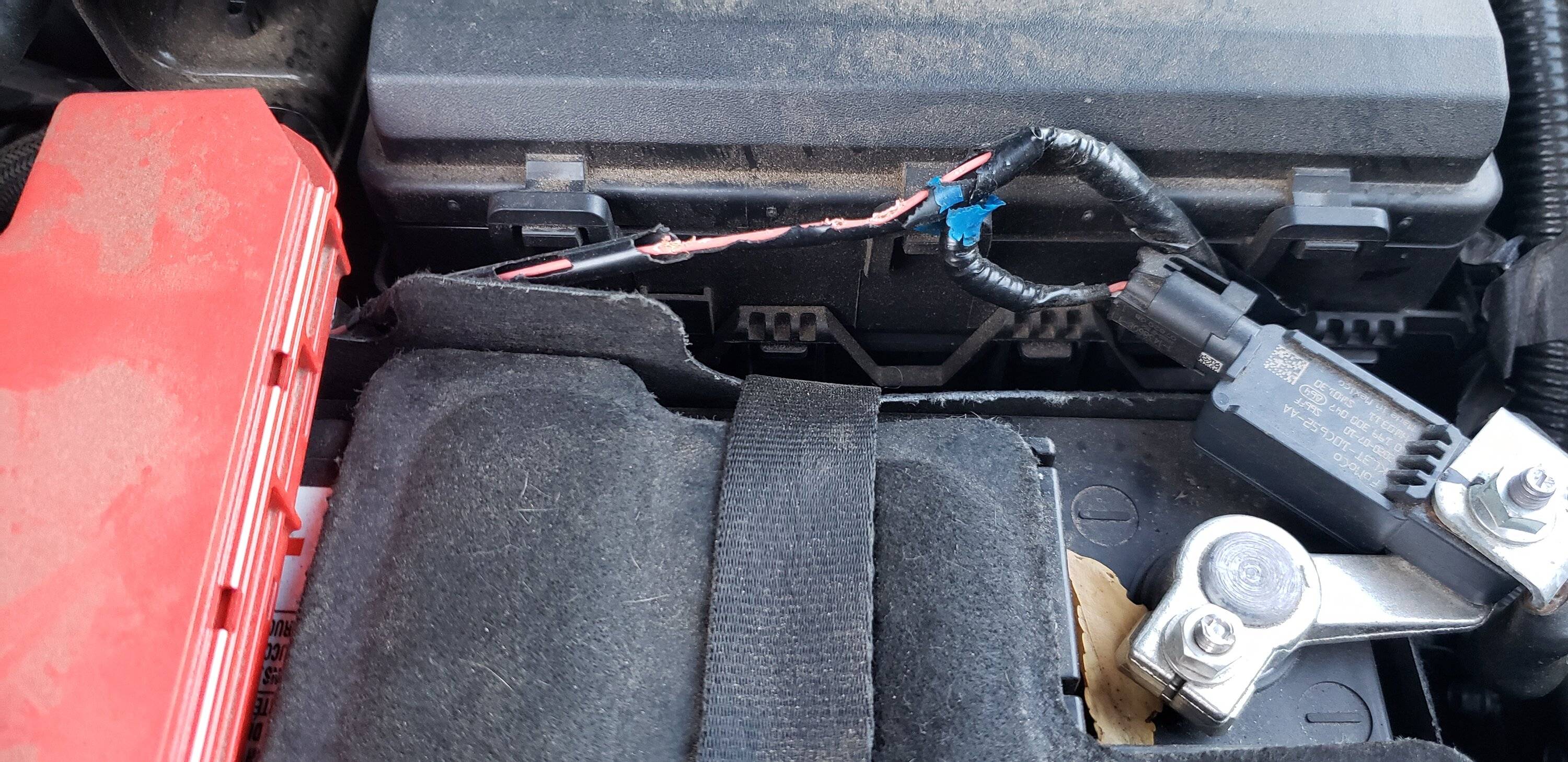

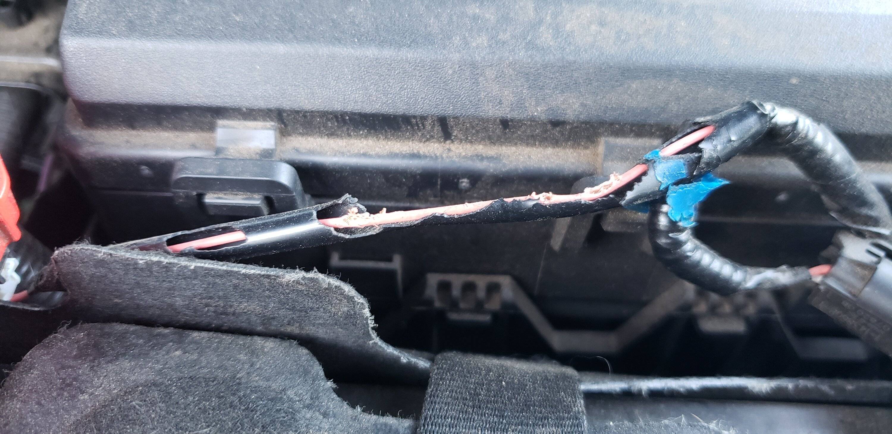

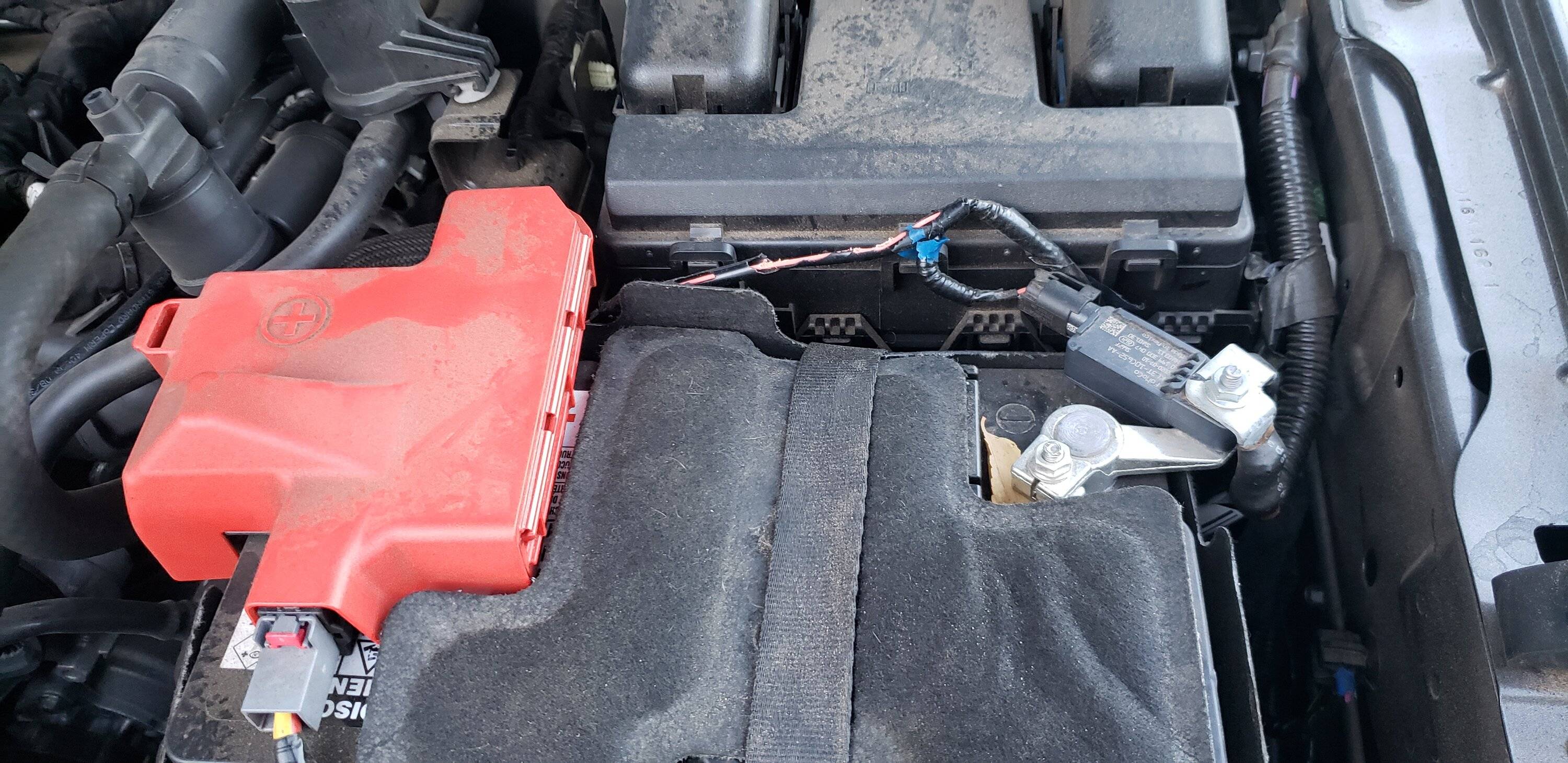

Does anyone have a wiring diagram for all the small wires coming off the battery? I'll try to get a picture in the morning but one of the thin wires looks like it's been chewed. Also I'm guessing this isn't covered under warrantee?
Is this mouse damage or something else? No other signs.
Looks like mouse damage to me, and no it wouldn't be covered under warranty.

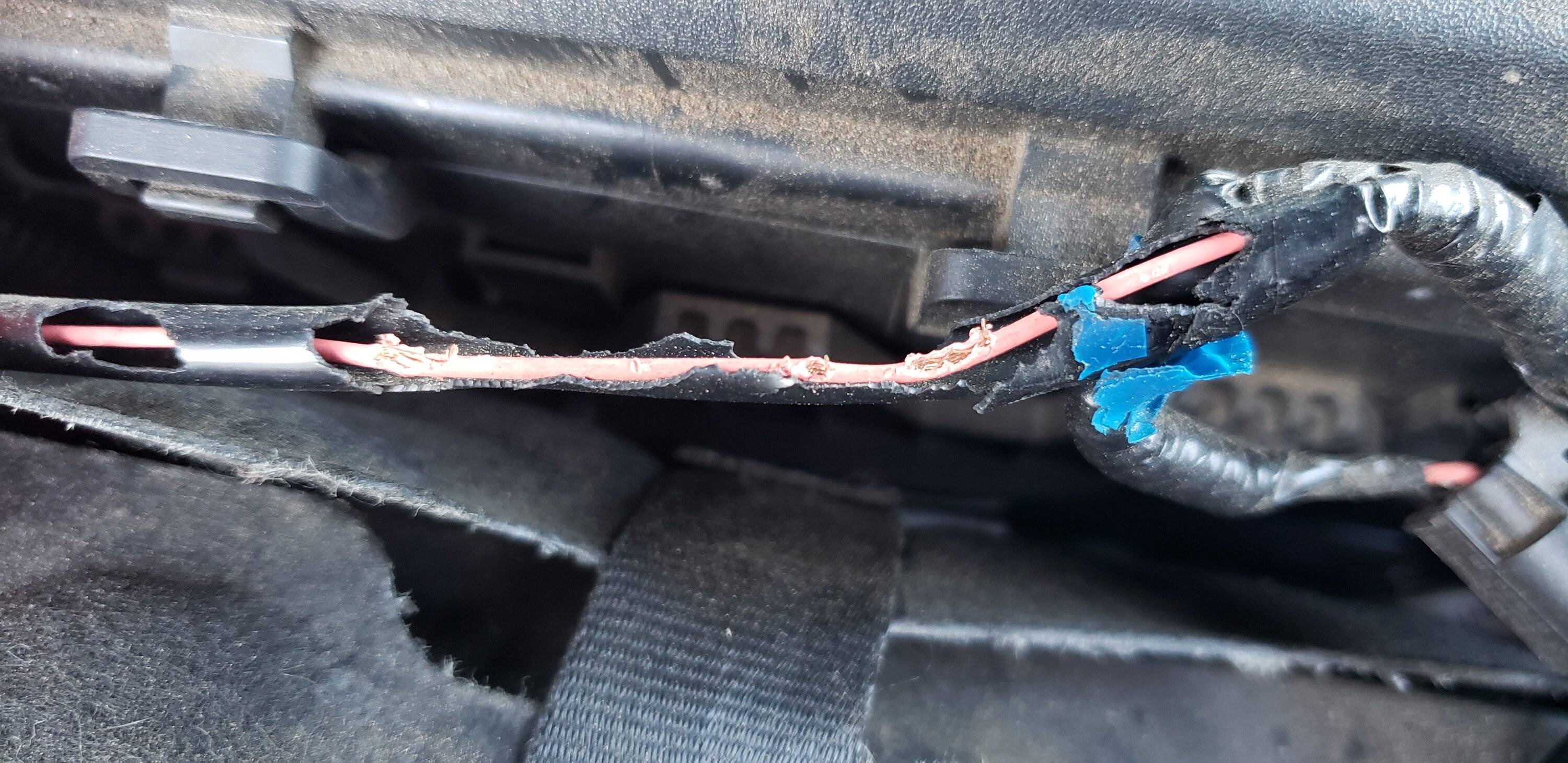

Didn't think warranty would cover it. Had to ask. Looks like just the insulation is damaged, not the wire itself. I just wrapped it in electrical tape.
Anyone know what that wire is for? Guessing it has to do with the battery monitoring.
Possibly a rat- there should be droppings, you would be able to tell by their size.

Not battery monitoring.

It's hard to tell from pic, but it is Harness # 14290, by the pic is runs past the BMS, but the wiring diagram shows only one 20-gauge wire on the Battery Fuse Link and that feeds the BMS
If that wire runs to the bottom of battery post connection (White Connector) #C1135B then that's for the BMS
I checked my truck and it's all covered in insulation, so cannot see wire without cutting into it
If it runs somewhere else, get me close, and I will dig deeper, I think that wire goes past the BMS and routes back towards it, (extra wire length for strain relief) when the battery is disconnected the pic makes it look like separate (Red) Wire runs (2 separate wires) but looking at it closer that bundle coming in from the (< Right) is the incoming feed from the BCM (Monitoring Circuit) and they meet together in the uncovered harness

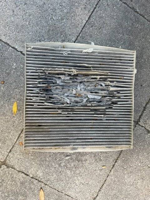

I was backing out of the drive yesterday and saw a rat run across the drive in front of me. The way he was running seemed like he had just dropped from the engine bay. I had recently seen this thread and my suspicions were high.
I checked the engine bay and I did see a few rat footprints, but nothing else seemed amiss. First thing this morning, I started up the truck and backed out of the driveway again. I told my wife to watch under the truck to see if she saw anything unusual. I heard her scream as I drove back up the drive.
I searched and found this thread: Check your air box… | 2019+ Ford Ranger and Raptor Forum (5th Generation) - Ranger5G.com, and immediately checked the cabin air filter.
So now, I guess I will try and seal the fresh air intake to the cabin with some wire mesh and also the engine intake.

I sealed the holes this weekend. Copied this technique, which I think is the best solution:
https://www.ranger5g.com/forum/threads/check-your-air-box….15646/page-7#post-439452
Seemed to work pretty well. I put a security camera in the truck after sealing to make sure there wasn’t any activity. Don’t want a dead rat in the duct work. All looks clear so hopefully the interior should be protected now. I guess now they will only have the engine bay to hang out in.
