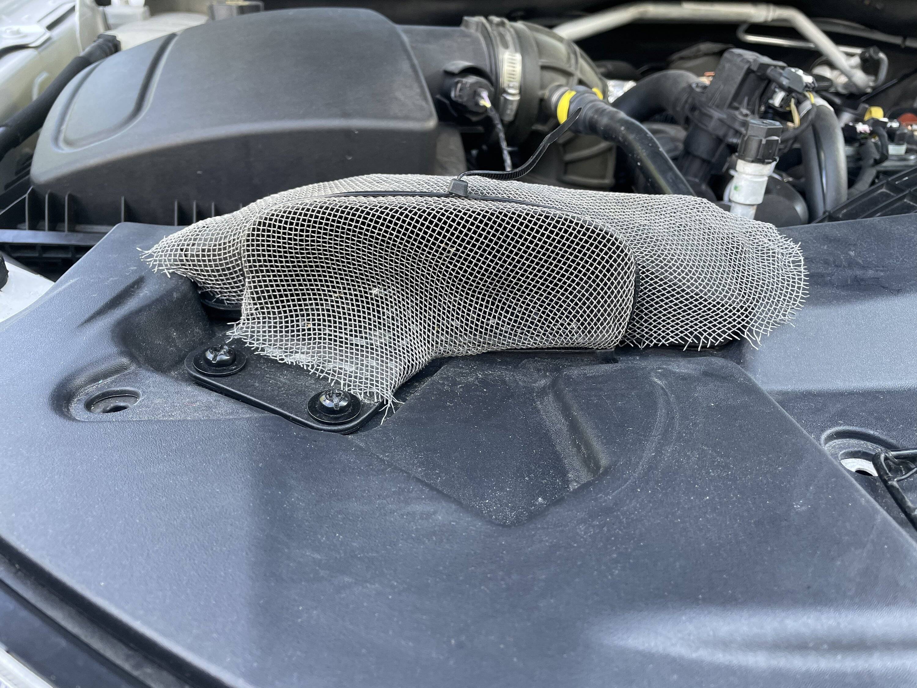

Well, I spent a good part of a day putting a (size 6) stainless steel mesh over the two air ports that allow air into the cabin air system. It was a fairly easy fix as you can see in the pics. I ended up molding the mesh so that as one piece it would cover both openings. I ended up using JB Weld Steel Stick. I cut and mixed a batch of it and stuck strips above and below each opening and then pressed the mesh into them. I then molded the putty tight into the mesh as you can see in the pic. Within an hour the putty was rock hard and provided a nice tight fit for the mesh.
That’s the solve right there.

In other posts, I've read and seen pics about the air intake for the heating/cooling system down through the cabin filter, but no picture shows me clear enough exactly where the air intake(s) are for the interior. Is it underneath the plastic cowl by the wipers? Can anyone please tell me where and how to get to these intake(s) so I can also block them with wire mesh.
Any help would be greatly appreciated!
I went with an old window screen.

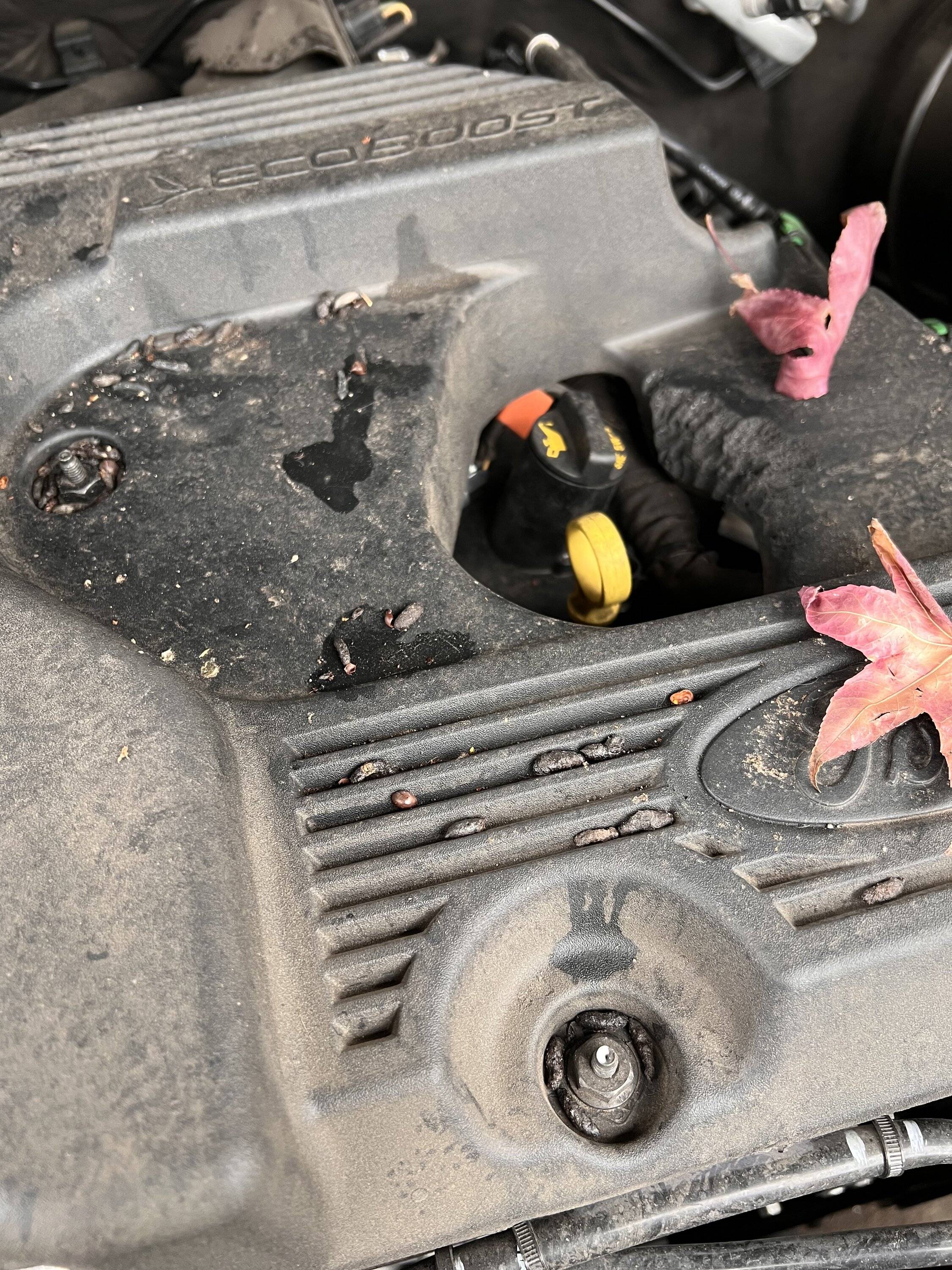

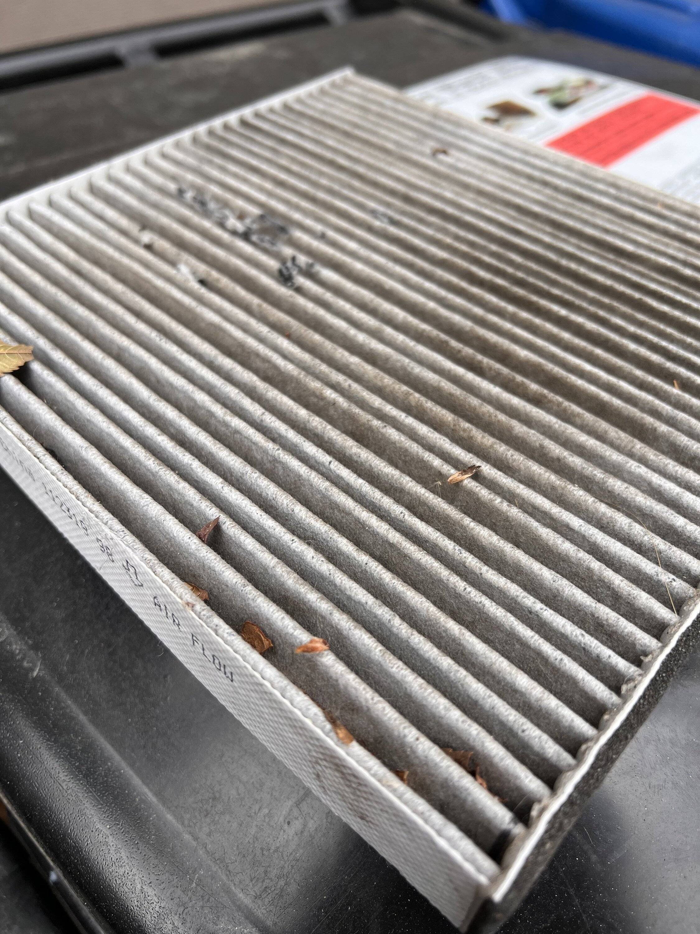

I've been pretty good about keeping an eye out and checking under the hood every few weeks for any activity, but with all the rain we have been having for the last month, I slacked off and the dammm rats finally got me.
I went to change my cabin filter last week and found some doo-doo and someones been chew-chewing on it which means they have found their way into the heater box. :mad:
I popped the hood to investigate and found more poo...... AND they have been eating my engine cover and tasting some of my wiring. ( luckily nothing major ). I hate rats. ?

3-4 months ago I saw someone started to eat my battery blanket with poop all over but thankfully nothing else was touched. I sprayed my entire engine compartment down with Tomcat(mix of peppermint oils and such) every few days for a couple weeks, and haven’t seen anything since. They could do some real damage on such a modern vehicle with all the electronics and harnesses.
