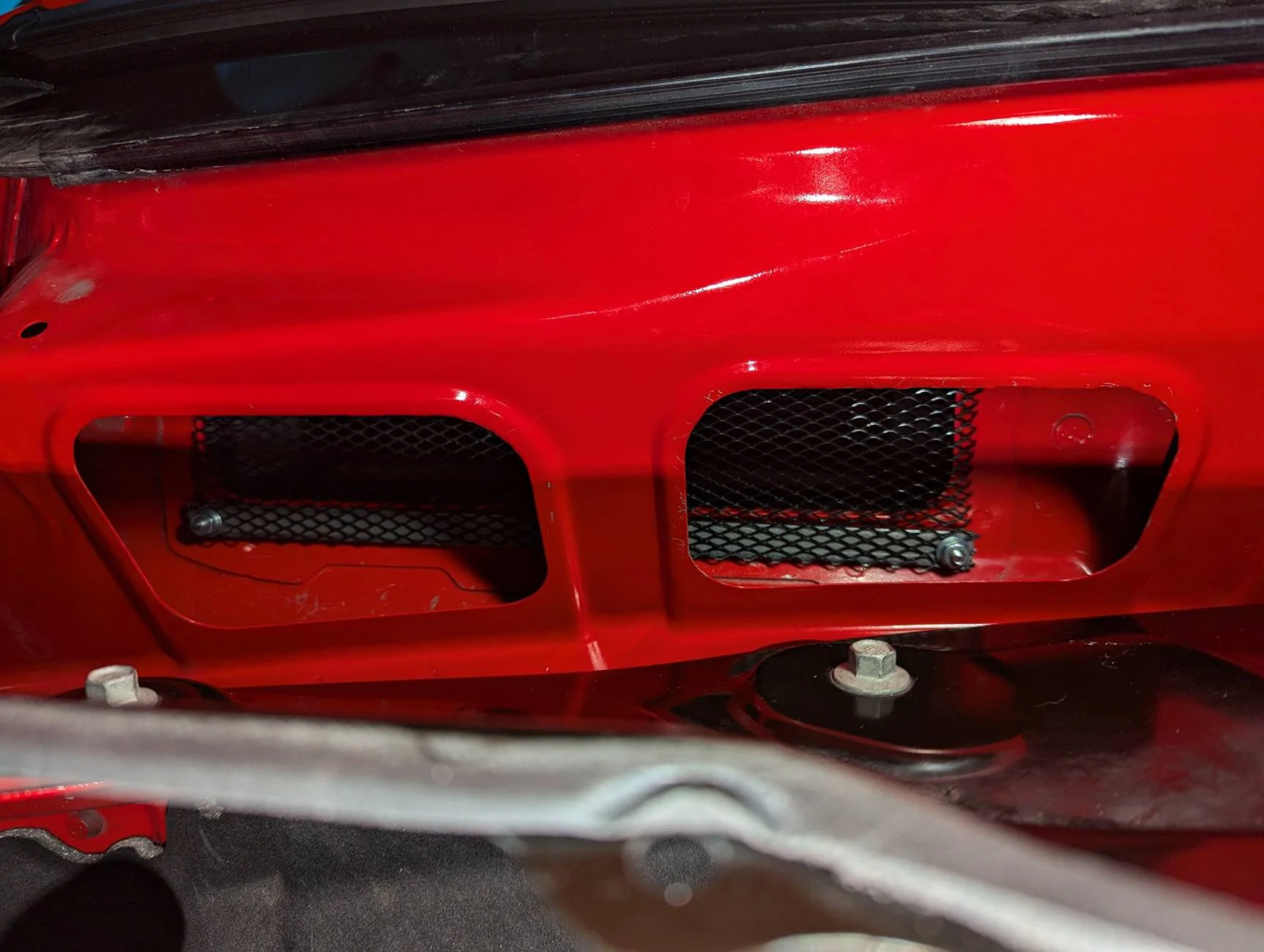

It's just all the holes in the sides of the sheet metal there. I made an L-shaped guard from the hardware cloth and ziptied it in there. Had mouse turds in both rear seat compartments.

I did the hardware cloth over the cowl intake after finding evidence of mouse in glove box and no problems since. Will take a look at jack storage area.

I screened the HVAC fresh air intake holes in the firewall after my initial discovery.

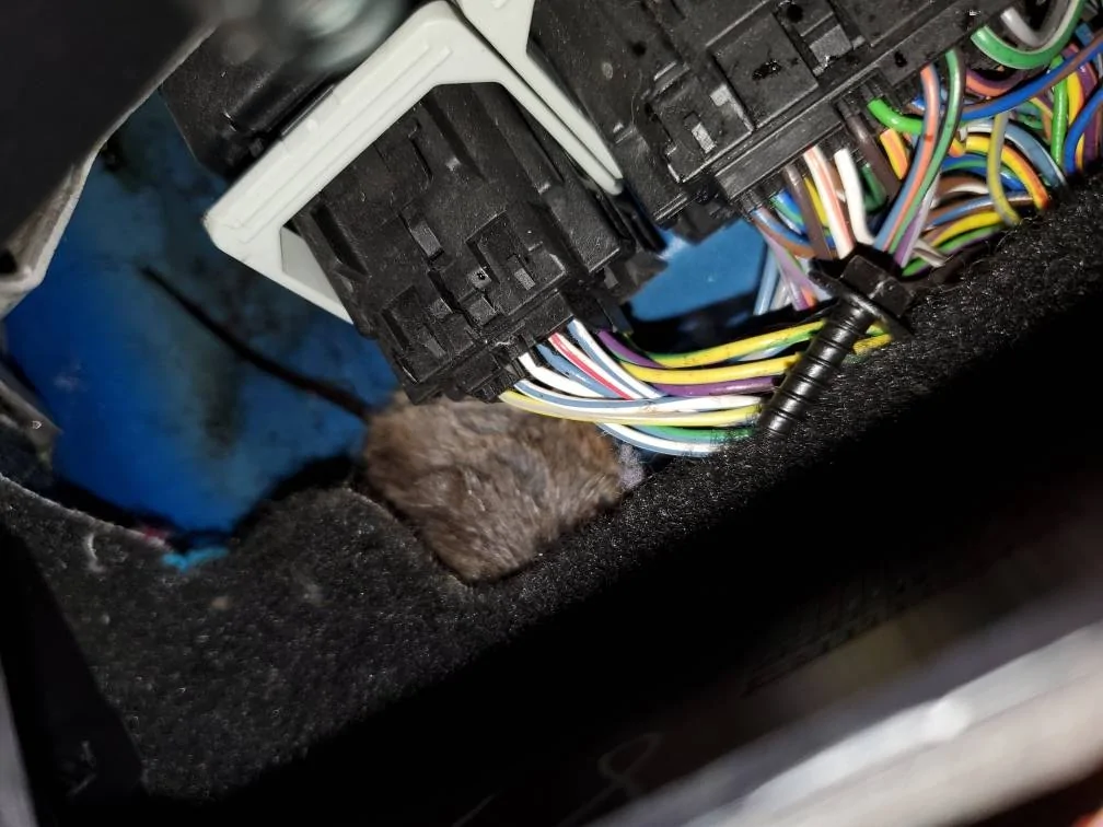

Honda made capsaicin tape you can wrap your wiring with in response to a lawsuit. With the peppermint oil soaked cotton balls and hardware cloth in the front cabin vent and rear seat storage bin it works OK. You can't come close to wrapping your whole wiring harness without pulling it out though. I still make a habit of trapping and killing mice regularly just to keep them away, because they still get in. This one was under the glovebox.
