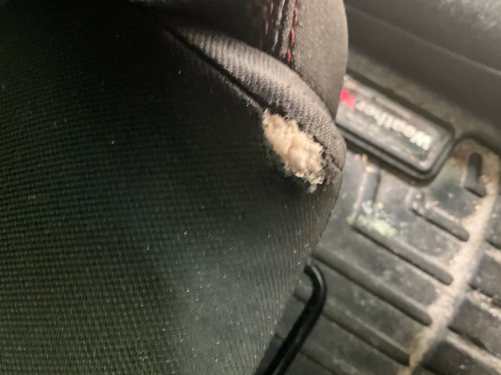

My WRX had an awful smell.. I put two sticky traps on the backseat floor and there was a dead mouse in each one ..
( before, they ate the corner of my drivers seat, anyone know how to fix that) ?

How about this……..
Short of taking the cover off and sewing a strip or whole panel in, I can’t think of a way that will look halfway decent.

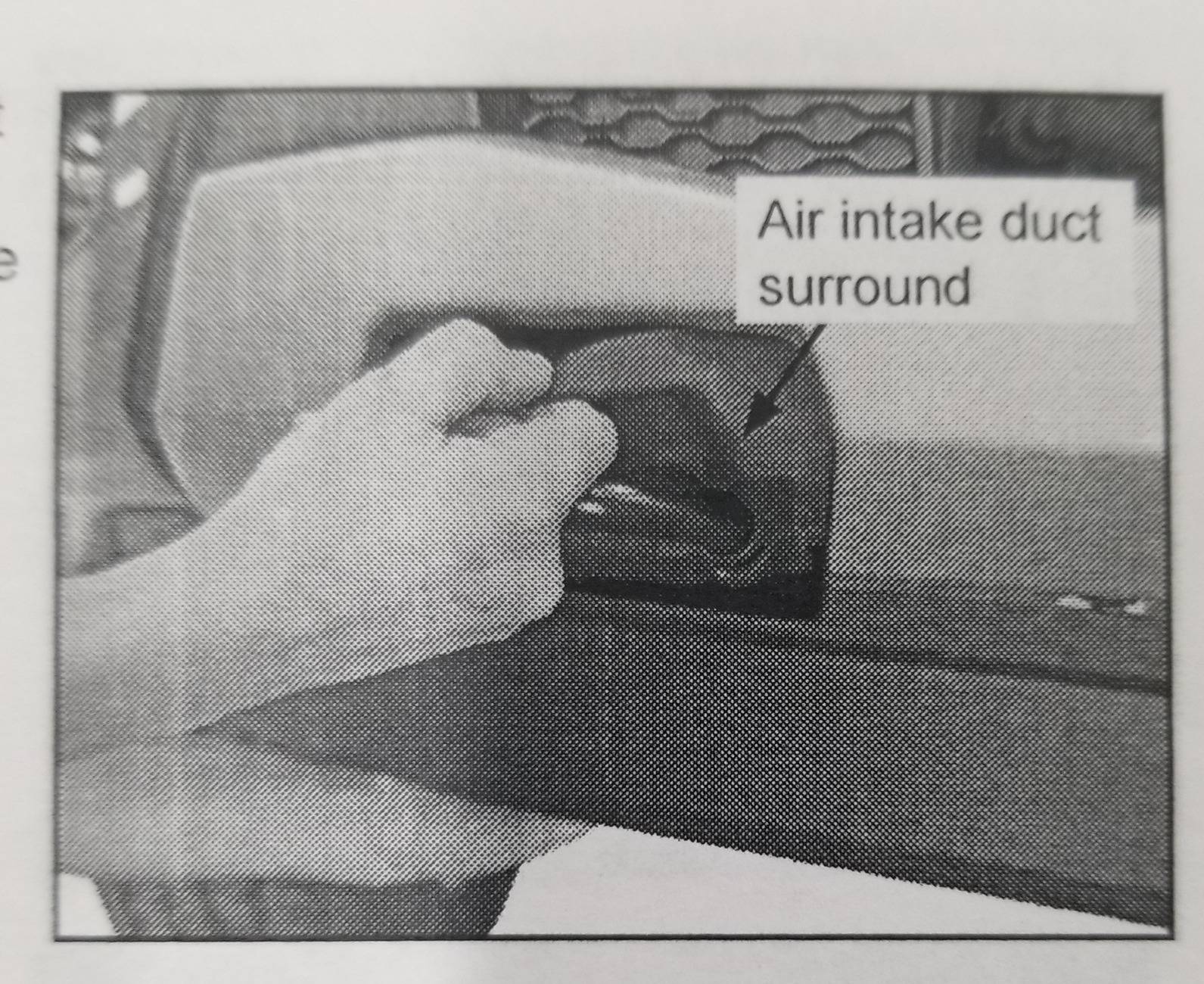

I have that problem with my 2019 Ford Ranger. Yes mice. I trap them in the cabin almost 3 or 4 a week in spite of peppermint, cedar, moth balls etc... in the engine compartment and inside the cabin.
I am told and I have read they enter via the air intake to the cabin.
Air intake gets into the cabin via the air vents behind cowl, the plastic piece beneath the the windshield.
I have looked everywhere to understand how they get behind the cowl to access the air intake. There are no obvious holes around the cowl.
Is there another way they can get into the cabin?
There are two rubber pieces around the 2 tow hooks on each side beneath the front bumper. I attached a pic and it shows what they call the rubber piece Air Intake Duct Surround. Do mice enter here to follow a passageway that leads to the air intake beneath the cowl? From here do mice follow another passageway to the cabin filter and then drop onto the passenger side floor?
I am trying to figure out how to prevent them from getting in by installing a screen somewhere? Hoping to solve this once and for all.
Thanks for your ideas. Henri.

There are threads covering this very issue.
But to answer your question - The Cowl & The Rear Exhaust Vents are the entry points.
Just search through the threads:
Here is my added screen, just a drywall sanding screen - tapped in place
They get into this area from the - Cowl Drains on each side of the cowl.
