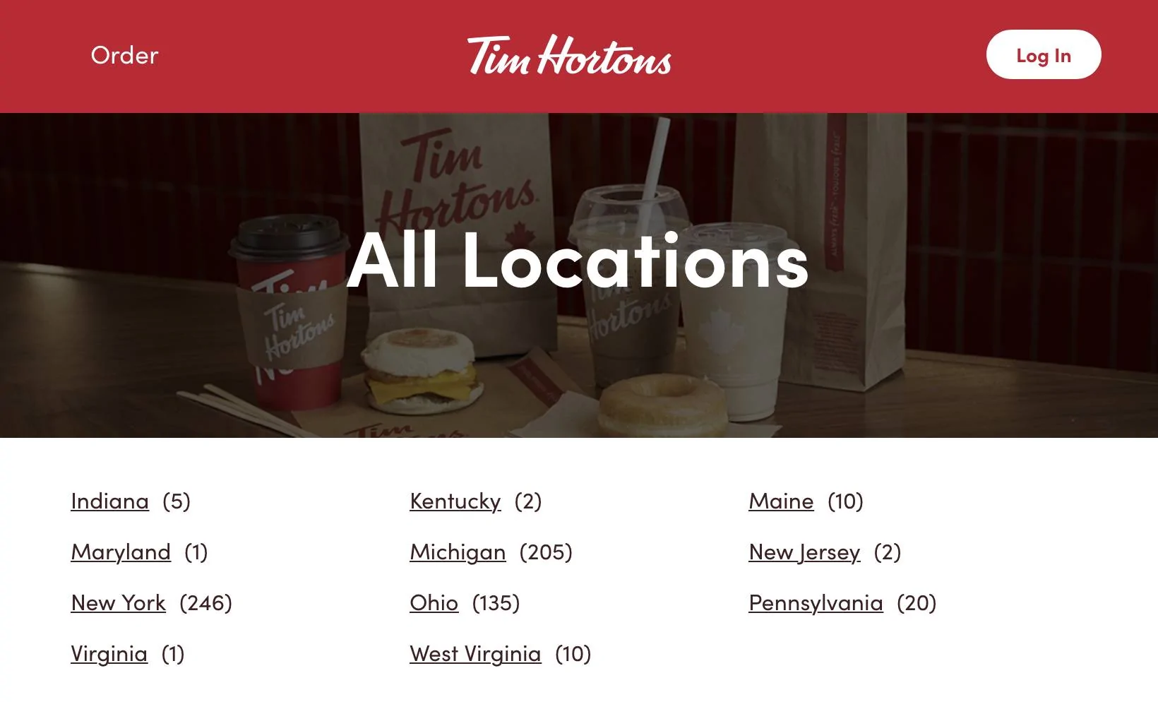

That's the effects of globalization. They gotta take the bad with the good, maybe a Tim Horton's coffee will ease the pain lol
:cool: ?? :cool:
They tried that in CT but closed them all time in 2010. Folks there have to drive to NY or ME now.
