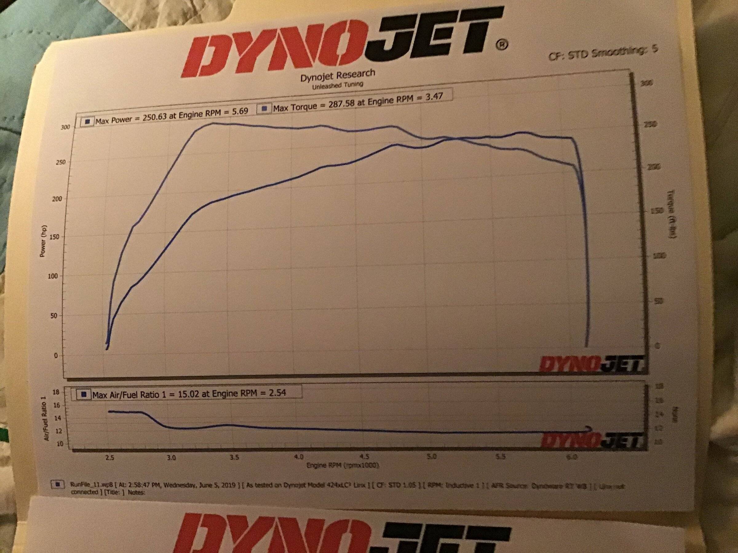

Here is my stock 93 octane Dyno , before Unleashed tuned it. This is to the rear wheels.
Unleashed added 40 HP and 100 lb/ft torque …
That's your truck. All vehicles, locations, Temps will vary. Your unleashed tune seems kinda low compared to other tuners. Honestly
