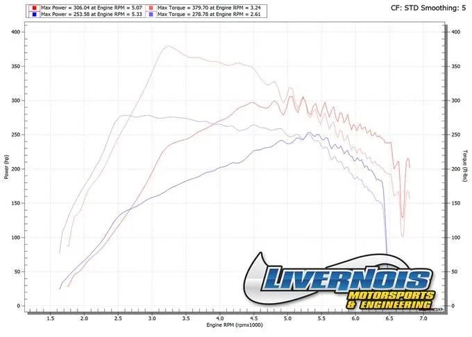

ive seen 5stars dyno before. I just want the tuners out of the equation for obvious reasons that I believe they are biased to show something that leans towards their tunes. they're all about selling product, not about settling a playground scuffle.
I guess my request for a regular joe having dyno'd the high/lo octanes on his own will be the holy grail.
There are non-tuner dyno's out there showing the same. Tuning companies would show base low ball dyno numbers to make theirs look better if that were the case.

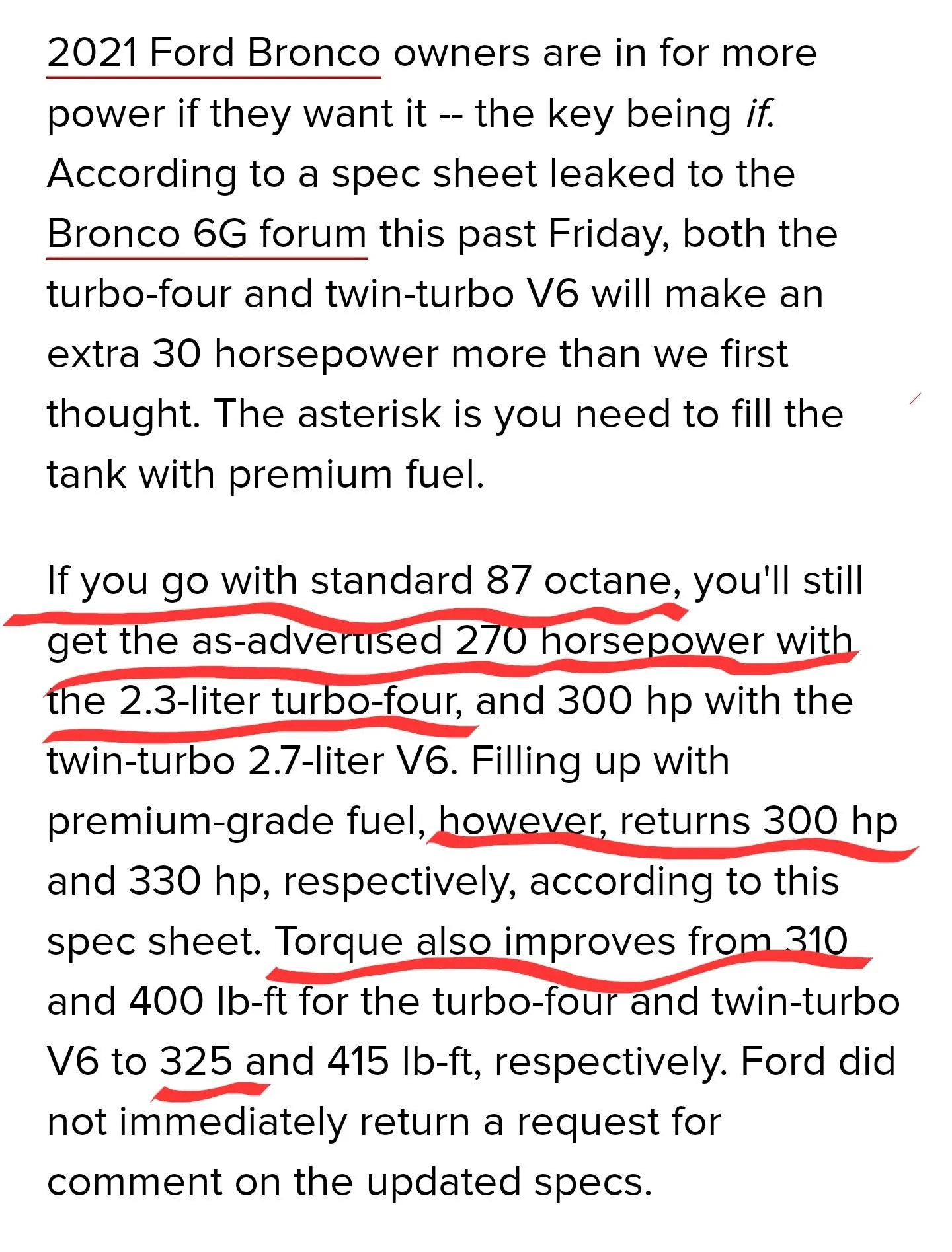

Yup you agree with me as well then about cost per mileage being more efficient with 87.... I was specifically stating the power advantages of premium. It is clearly there, .7 seconds faster 0-80 is big.
From previous math sessions, you would need something in the vicinity of 5 MPG increase from regular to premium fuel to break even on the per-mile cost. That’s never going to happen with any tuning strategy.
Agreed! They would want thier product to appear as valuable as possible, especially with several competing tuners out there.
I put my truck on a Dynojet before I even had 500 miles on it. I fill it with 92 fuel starting when I got it, though it had 3/4 tank of 87 from the dealer. Anyway, it put out 259 WHP / 287 WTQ on the Dynojet. The two runs were very close to each other and that is the average of both runs. Now either that's an incredibly low 4 percent drive train loss, or more more likely, the crank numbers are closer to ~300 crank HP / ~325 crank TQ. The numbers from my dyno are fairly similar to what others have reported on premium fuel. Do I care if those numbers would be lower on 87 fuel? No, not even a tiny bit. There are enough premium fuel dyno's out there for our trucks to see that accounting for drive train losses these engines put out about 300 crank hp. Any time someone wants to run 87 fuel for a while then pay for a couple dyno pulls, be my guest but I just don't see why the argument even matters.
