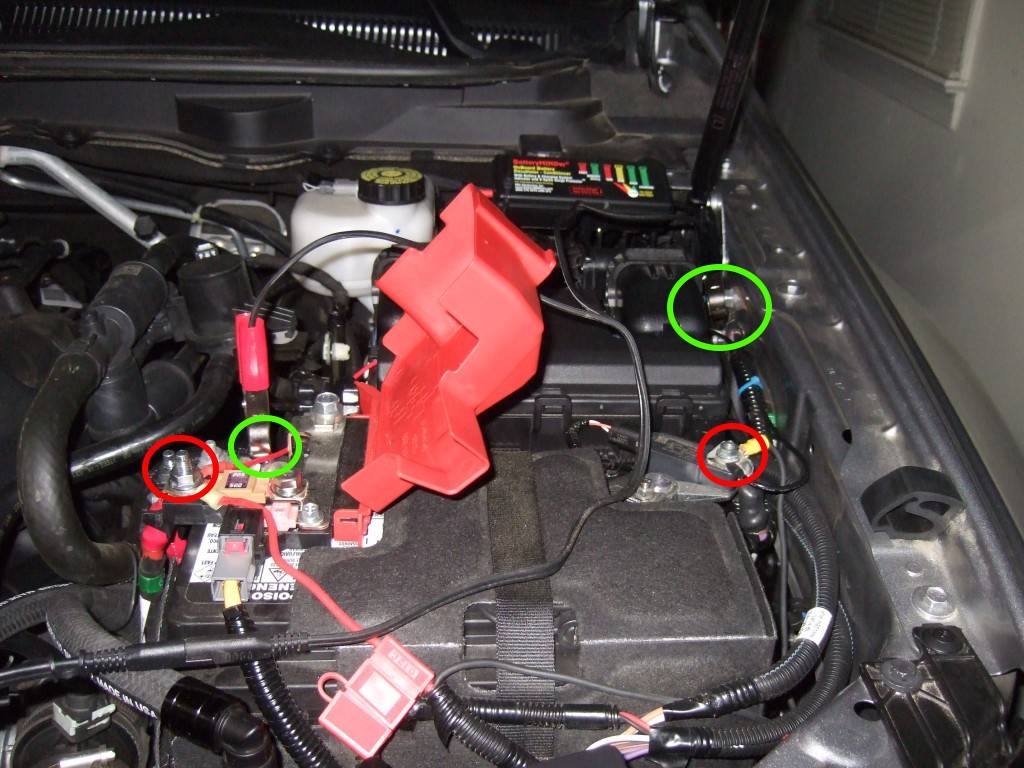

I have included a picture to show where I have the desulfator connected to the battery (Red Circles), and where I place the battery charger clamps (Green Circles). The green Neg connection point is the neg cable connection to the fender well.
  1. Is there a better place to make these connections?
  2. When testing the battery I use the same connection points as the battery charging points.
I welcome any suggestions from this forum.

Iirc - my test points are to the bolt head - to the right of your positive clamp - and my negative is directly to the post- if you test at the fender ground you are adding resistance of the negative cable to your test result
And since the positive post is a little difficult to get a good connection- due to slight recess - I hook up to the most direct point from it
I found that altering from this gives inaccurate results

Thanks for the assist. I just checked and found the same to be true.
