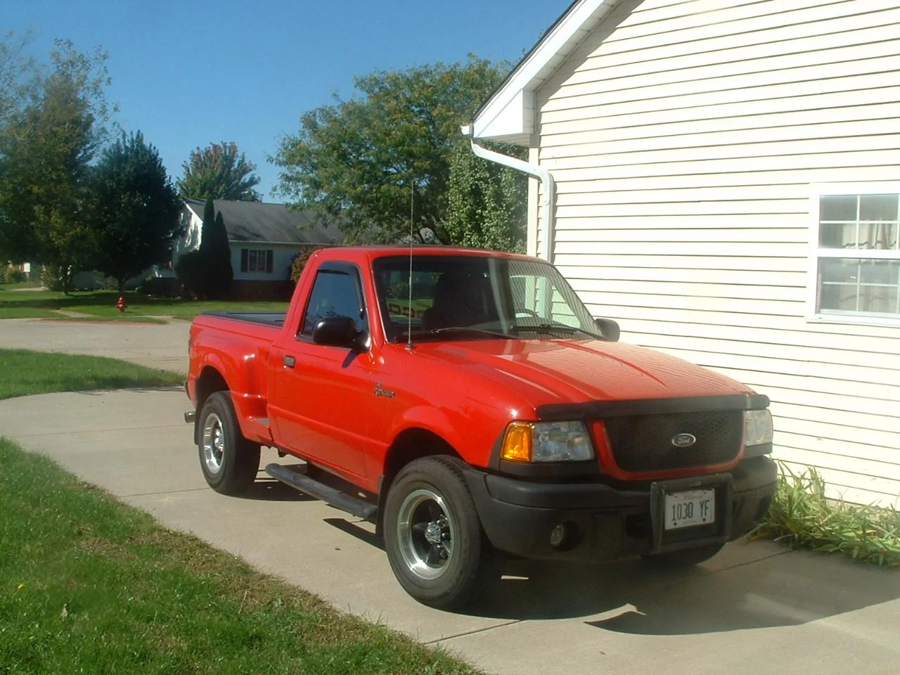

Well here it is.... Except for proper brake service...
( You'll just have to wait another 15 years to see my third Ranger which exceeds that record )

My old man had two rangers as well, and an F-100 and each one was probably the peak of vehicle reliability.

Perfect.. I love the look of this truck too.
