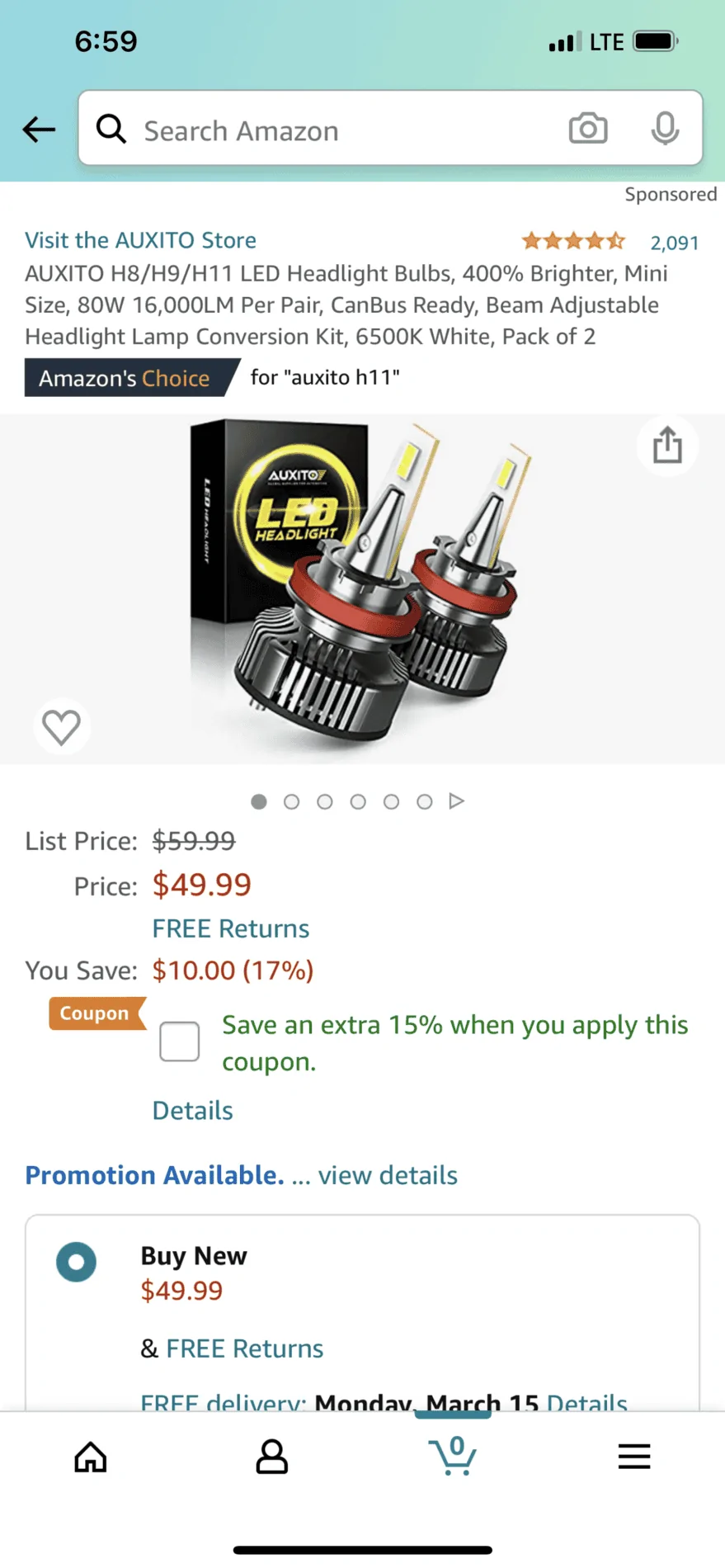

It is 8k per bulb. I think you will be very happy with Auxitos.
I just didn’t want to overpower the reflector and blind oncoming traffic, that was my primary concern with the y13 Auxitos for my lows.
The other thing is that I really don’t want to spend $142+tax & shipping for the GTR CSP minis. I had it pretty much narrowed down to those two. I think I’ll give the Auxitos a try for now and hope that I don’t piss off a lot of people. Thanks for your input, GitRDone.

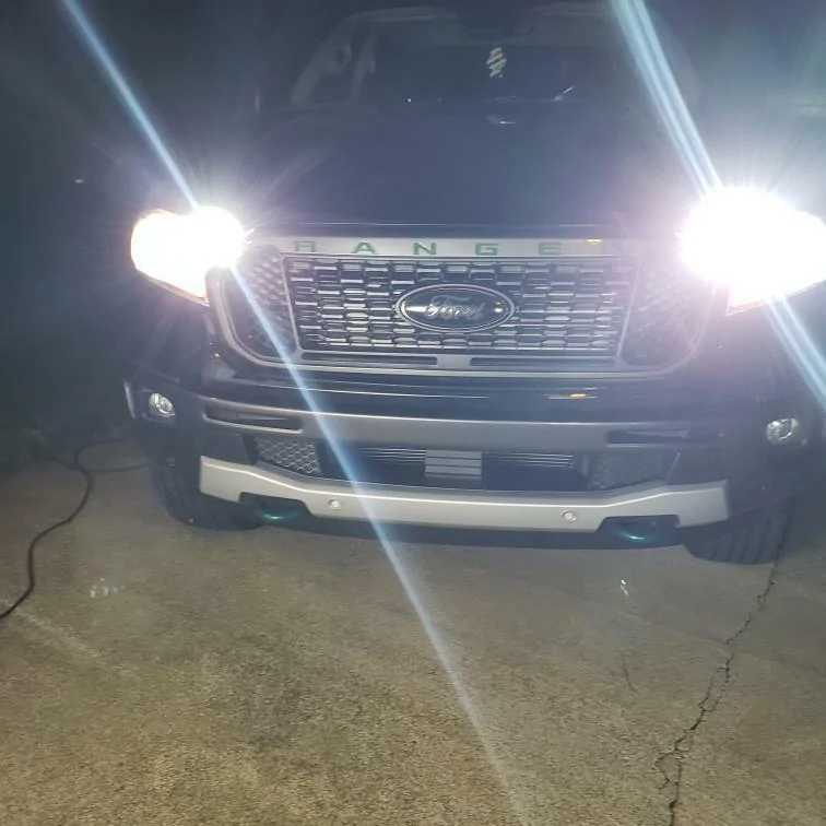

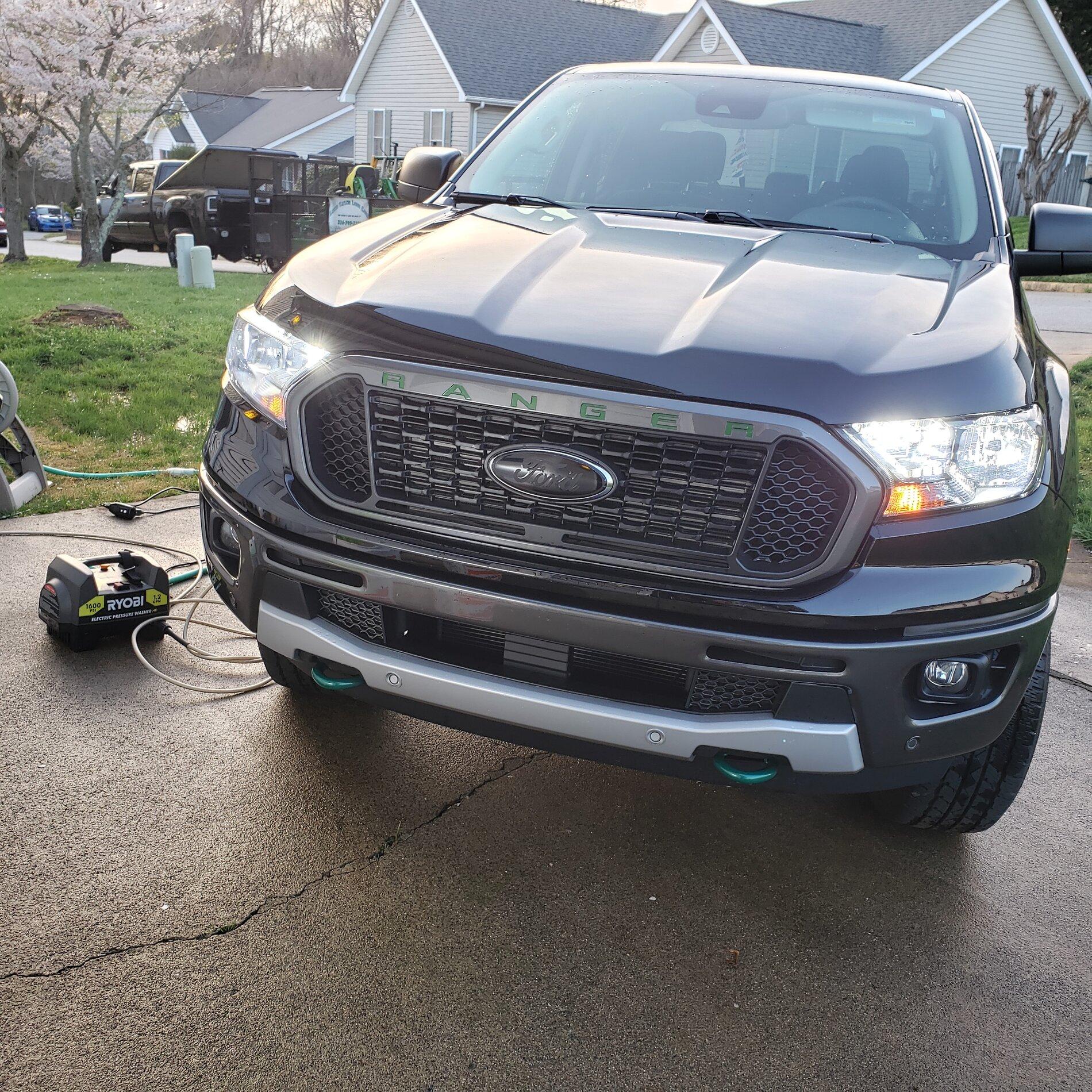

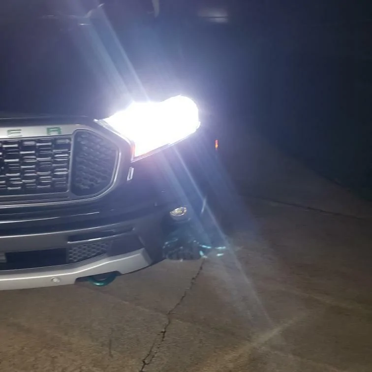

I just installed my Auxito high beams (they came two days early ?) and I couldn’t be more pleased. They installed at the perfect 3 & 9 positions without adjustment. Next will be the Auxito lows, that I will order later tonight. The only problem I had with the dust covers was getting them to align just right so I could seat them properly. The fitment of the bulbs are perfect. I want to give a HUGE thank you to everyone here in this thread for helping people like me make the correct decision about headlights.
