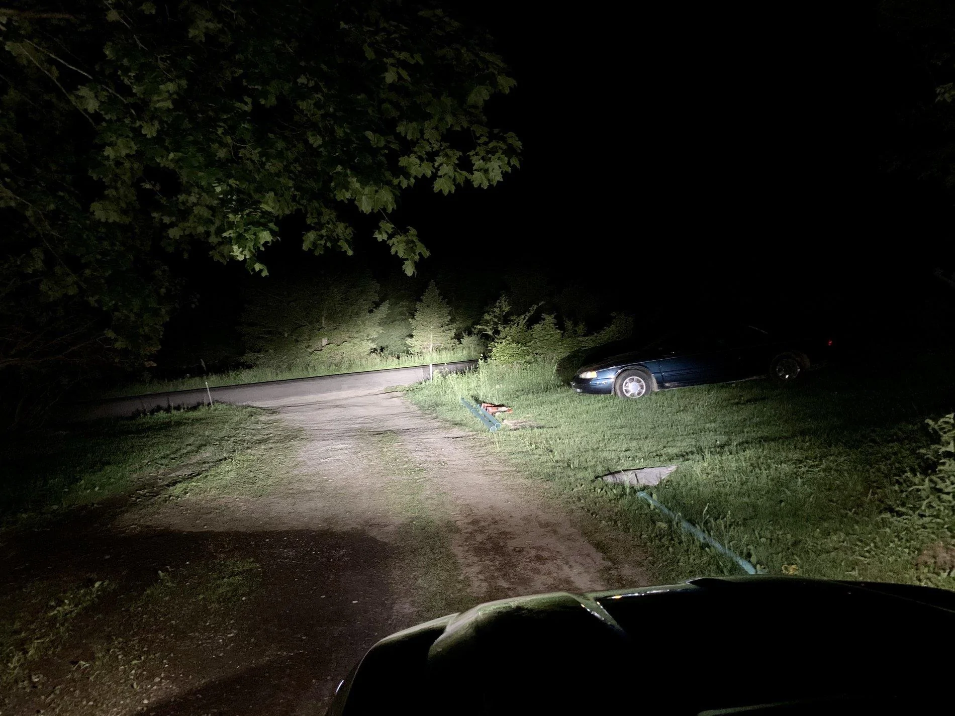

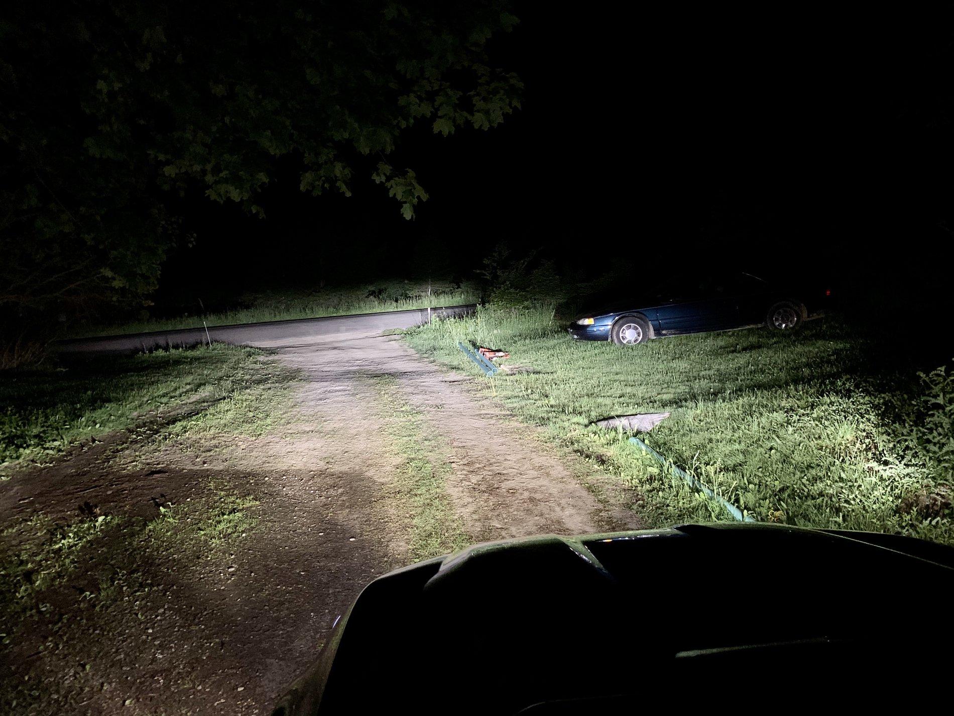

Mother of god. I’m loving these Auxitos. Fog lamps SUCKED but got them done with only a slight usage of colorful four letter words.
I can see the trees clearly behind the wheel past the end of the driveway 125’ or so out. Low and high beam can see them hard to bring it out in the photos.
Low beam
High beams
I gotta do some slight adjustments but I’m sold. Ordered these for my beater 02 frontier as well.

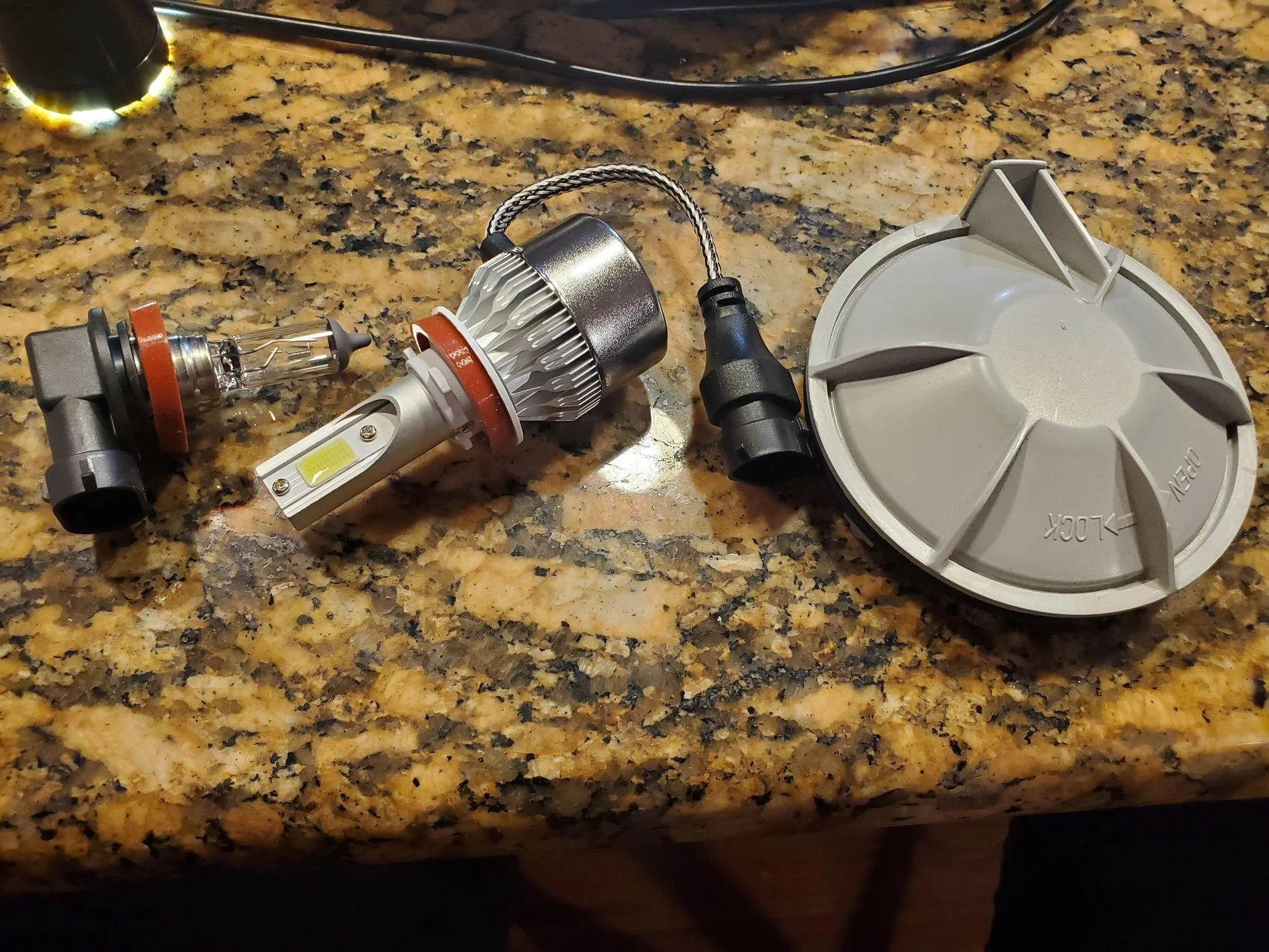

Hello everyone. I decided to be adventurous and buy some low budget led bulbs from ebay.
Question: how important is the round light bulb cover. The led bulbs worked but the fan sticks out and doesn't let the plastic grey cover fit.

That cover is what we call the "dust cover" and it helps to keep dust/debris/water out of the headlight enclosure and away from your bulbs. Since the bulbs have gaskets going into the actual housing itself, are you going to be alright without it? Most likely, if you don't do anything terribly taxing, off-roading, driving on dirt roads, lots of water or snow/ice and salty locations.
Personally I won't run without it, having had multiple different vehicles, none with a dust cover like this, I suspect there was a reason that Ford put this design in this way, as not including this kind of enclosure would've been a cost saving, surely.
Ultimately, YMMV, and many may have different opinions. I wouldn't run without it, but you're probably ok if you keep it off.

Thanks for the reply. I think I will look for some that fit. I'll use these for a while. I paid $9 total for the pair so I can't complain lol. I have a 2wd with 99% on road driving, but I agree with you. The cover is there for a reason.

I agree with the previous comments on the dust cover. Also looking at the pictures of your bulb, the LED chips look huge in comparison to the halogen filament. This will cause issues with focus which will give you a bad cutoff on low beam and get you flashed a lot.
The first posting in this thread has a good listing of bulbs that have been tested and shown to fit with the covers. I know 29 pages is a lot of reading but there is a lot of experience in this thread to draw on in making your decision on a LED bulb.
