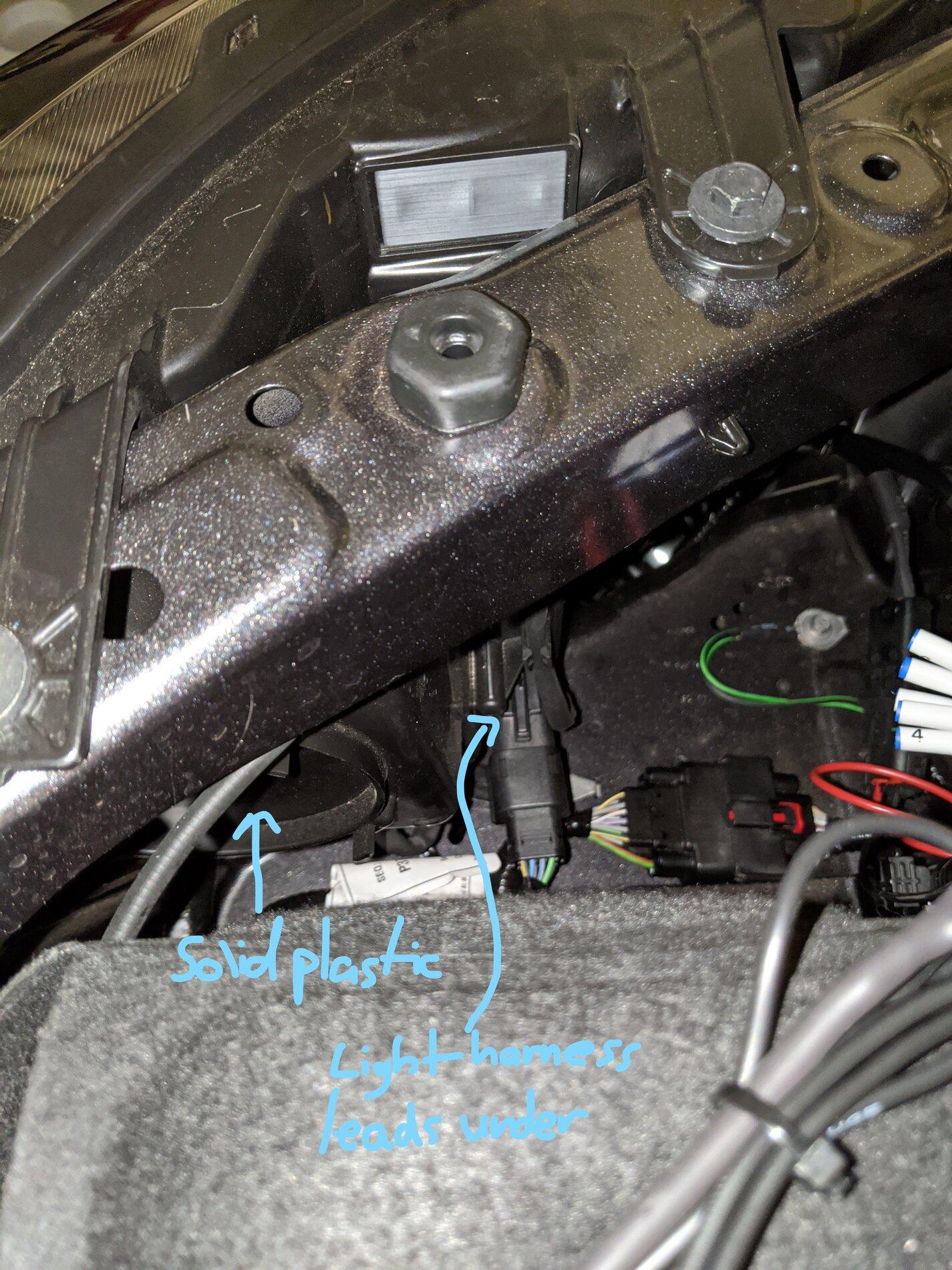

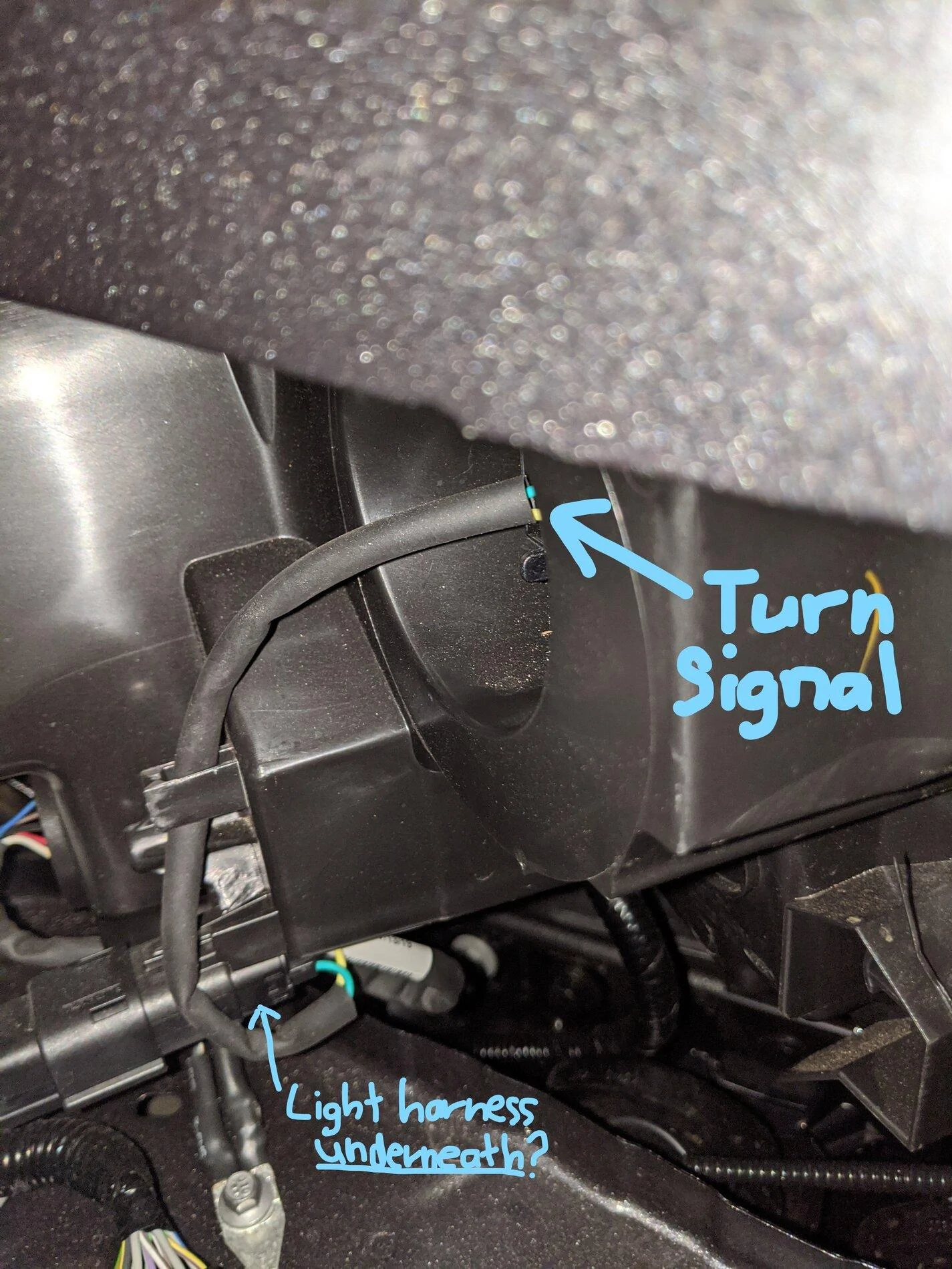

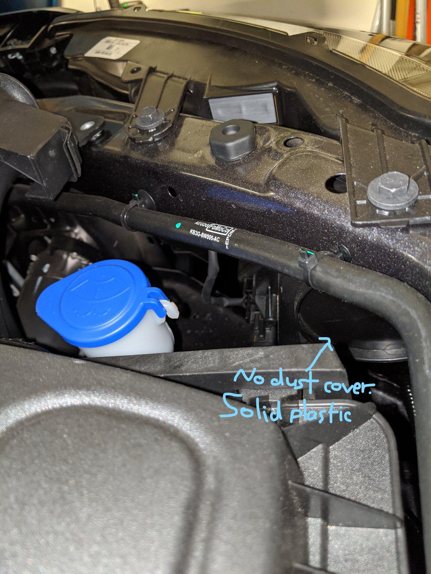

Newbie question here. I feel dumb almost even asking it.
I've got a 2020 Lariat and my headlights don't even appear to have the grey dust cover. As a result, I can't even find how to replace the bulbs because I can't find the back of them. Mine doesn't seem to operate anything like the pictures I'm seeing of everyone else's lights.
When I look at high and low beams, it almost look like the come from the same spot of the headlight. I almost feel like the connection is actually below where I'm seeing everyone else's bulbs. The spot where you all have a dust cover is just a completely filled in black plastic piece for me.
Am I just an idiot or do the Lariat's lights work way different than the other trims?

Yes, Lariats are different because they're LED headlight housings already, you don't have the same bulbs that other trims have to replace. Similar to how the rear housings are as well.

The Lariat head lights are full LED units. They are not serviceable. Theoretically the LEDs should last for the life of the truck.

Thanks for the confirmation!
And darn. I really wanted to increase their output a bit. The low beams are ok, but I feel like the high beams could definitely be brighter...

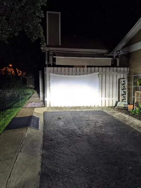

Okay here are some photos of my install.
Low Beams: GTR CSP Mini ($99 on sale)
High Beams: BEAMTECH 9005 Fanless ($37.99)
Fog Lights: BEAMTECH H11 Fanless ($37.99)
For the photographs, I measured 25 feet from the fence and parked with my front bumper at the 25 foot mark to try and simulate this test by Headlight Revolution.
Fog Lights Only:

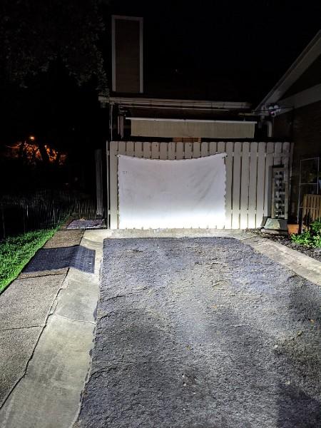

Low Beams and Fog Lights:

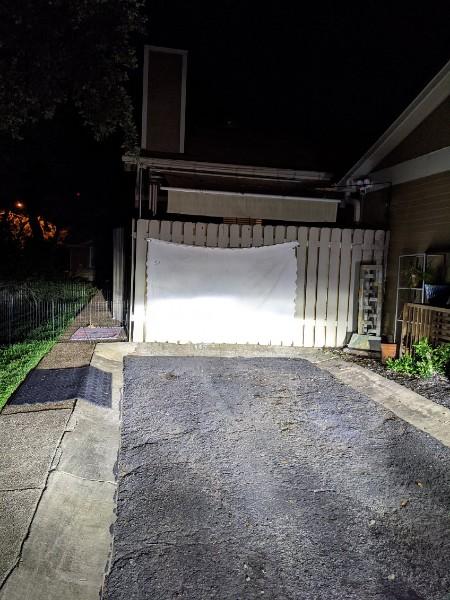

Low and High Beams:

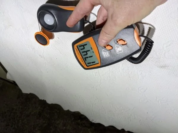

I was really struggling to get the max reading on camera . Trying to hold the two part meter and take a photo was a challenge. I did see readings in the 1790 range, but trying to photograph it was elusive. It really is a two person job with this meter.
Anyway the Maximum LUX is somewhere between 1750-1800 only a few lux below what Headlight Revolution got::
I have to adjust my low beams a bit to get them a bit more horizontal with the cut line, but all-in-all there isn't a lot of bleed over the top.
