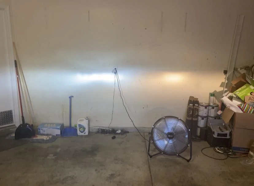

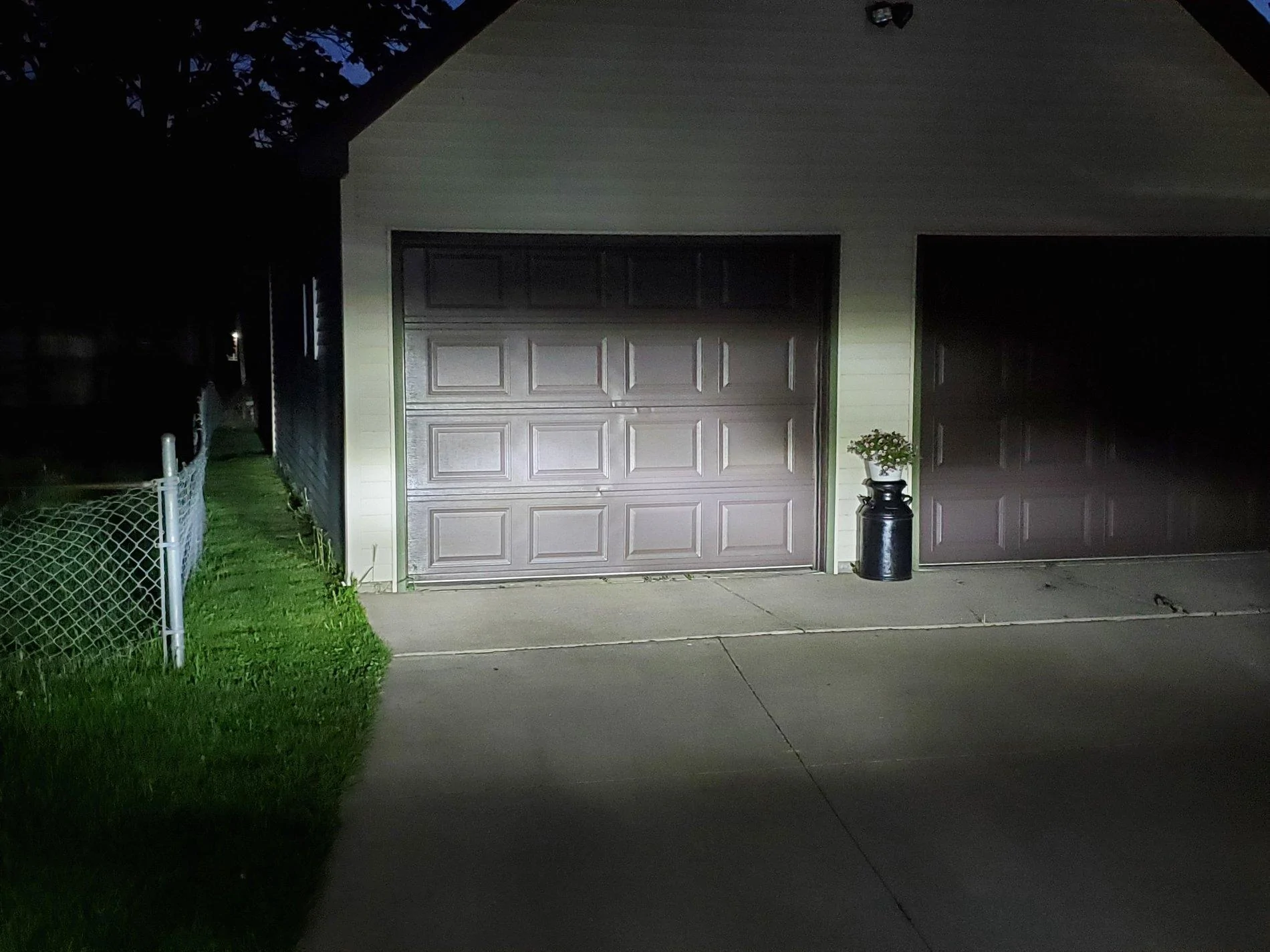

You will get more bleed over the top of the cutoff line than the halogen bulbs. The good news is that you can adjust these bulbs to mitigate the effect. You want to make sure that the LEDs are pointing horizontally and not vertically to get the best results. All-in-all the light leakage is very minimal with this bulb when paired with the ranger reflector.
You can see in my second picture that the driver side low beam bulb still needs a bit of adjustment. It's hard to see on the low beams how far off you are from horizontal because of the cap in front of the bulb.
Both the high beams and fogs were aligned perfectly right out of the box and don't really present an issue. In the first photo you can see that the fogs have a nice and tight beam pattern.

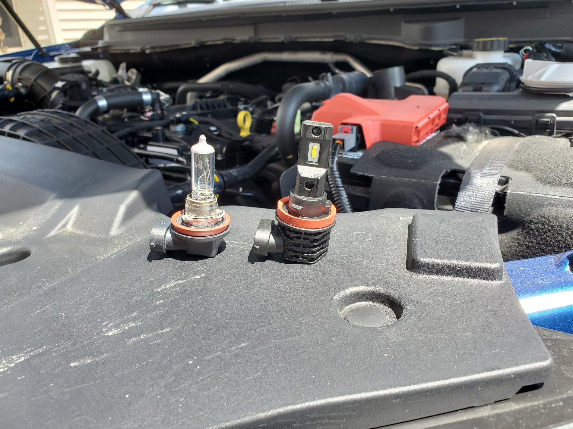

Just got the JDM Astar M1 bulbs for my low beams and fogs. Disappointed in that they are NOT adjustable as JDM's facebook post says and the pictures appear to show. I have a request into JDM on this. The box says they are 8000 lumens, JDM doesn't seem to like to post this info in any of it's liturature for some reason. Still waiting on the high beams, Amazon shipping is a bit slow yet.
No problems with install the longest time was to drop the skid plate to get at the fogs. (15mm socket loosen two bolts and remove two bolts. @deeve must just have a mean truck, my hands are are not tiny by any means and I got no cuts or scratches. Fogs clock in perfect low beams more like 2 and 8 and 10 and 4 one side each way. Will need to wait till dark to see how the cutoff looks. May need to send them back and look for something else depending on what JDM comes back with and how the cutoff looks. Stay tuned
Dust covers fit fine only issue was needed to unplug the passenger side bulb to get the OEM bulb out. connector hits the opening in housing when you rotate it. Same with new bulb install.

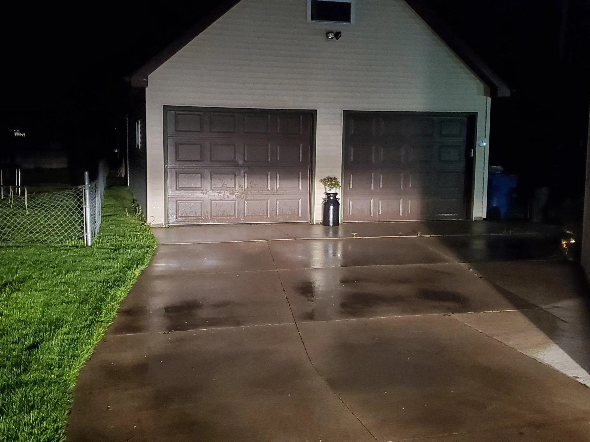

The new JDM high beams arrived today and got them installed. Install went well except getting the passenger side cover back on was a pain, literally! That washer fluid tank has a sharp lid on it.
The high beams clocked in perfect at 3 and 9 as did the fogs.

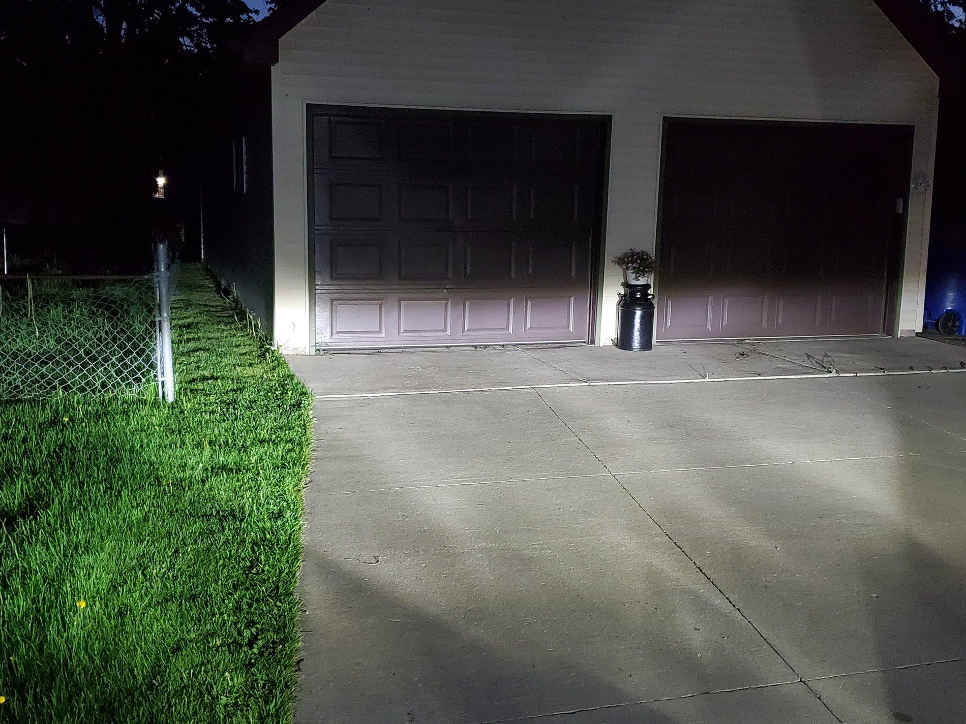

Had to adjust the passenger side low beam down and bring the driver side up a little to match the cutoff I had with the OEM halogens. See pictures below. I was pleasantly surprised at the quality of the cutoff considering the way the bulbs are clocked.
OEM Low Beam with Fogs
New Low Beam with Fogs

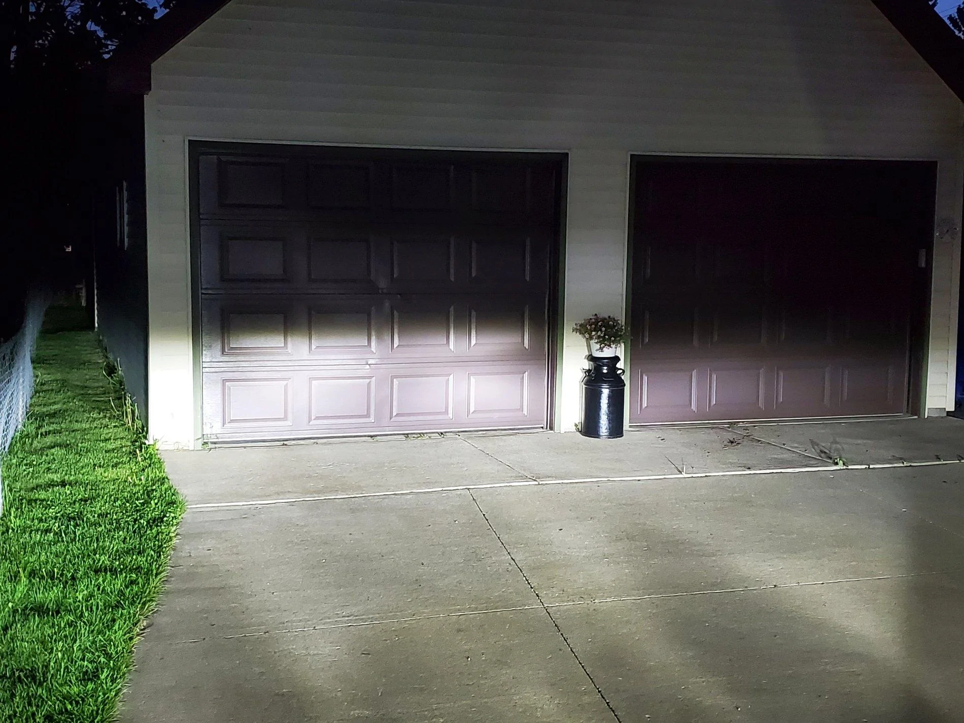

New Bulbs High Beam

I haven't heard anything back yet from JDM on the adjust-ability issue yet but I'm impressed with the way they are. May be a statement on the quality of the reflectors we have. Even though the pictures don't show it well they are much brighter and whiter that the OEM halogens.

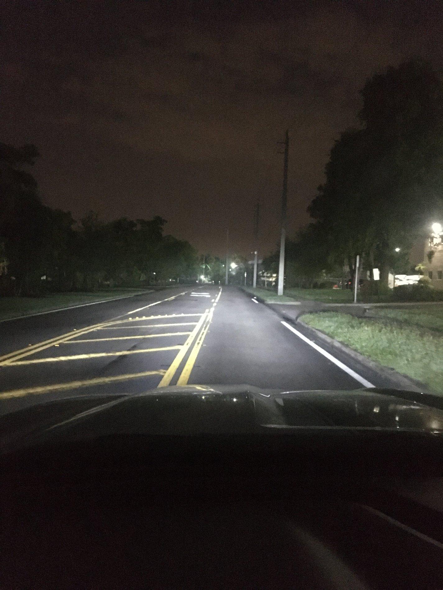

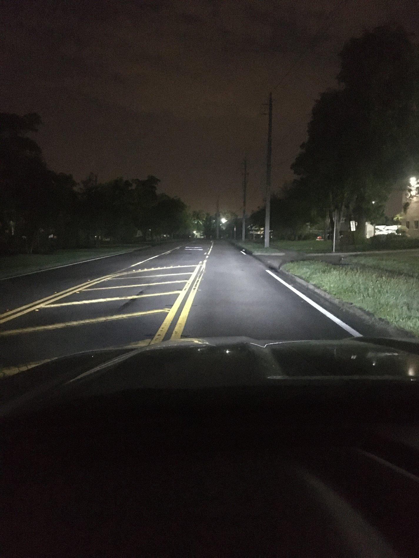

Im using 2019 - 2020 Ford Ranger Reflector Low Beam Headlight GTR Lighting CSP Mini LED Headlight Bulbs from Headlight Revolution and they work great! super bright and nice beam pattern. I did have to clock them when I was installing them to have that nice line/cut off like factory. But a definite thumbs up!
For my fogs, Im using the Diode Dynamics
Luxeon LED Fog Lamps. Its complete housing replacement. but 4 screws each side and you are done. I wish they where alittle brighter but the beam pattern is nice.

The light looks alot more blue in the pic. but it looks pretty white with a slight blue tint, but i count be happier with it.
