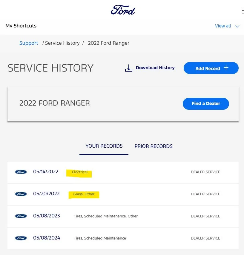

In my Ford.com account, when I go to Service History it shows two things that were odd to me and one is likely a TSB for the windshield.
The first one (electrical) was the day I picked it up and the tech had to show me and the salesman how to initiate the one-touch window.
The second one, Glass, Other, is the one that I have no idea about. I've never asked them, but kind of assumed it was my windshield or that they put in for fraudulent reimbursement.
Maybe see if you have something listed in yours under your account > vehicle dashboard > maintenance > maintenance records
Btw, I've never been able to upload my self-service with "Add Record", I can enter stuff into the fields it shows but it can't save and throws an error.
