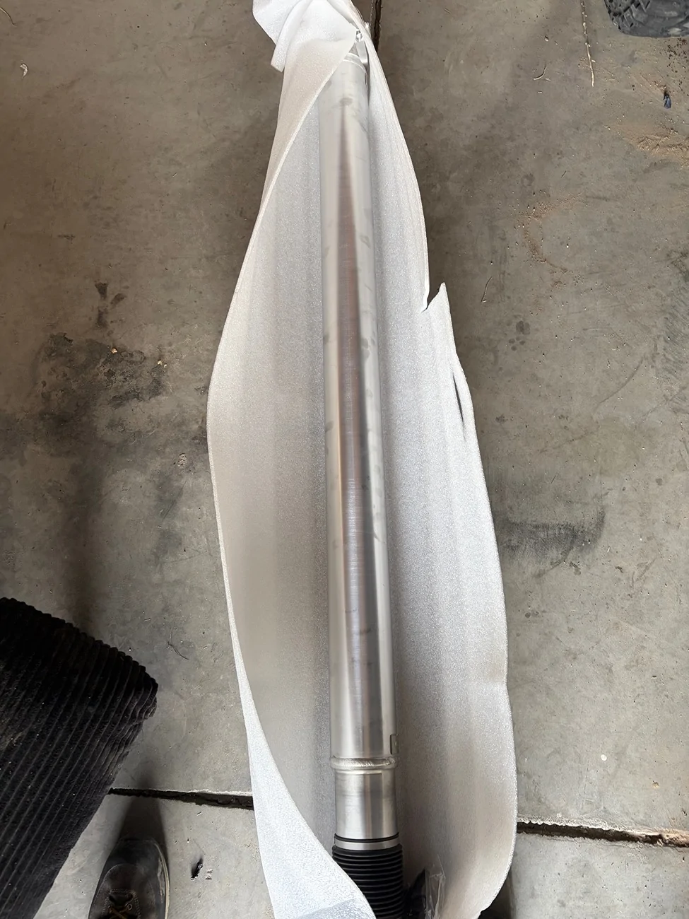

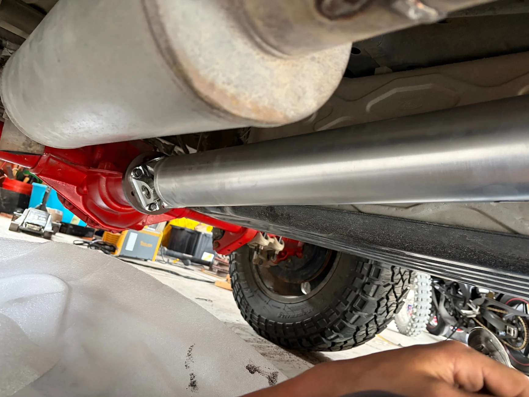

It looks nice! Any driving improvements? Smoother, faster acceleration as claimed on their website? Mpg boost due to less mass and drag from an extra u joint?
Haven’t driven it enough to say for mileage and what not I’m sure that will be very minimal, and of all the drive shafts I’ve done I never really notice much in acceleration other than the slight slop you get from a carrier bearing so from what I know with other vehicles and can feel with this one I’d say not really faster just a smoother experience

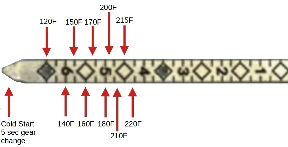

Two steps you should perform before investing in the driveshaft.
Step 1: Have you checked your transmission fluid levels? If not, invest in the FitzStick and check the level.
You can do it very easily when cold. Insure truck has sat on a flat surface overnight. Start engine, run up and down the shift gears at 5 second intervals Park to Sport and back to Park. IMMEDIATELY check the fluid level on your Fitzstick. It should be just touching the tip at 1/8". 1/4" is pushing the upper limit. If you are not seeing fluid, you're transmission fluid level is low.

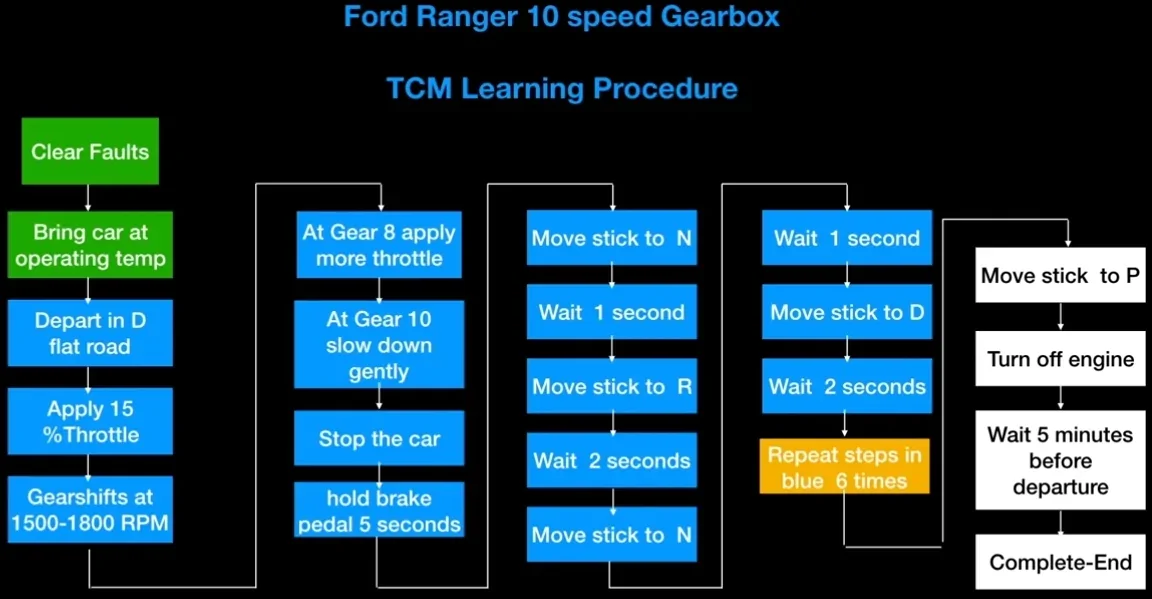

Step 2: Have you tried running the TCM Learning Procedure? Each time I change the fluid I perform the procedure. It might be good to do annually just to reset things that may drift over time.
The idea is to shift gently with minimal engine RPM on a flat road. Target shift to occur at 1500-1800 RPMs for gears 1-7. Gears 8-10 require a little more throttle to reach shift points. Repeat the blue steps 6 times. You'll be amazed how much smoother the transmission behaves afterwards.
