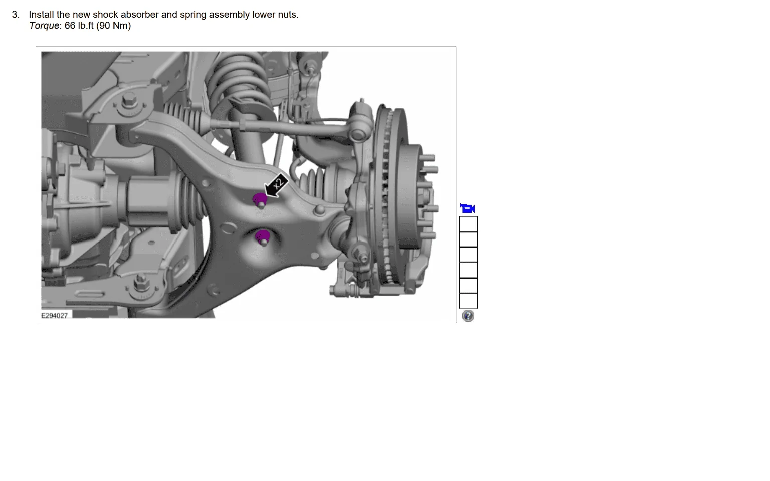

Are you referring to this below?
I did notice that they list some torque values as inch pounds (lbs.in) instead of ft-lbs. I couldn't find anything with the 407 number though.
