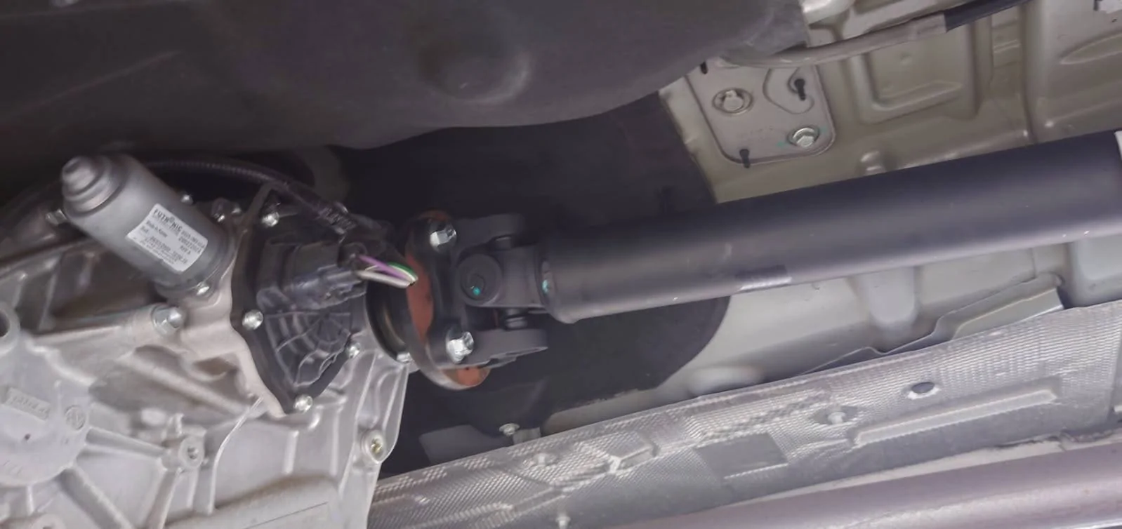

I bring news to the Tremors that have been left out of the solid drive shafts. I was able to take mine in to Tom Woods and get a Tremor adapter prototyped. I must say it was a success and I finally solved that God damn shake and squeak at acceleration. I didn't really want to F around with a carrier drop, and this solved it. After I let them know the adapter has worked great, I expect they will have then on the market shortly!

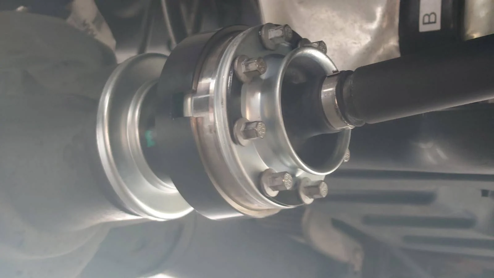

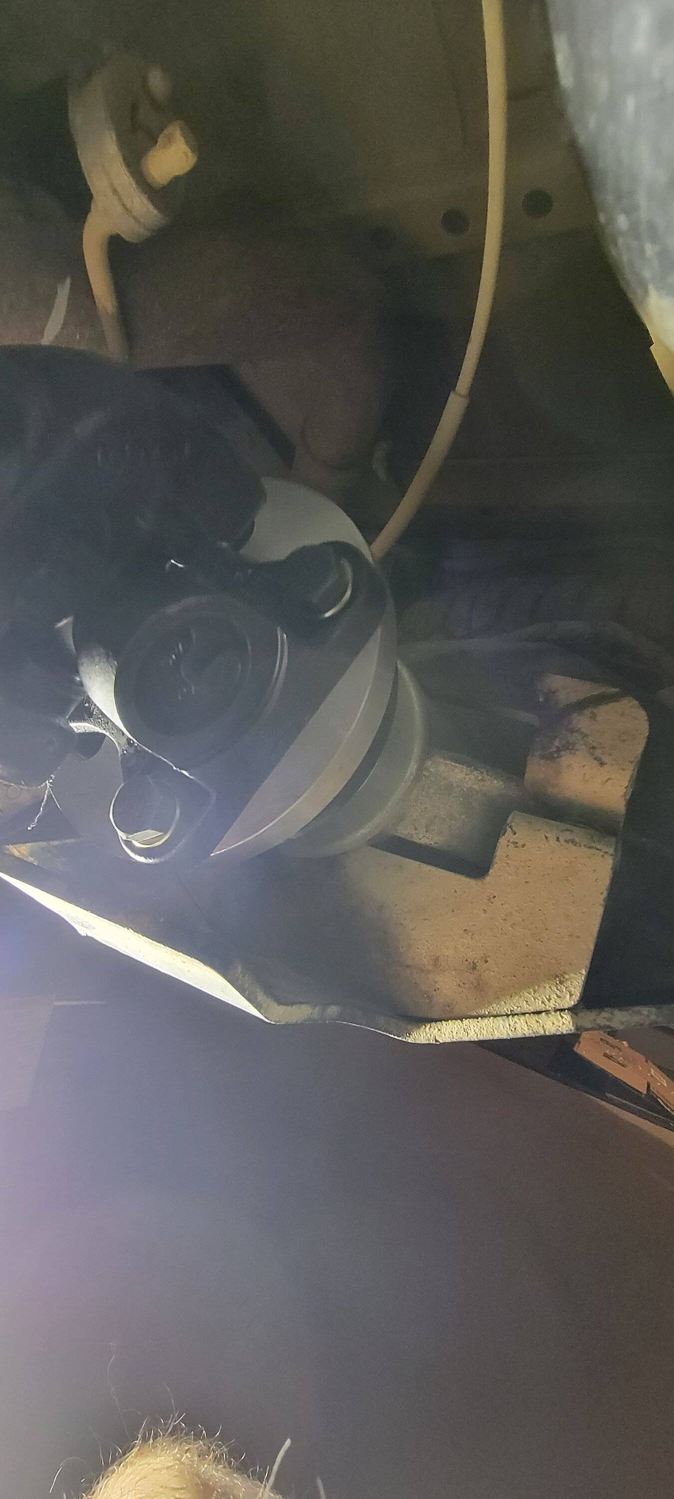

So I have a 2020 XLT (Non Tremor) this is what mine was replaced with today under warranty.
If this is what Tremors have, then I guess I am upgrading the hard way. I am still considering a single shaft, my tech suggested it too.
To add: The part number for the flange is MB3Z*4851*L.

Yes that is the tremor joint.. My drive shaft was fine until I had to change the carrier bearing, that really seems to be the true issue. I need to see if I can track down a bearing for that original carrier bearing and try that. that being said did they replace the drive shaft as well or just swap pout the pinion flange and add the tremor joint? I would love to swap over to a one piece Drive shaft I hope they finish this conversion soon if not I will buy the other standard flange and buy the one piece driveshaft for a non tremor.
