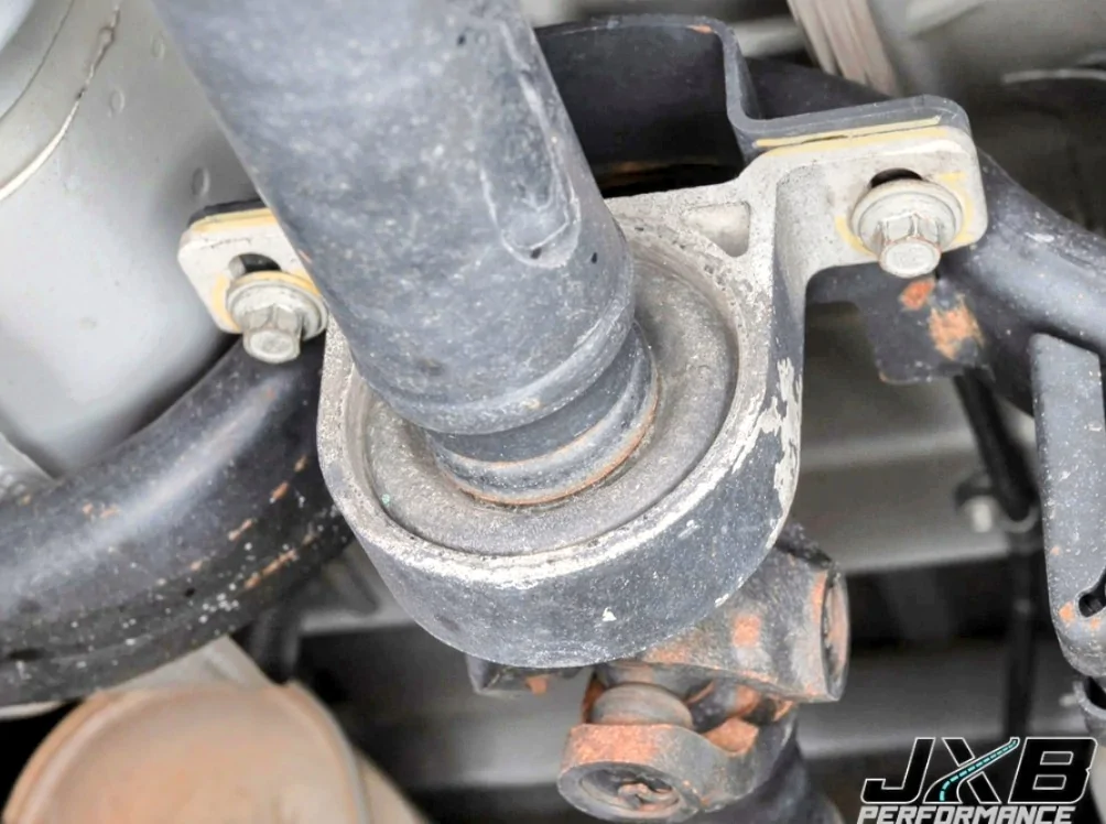

They show the factory bearing support (solid mounted)

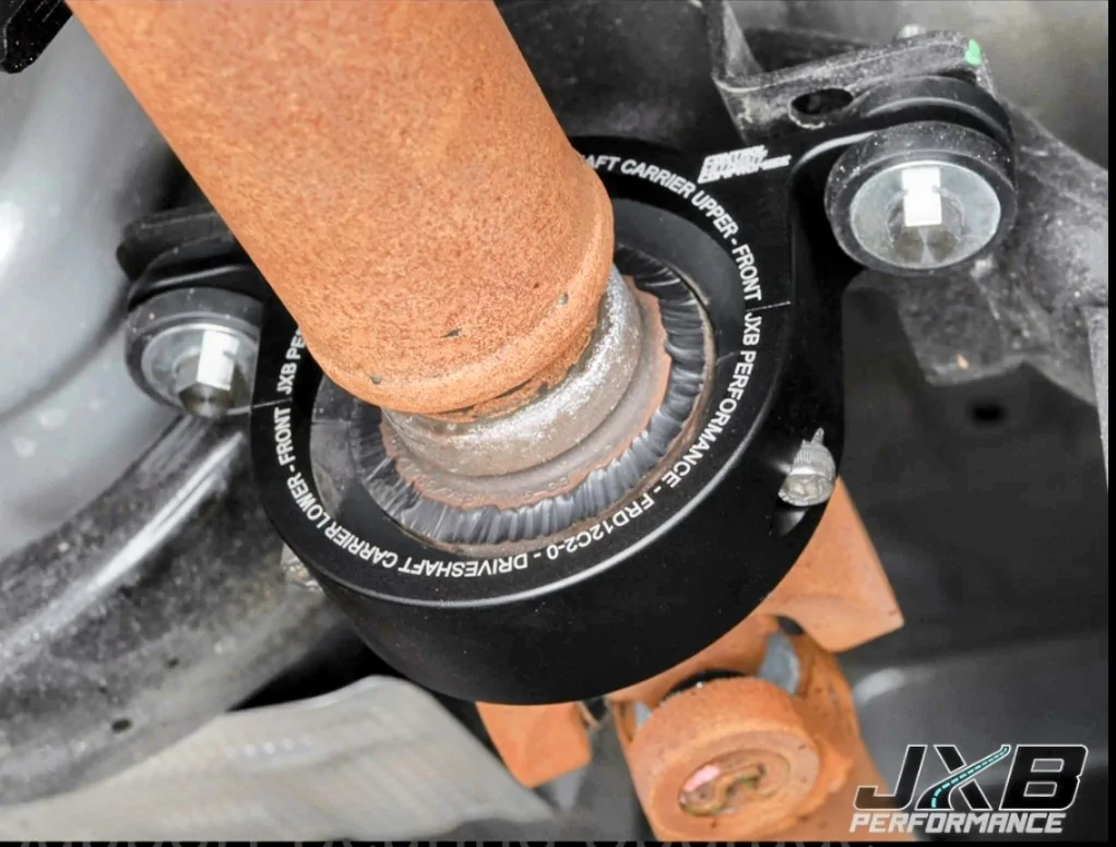

Then the cool custom version using the existing bearing and bushing isolated from the frame.
Your mechanic might be impressed if they are looking 😉
(What's up with the surface rust?)
