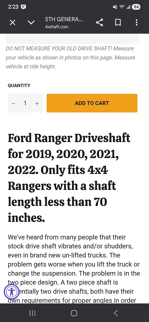

I'm 2wd so I had no choice. Still not sure why nobody makes a one piece for the 2wd. When I saw the JXB I figured it was better than nothing. Overall I'm happy with the results, Way better than stock.
What do you mean? The Tom Woods is for two and 4 wheel drive Rangers.

21 Ranger
Im guessing the 2wd is somewhat longer and they may shy away from it, but , they ask for a "flange to flange " measurement anyway so I would measure and ask them...
True. I'm assuming since there is no transfer case it will be longer than 70' but I never checked. The wording is a bit vague.
