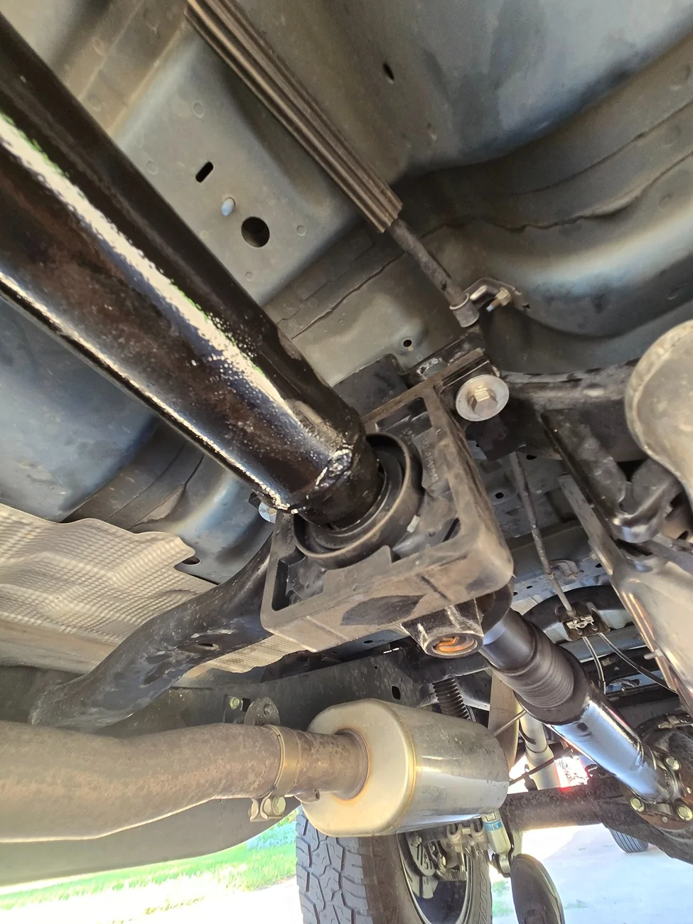

A little 3 month update on the JXB carrier. The driveshaft shop I went too didn't like the clam shell design and ultimately didn't want to try and balance it without using parts they trust which I understand.
Granted there were a few outside factors, one being the driveshaft wasn't very straight and two being the bearing was going out.
New u joints, carrier assembly, straightened, and balanced. Drives like new!
They machined the area a bit wider where the carrier assembly goes on so it now uses a more standard size that's common on Toyotas.

Just a question. How much did this total rebuild and balance of your driveshaft plus modification of your center support bearing with "Toyota" parts cost you? Was it cheaper than a one-piece driveshaft, that we know eliminates the issue.
Parts and labor for everything and removal/install on the truck $500 out the door. I know what you're going to say, should've bought a 1 piece. My trucks a 2wd and nobody makes one for it, too long.

I will also add they didn't charge any for their little "modification". Dana/Spicer makes Toyota shafts as well, he showed me a Toyota shaft right next to mine, identical minus a few mm's of material. Their assumption was since it was the same that the carriers would be the same, but ford had to make theirs just a tad different.
