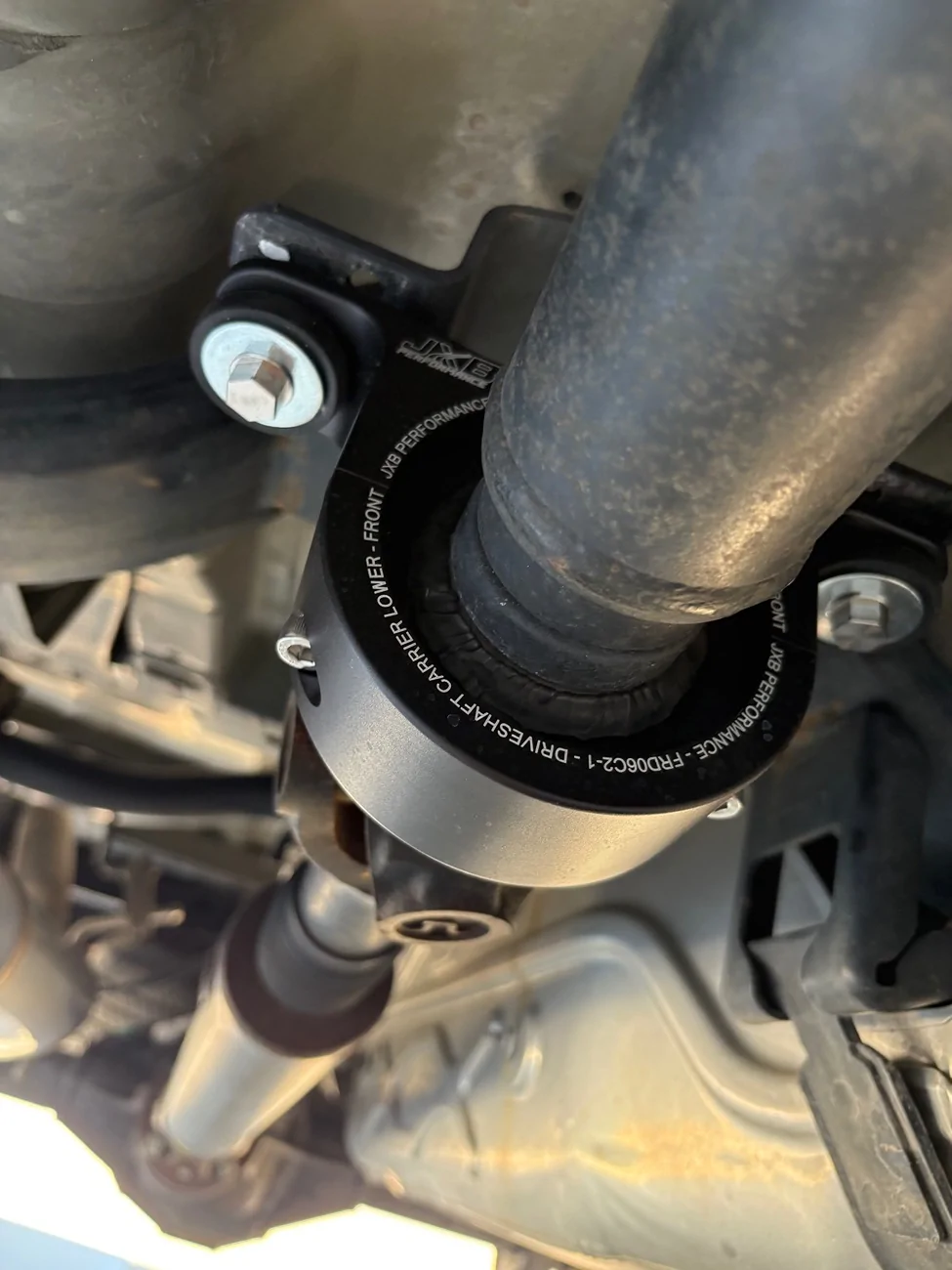

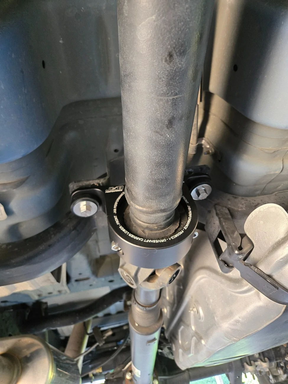

Also , here’s some pictures of my installation. If you contact them they will send you comfort bushings and a spacer kit for free. If they don’t have the full contact 2 piece comfort bushing yet ask for 3 of the original design and cut them to make 360 degree contact. I used a combination of their spacers and an assortment of thin fender washers I had to get mine dialed in.
