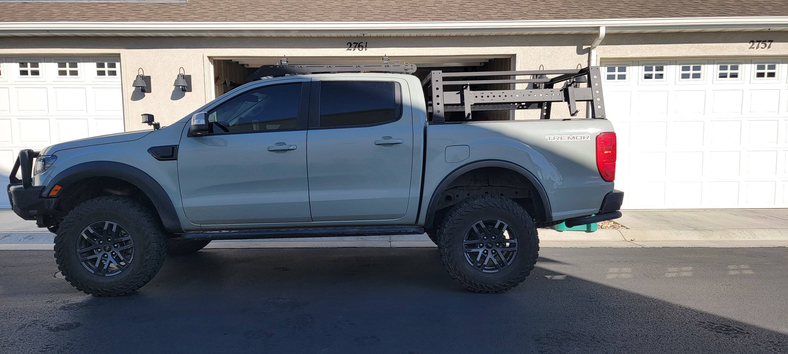

off topic but umm sir where is your rear fender flare lol
also love the tremor worm on the oem decal haha
I was wondering the same thing Jacob…as I was admiring those bumpers and matching spare. Maybe the rear flares interfered with the sliders?

it shouldnt i got a buddy with those flares so unsure why he would have the fronts and not the rear since it doesnt match now lol

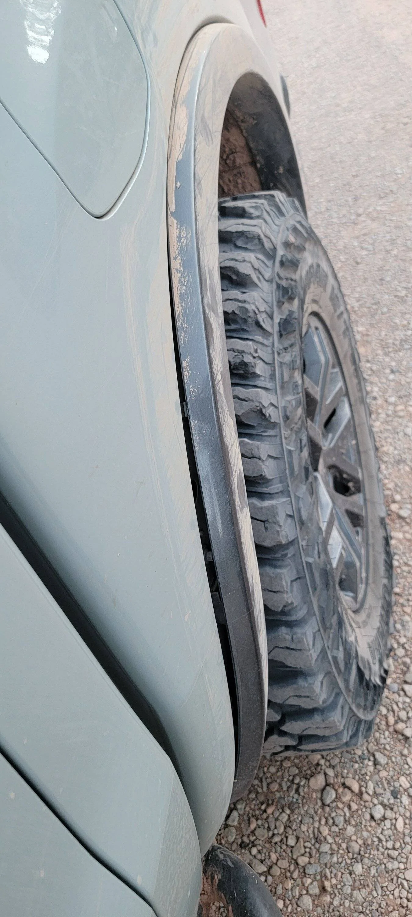

Lol yeah so, that one got torn off on Elephant Hill down in southern Utah when my axle was at full flex the tire grabbed it. It looks bad right now because I have the other side rear still. The fender is ok, I just need more rubber liner for it before it goes back on.

ah that explains it lol thats a bummer it took it off but good it didnt cause more damage at least!
