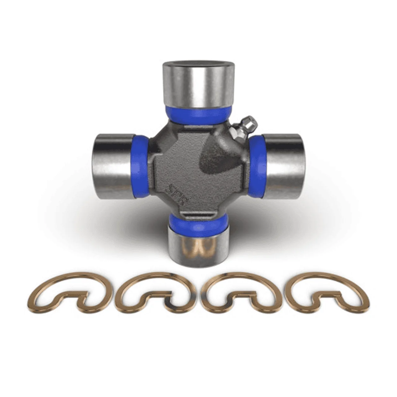

for those interested dana / spicer does make some upgraded parts that are direct fit for our trucks. this u joint has a much longer life cycle than the stock and is grease-able. less than 30 bucks.
Spicer 5135X
