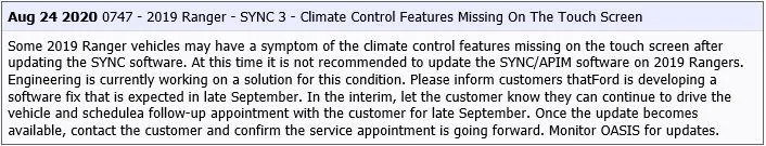

Good luck. 1) bring rude doesn't solve anything. 2) I've been dealing with my local dealer about this for 2 months. They can't do anything until Ford engineering releases a fix. The asbuilt data for our trucks indicates that we shouldn't have the climate screen, which is wrong, and the new sync update reads that properly now so the controls are gone. It's on corporate to fix and the dealer is just as much at their mercy as I am.

To be correct, it isn't code that you are changing with FORScan - it is configuration. The actual code is locked away. Not to say you can't cause trouble by changing configuration - but it is easy to revert to a known good state as long as you take a backup of your config before you make any changes. If the change doesn't work, you just restore the last known good config and it is like you didn't change anything. As long as you take backups before making changes, FORScan is really pretty safe.

Not to mention in this case ( the missing climate controls ) it's just checking a box next to that listing that says "enable".
