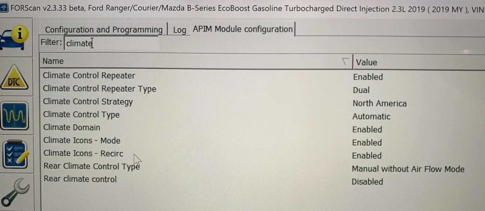

So wait, if you did the update and lost climate controls can you fix it with Forscan?? I have used it in the past to make some modifications already.
I lost the climate controls with the update, what can I edit on forscan to restore them?

Actually three things need to be enabled...
Climate Domain​
Climate Icons - Mode​
Climate Icons - Recirc​
Here's a screen shot of my Climate Config (the list was filtered - climate)
Done and super easy! Thanks.

FYI, technically the only one you'd need to switch is Climate Domain to get the screen back.
