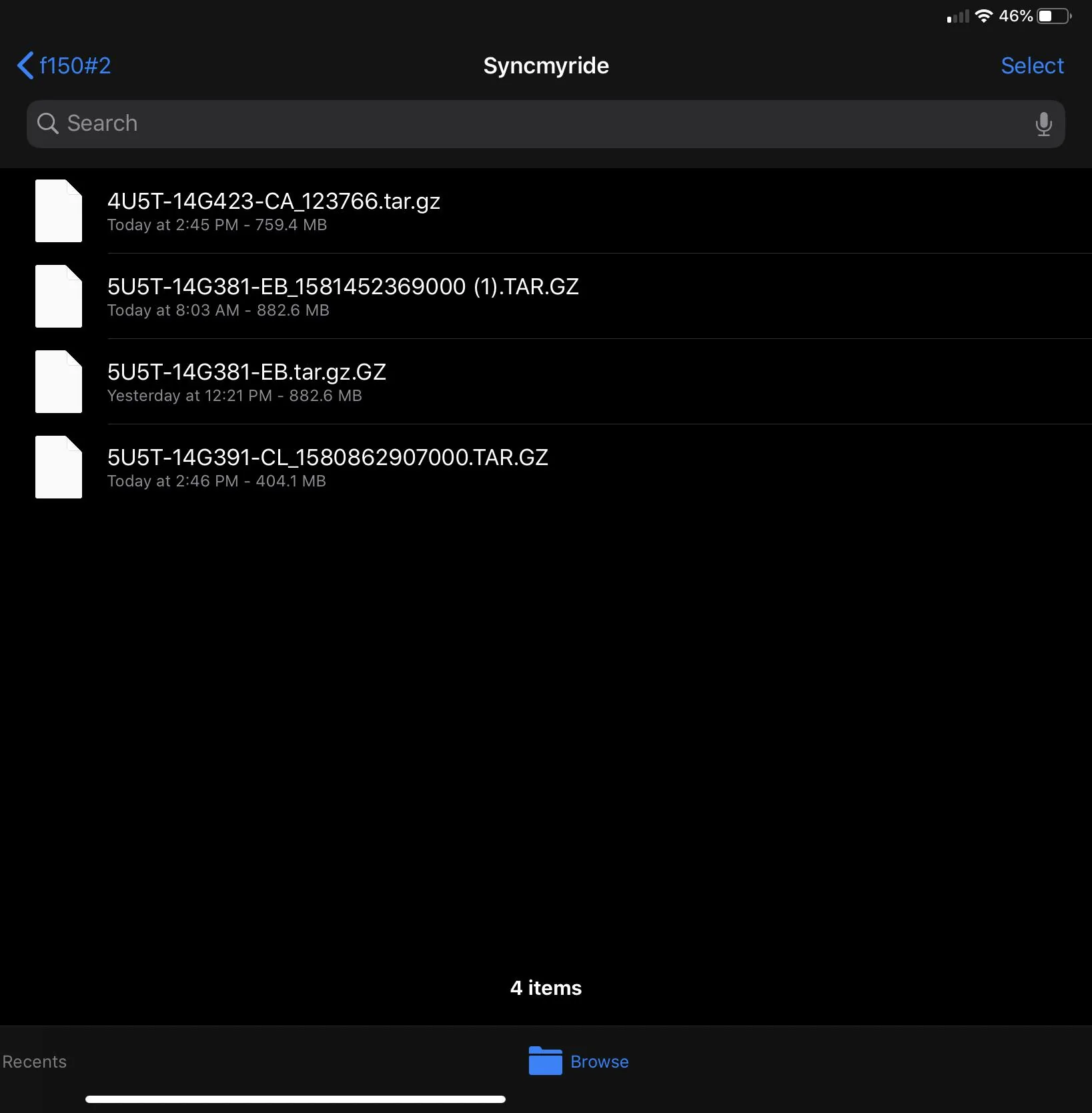

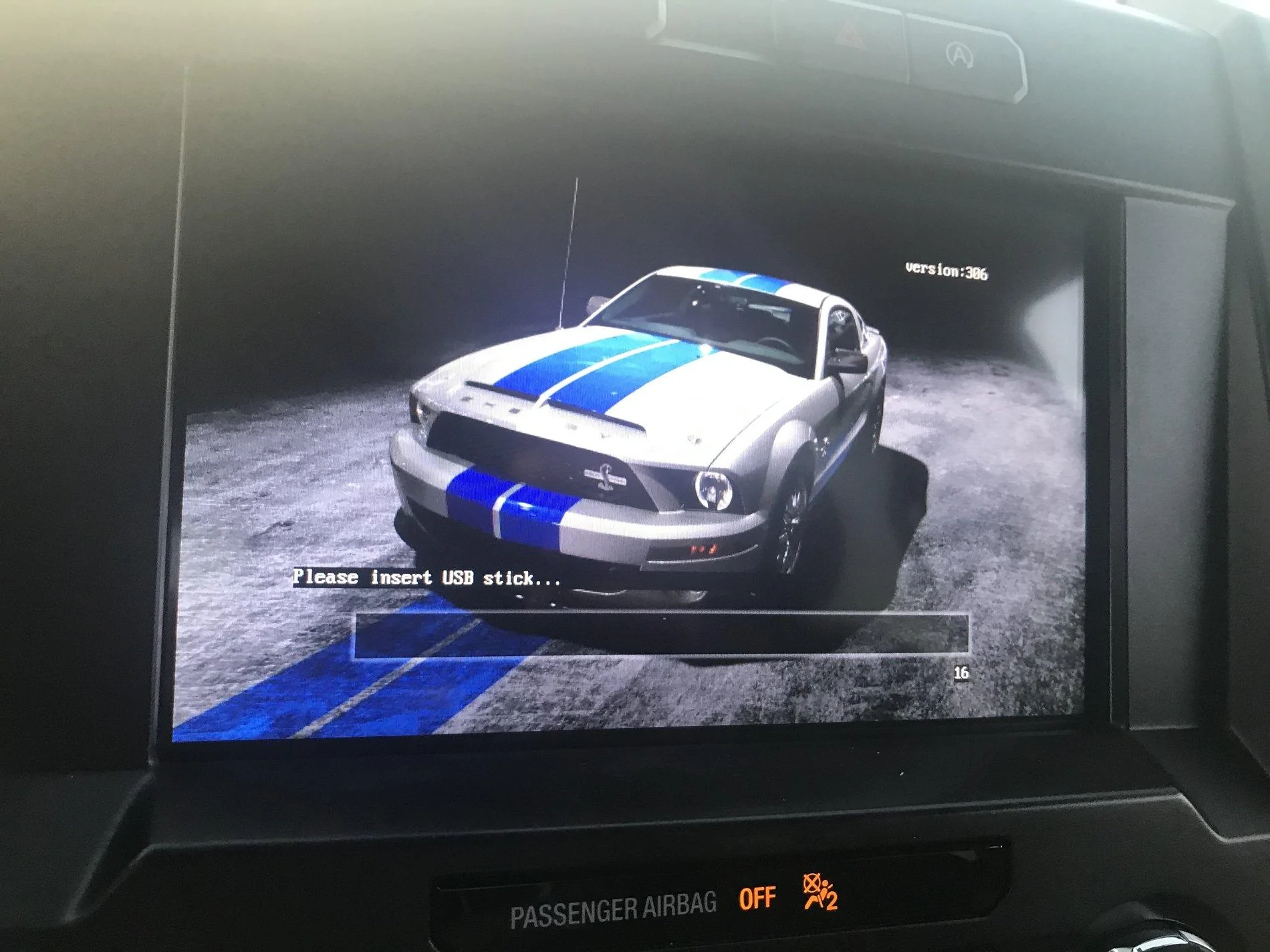

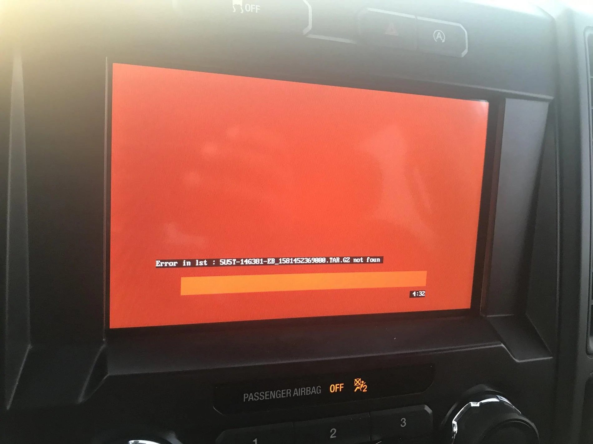

Can someone help me or give me some tips to how to fix this problem..I have a 2018 f150 trying to install sync 3.4 . I did the 1st part with my flash drive . When I install my 2nd 1 I keep getting (5u5t-14g381-eb-1581452369000 not found) error...I have it on my flash. Do I suppose to zip it or leave it in my (syncMyRide) folder... my screen suck on the insert usb stick screen

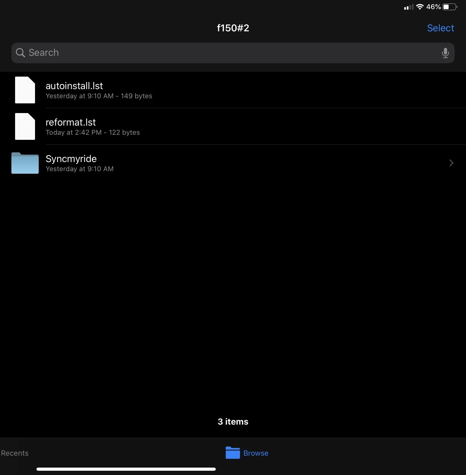

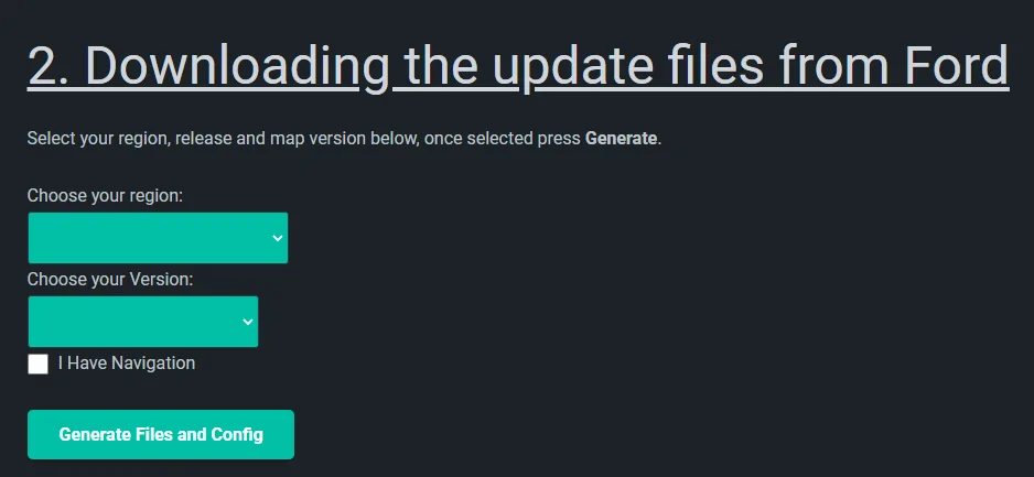

You are missing a file it would seem, did you use the windows application? there is a manual version if you aren't a windows user on my website also
https://cyanlabs.net/tutorials/update-ford-sync-3-2-2-3-0-to-version-3-4-all-years-3-4-19200/
you must download all files it tells you to and put them all in SyncMyRide folder and then copy the text contents to a reformat.lst
This is my setup. I did it from that site with the manual version ... it was 3 files when I did the version with no nav.
